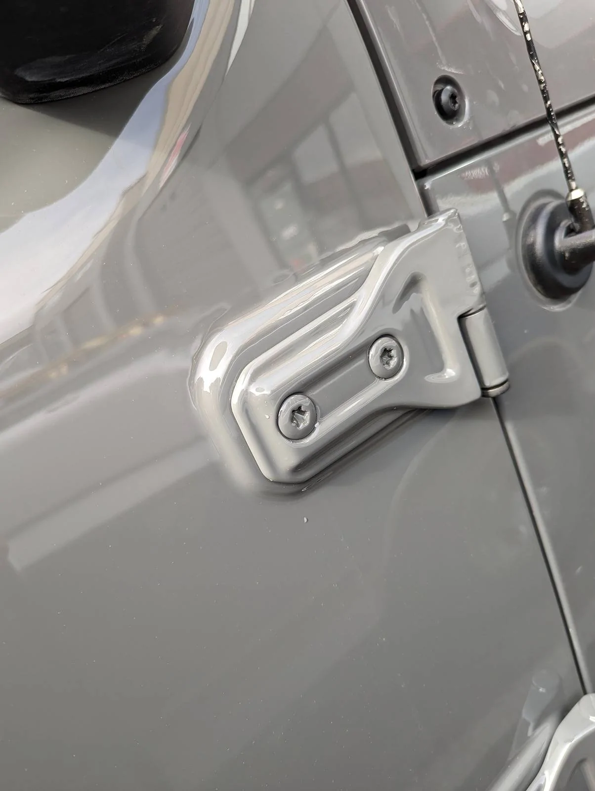

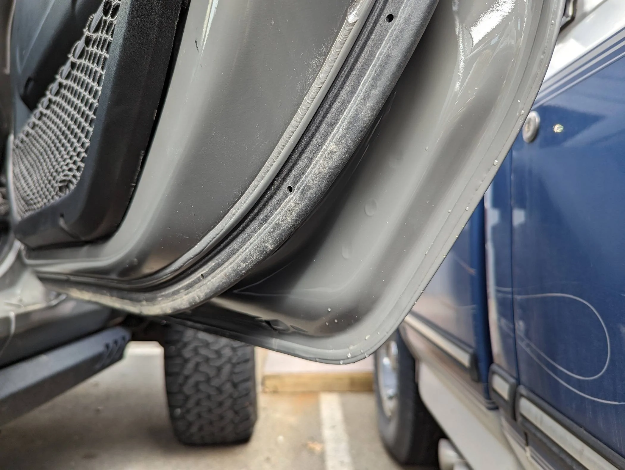

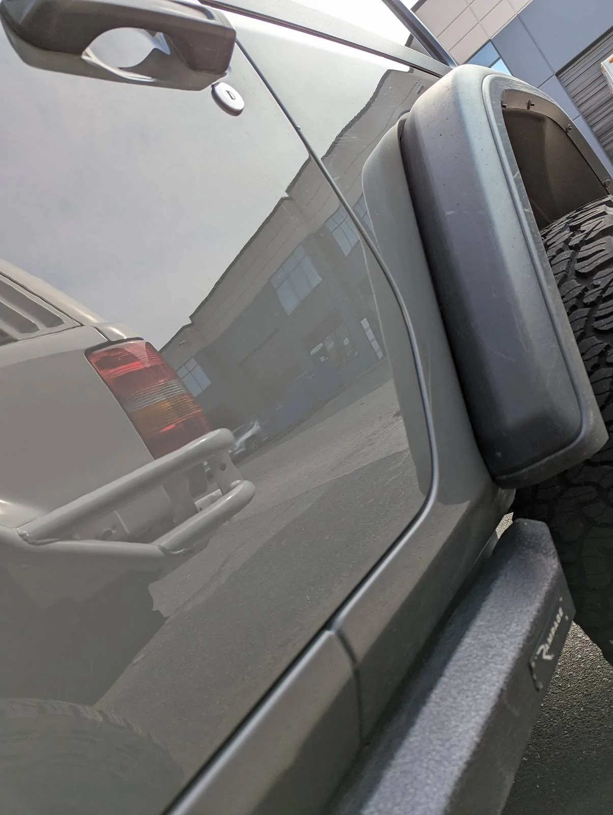

Just picked up my Wrangler back from the bodyshop this morning for the two doors and windshield frame. They replaced two of the hinges but other than that repaired everything else with a lifetime warranty on the repair from the bodyshop. Estimate came up to $4100. They did not blend, only panel painted, not exact match but not offensive, I'm ok with it. It matches the hood I painted several months ago. Cost me 200$ deductible to replace my cracked windshield at the same time to do for proper paint coverage
Thanks for the pics! I think these are pointing to the source of a problem I have since getting my doors replaced. I've been feeling a breeze at times while driving and wondering where its coming from. I think the dealer forgot to put the seam sealer caulk stuff on the weatherstripping pieces. Unfortunately, all doors were replaced so I didn't have a reference point for the source of the leak but I did notice that there were gaps which that sealer in your pics fills.
