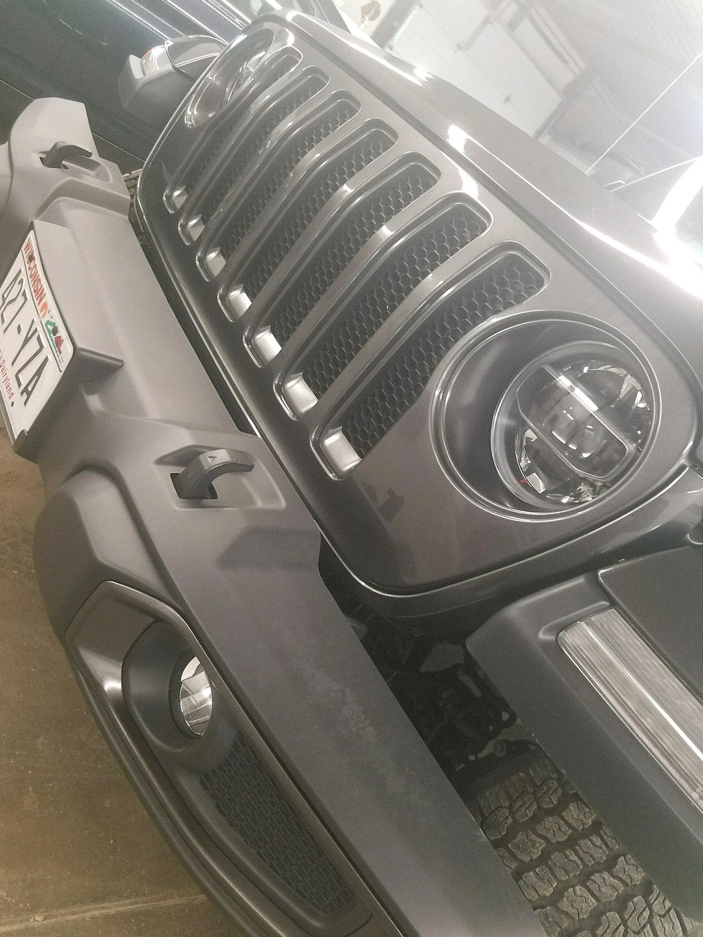

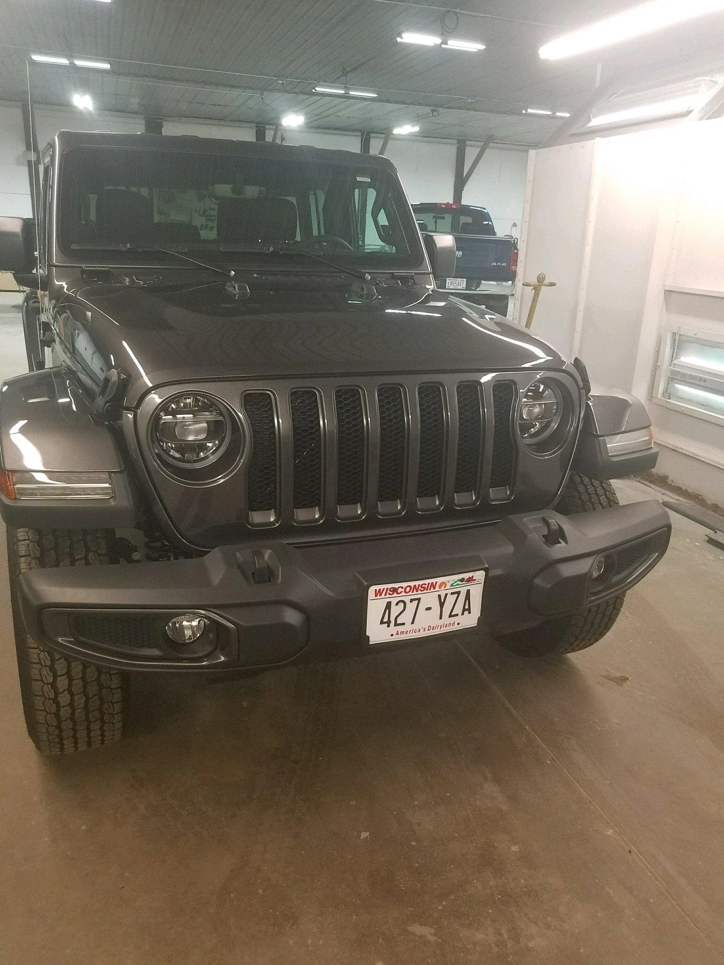

I had mine professionally painted to match the Rubicon. Hated the silver.
Did the shop use a "graphite" color on the inserts? It looks like there's a subtle color difference but I can't tell for sure from the pics. I too wanted to match the Rubi inserts, or do a matte black.

There is a slight difference- it’s a little more flat- it’s the exact same color as the Rubicon, we were able to pull the paint code off the replacement inserts that come unpainted

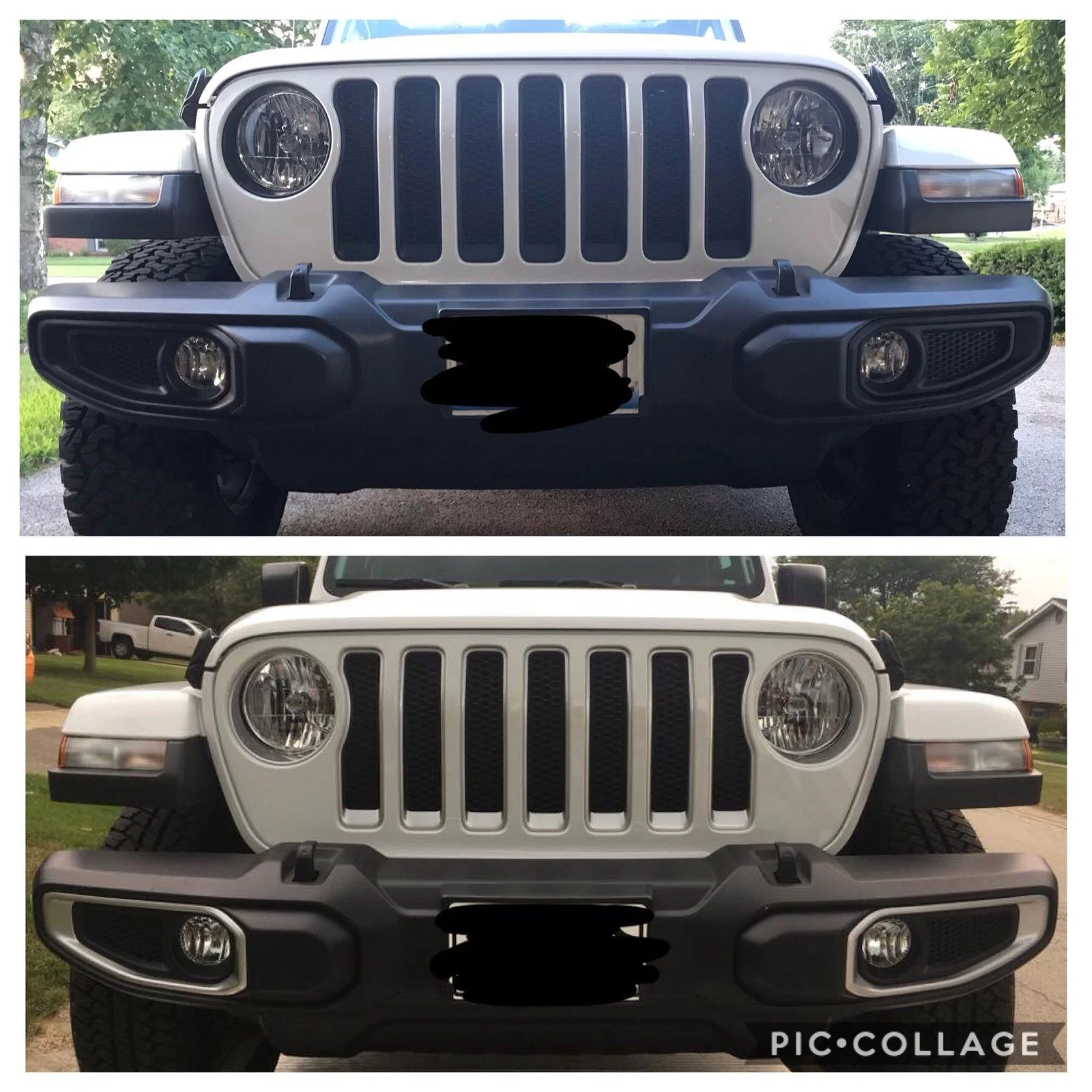

I am doing mine as well. The grill pieces are pretty straight forward. Remove the grill and lay on work bench face down preferably on a towel or something similar to prevent scratching. Then there are screws and clips that need to come off to remove plastic black mesh and then the inserts that are silver. As for the bumper pieces they pop out from front except for one screw towards the outside of bumper, I already broke one but don’t think it will be a big deal. If you pull rear cover back that’s on back side of bumper you can get to the screw. I am using the Dupli Color trim and bumper paint in grey. It’s a little darker than the Rubicon grey but my Sahara is black so I think it will look good.

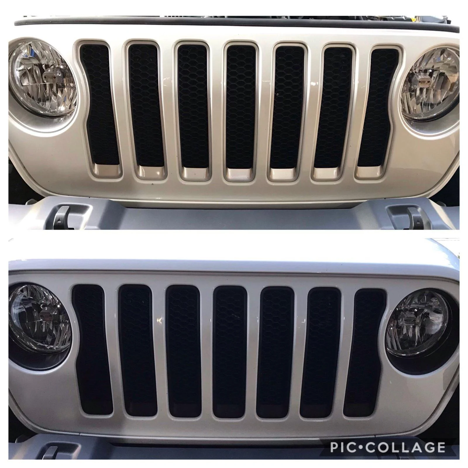

Plasti-dipping is so easy and forgiving, it’s a great way to see if you like something before going all in with spray paint. I have done wheels, emblems, and also these grill inserts which I really like the look now but the silver is gone. There are tons of videos on YouTube and pages on this forum showing how to do it, in the end I’m very pleased.
