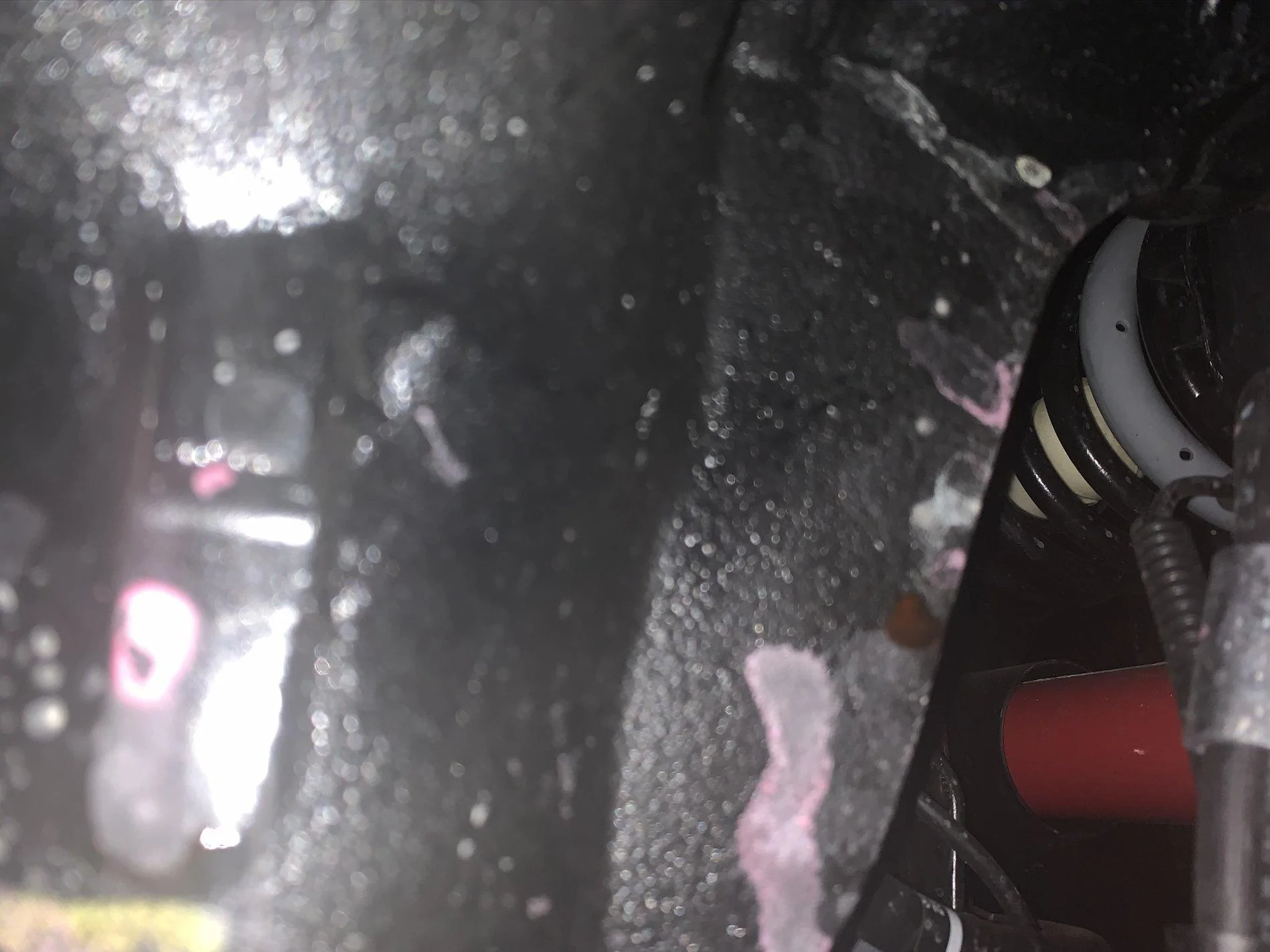

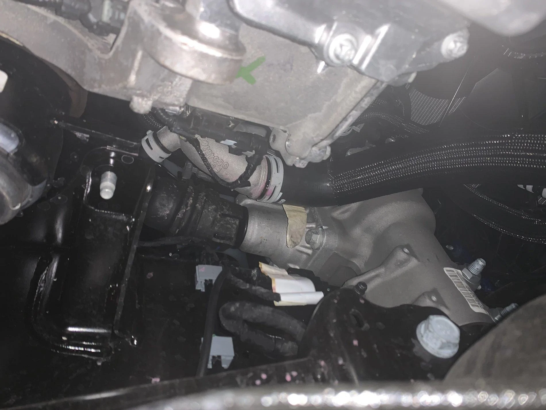

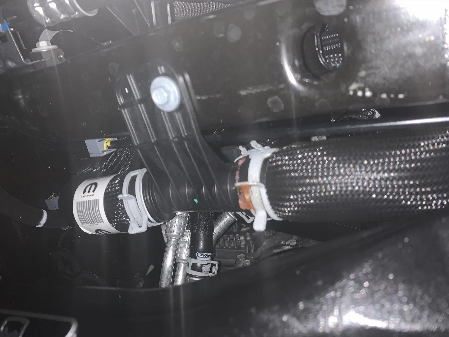

My new 2020 Rubi (2300 miles) has been leaving stains on the garage floor. Went and looked, and it’s leaking pink fluid. Also on several other seals (where I don’t see a leak), there’s a weird gunk that honestly looks like pizza sauce.
Any other 2020s have this issue? Going to the dealer Monday.

I believe the pink fluid in the photos is dried coolant. There may be leaks where the fluid buildup is visually apparent, or somewhere above where the fluid is building up (ie: its dripping down).
Be sure to point out each spot to the service writer. Dealership should be able to fix the issue fairly easy.
My '18 had a similar issue - small leak fixed at the dealer in one visit.
Ugh I was hoping it wasn't -- it has a water-like consistency, and doesn't smell like anything (and was under the impression coolant smells...not great).

Sorry looks like drive thru carwash soap.
TRJeff
Jan 27, 2019
42
54241
2019 Jl Rubicon
Coolant, let dealer check out and take care of. Probably bad or improperly tightened clamp

Dealer got back to me today. The radiator needs all new hoses and clamps. Supposed to be in Monday. :headbang:
