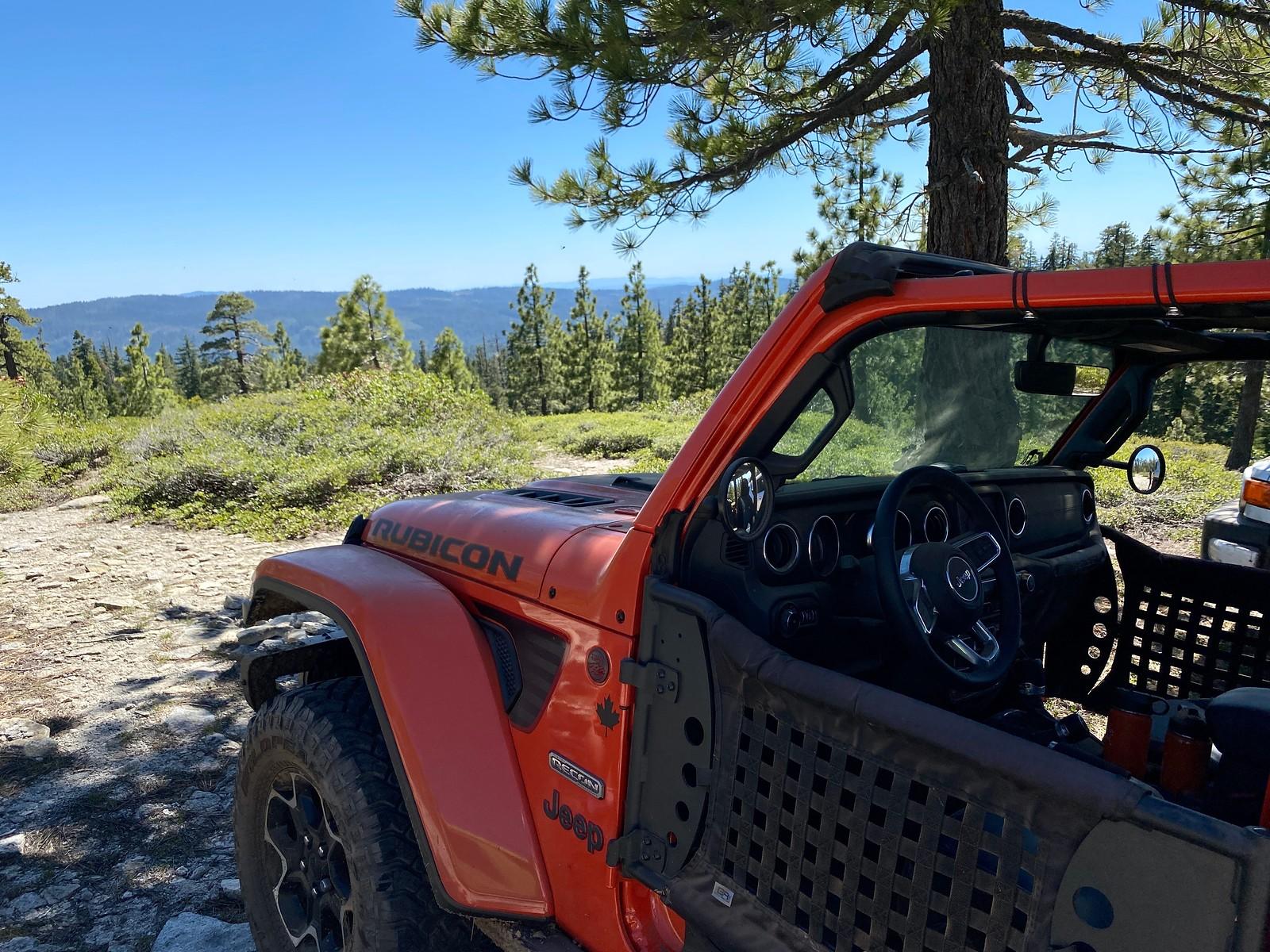

Hi Terry, welcome!
I wanted my own bright and badass Jeep after my husband sold his JK. I went with the Rubicon because we do some off-roading. But I will confess that I love the capabilities and looks, too.
I have had both the 3.6 and 2.0T and love the turbo for around town because the torque is great (I used to drive Miatas and still have fun behind the wheel). You can‘t go wrong with either engine so pick what makes you happy.
I have a soft top and love it! It’s down as much as possible and makes the Jeep a fun convertible.
Chief (a light blue) and Gecko (an awesome bright green) are going to be available later this year.
Good luck!
Some required pics:

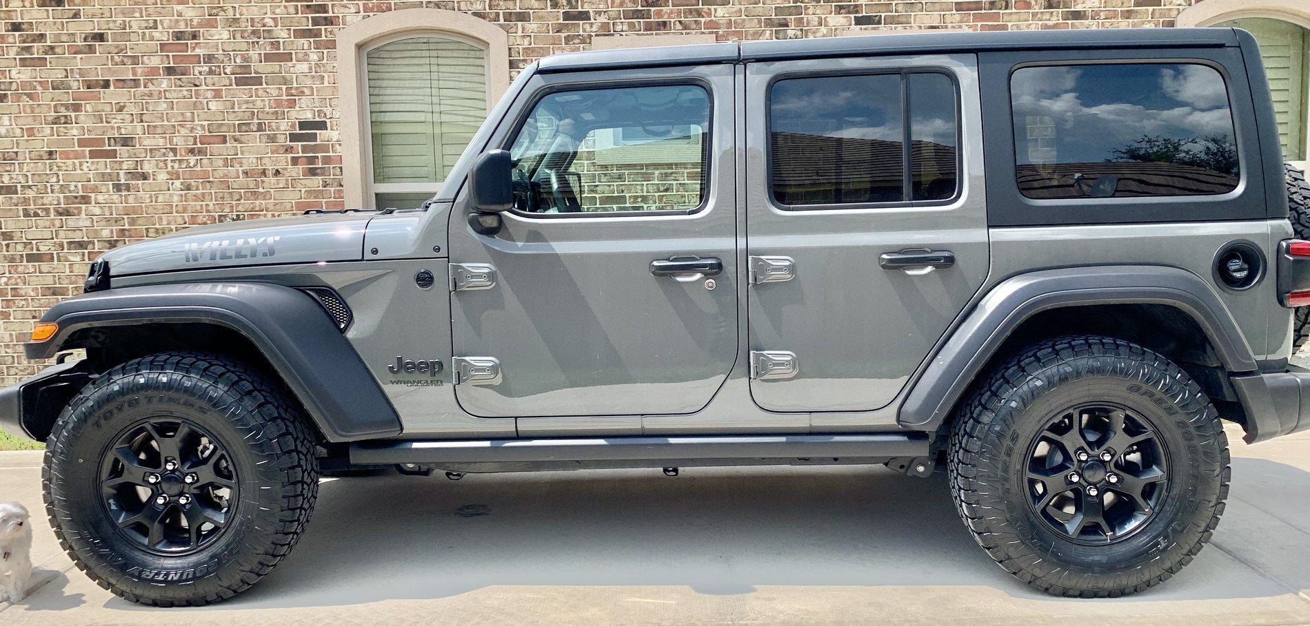

I went with the Willys, seems like a good compromise between the Sport S and Rubicon. I added 285/75 tires a couple of months ago, no lift, no rubbing. I personally think the Willys is a good value for what you get.
I saw your Willys in the thread about the 285/75-17 tire size. This tire size is a great find. I really like your setup and looks great. My issue is the wife (me too) would like 2" lift and I'm likely going to space the wheels out with spacers. The look moves far closer to the "bad-ass" look my wife wants.
