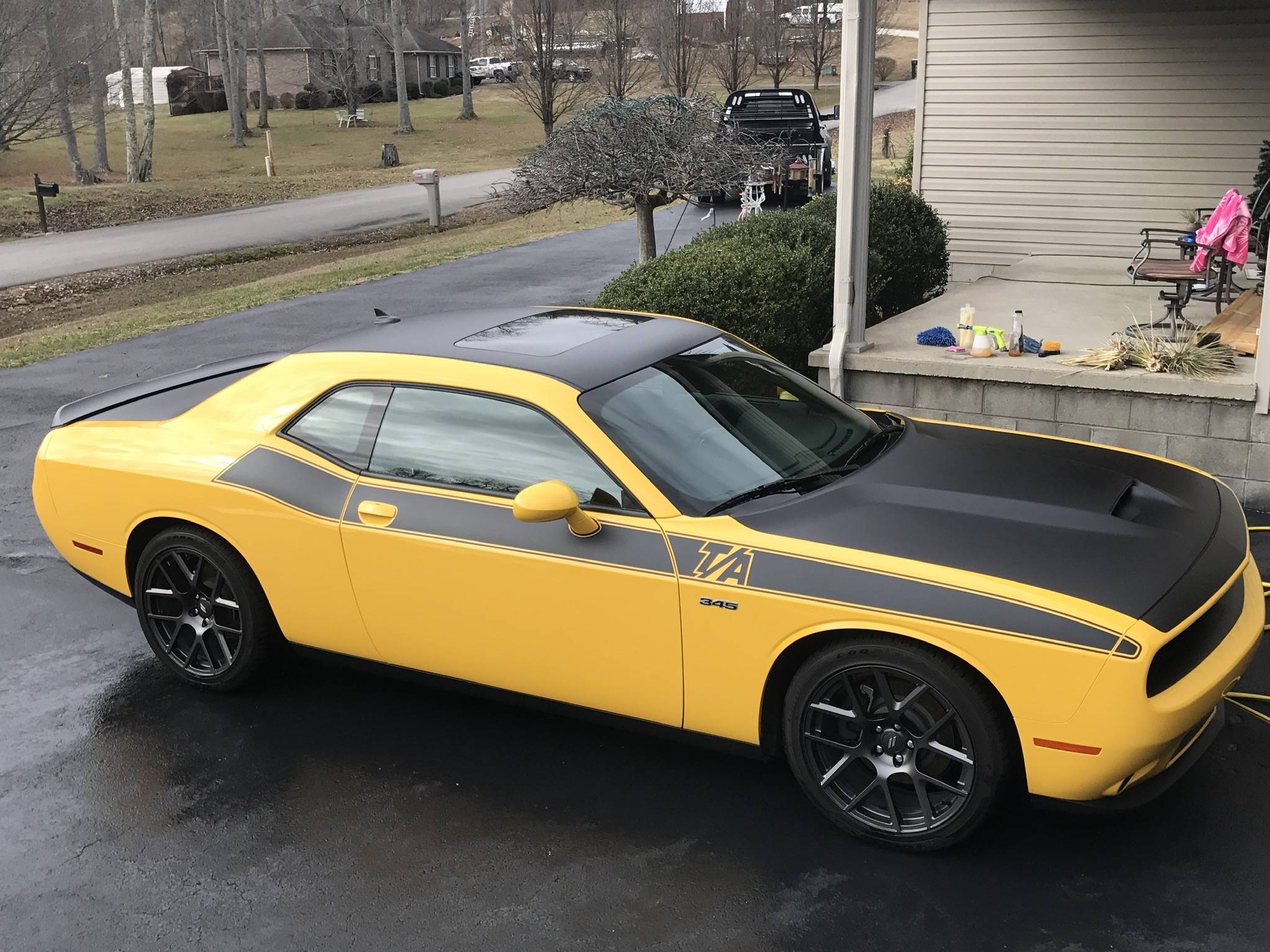

I previously owned a 2018 Dodge Challenger T/A and there were lots of info available on those pages.

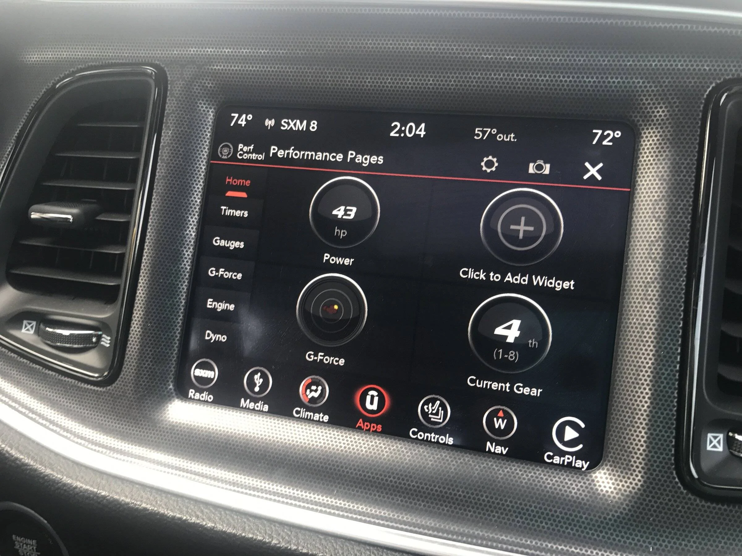

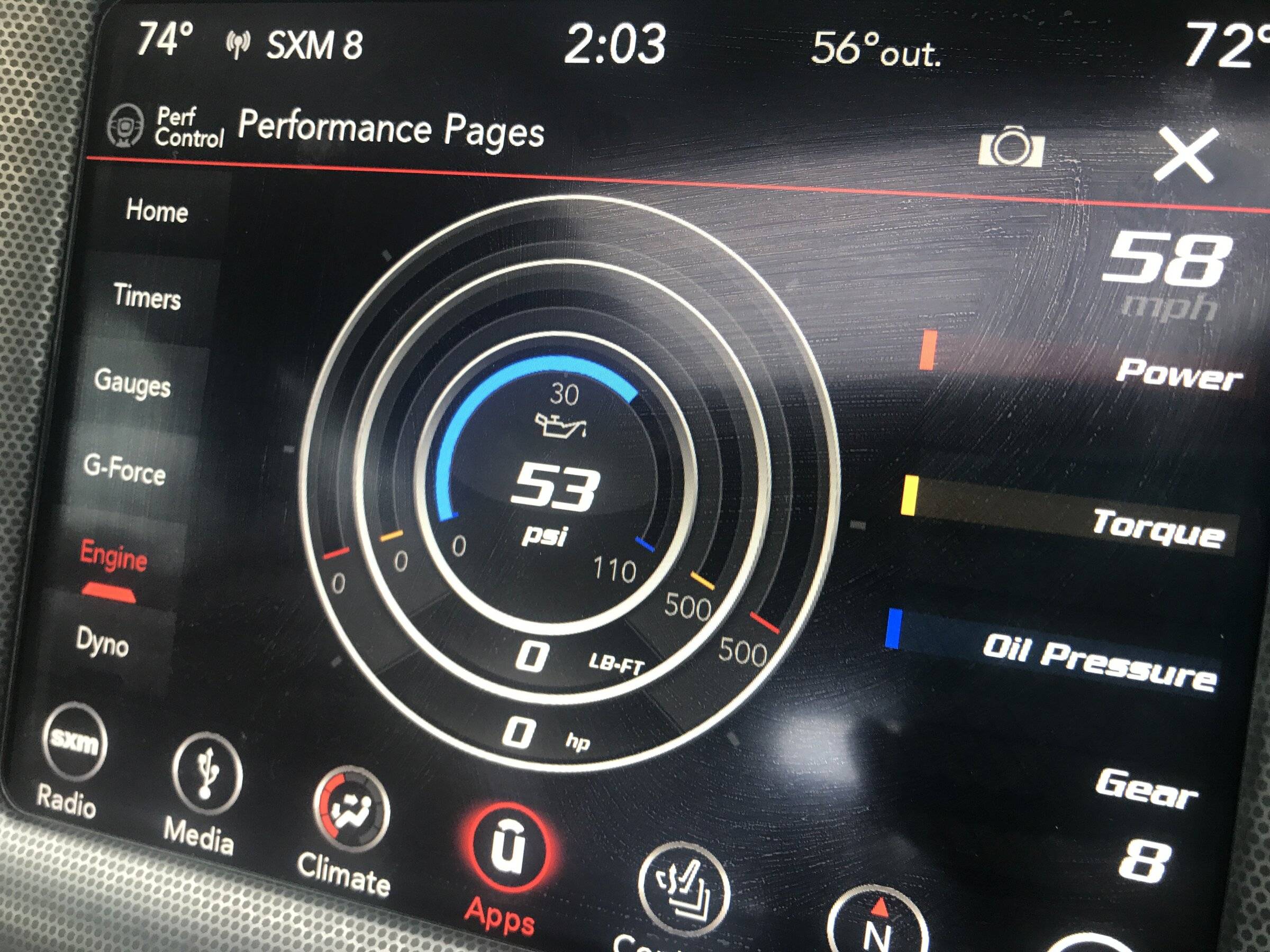

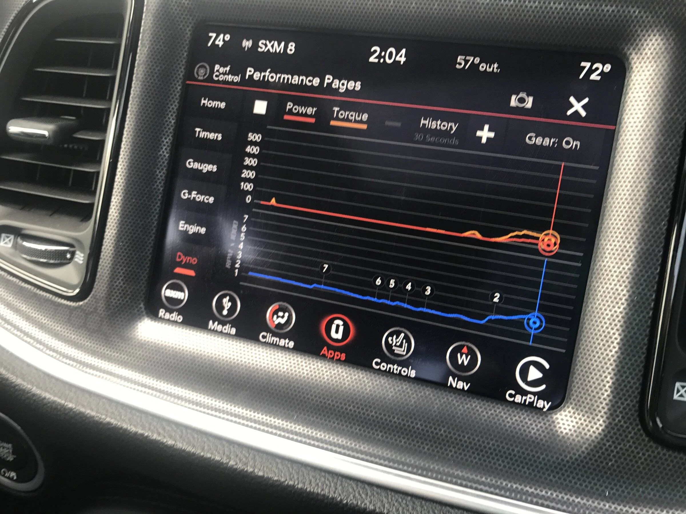

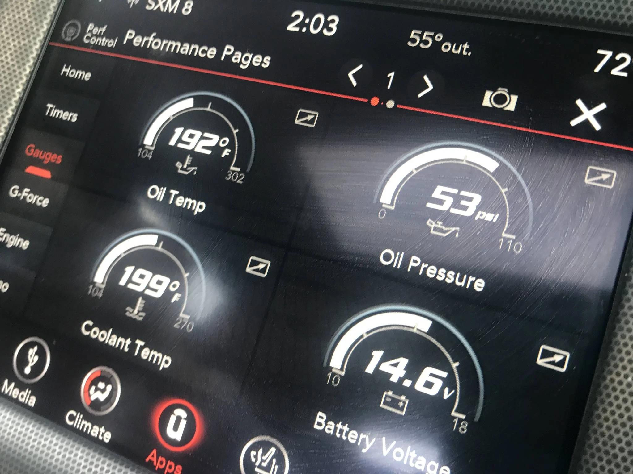

Posting a few pics for the ones wondering about the Performance Pages.....
Can’t be done. The Uconnect radio integrates with the vehicle’s CANBUS and the Wrangler does not have the necessary systems that would even work with the Performance Pages from a Challenger or Charger. We get the Off Road Pages which are made to work with the Wrangler and 8.4” radio.Was curious if anyone has added these to their Jeep Uconnect?
Have them on my Dodge Challenger and again just wondering if they could be added.
Hi,Can’t be done. The Uconnect radio integrates with the vehicle’s CANBUS and the Wrangler does not have the necessary systems that would even work with the Performance Pages from a Challenger or Charger. We get the Off Road Pages which are made to work with the Wrangler and 8.4” radio.
