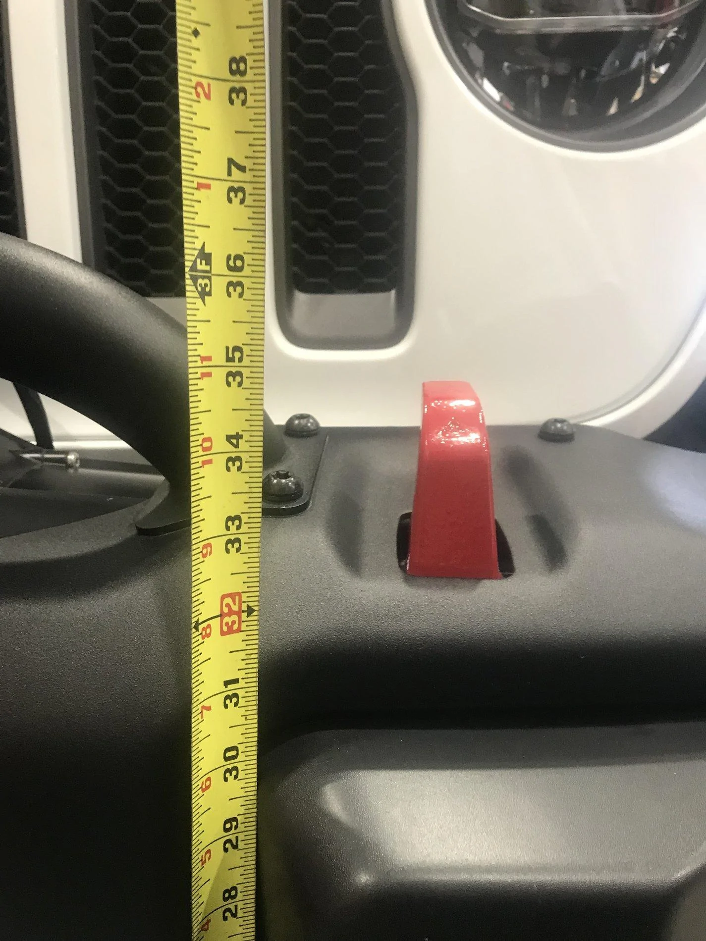

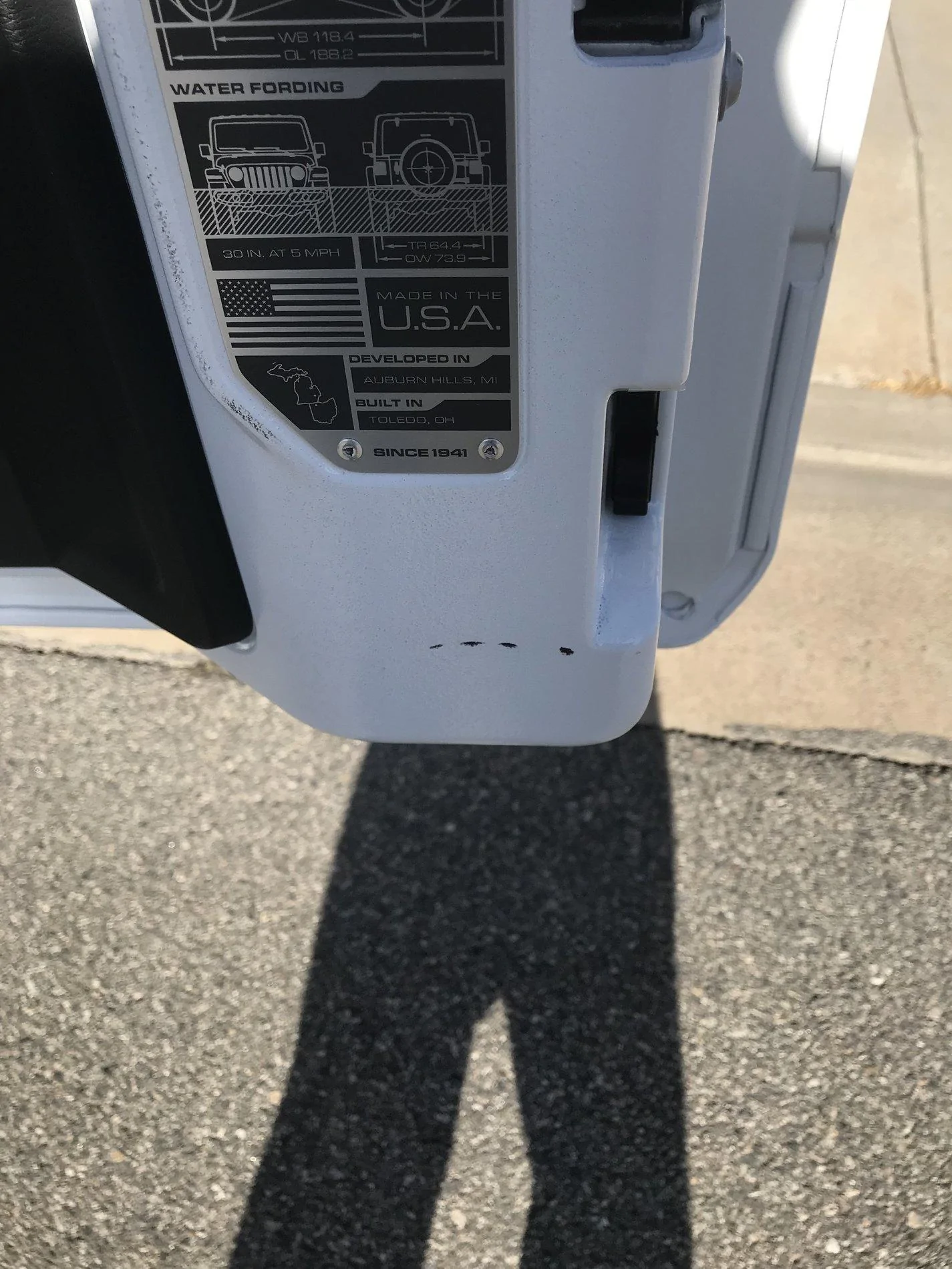

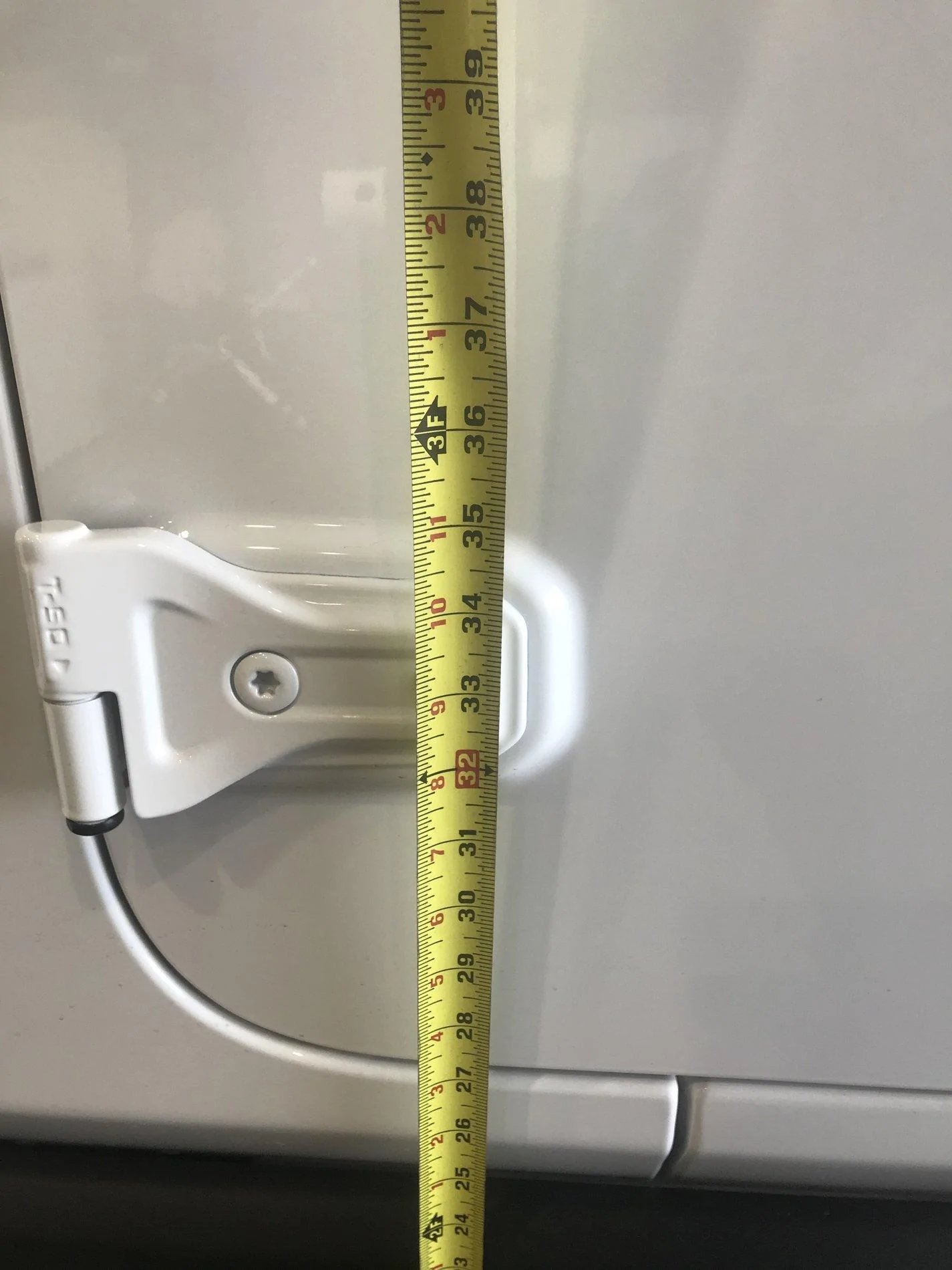

I agree with NFRs2000NYC.You are inferring something that isn't the case. 30" of fording means the engine is safe from hydrolocking, and there would be no damage to the axles or mechanical components. It says nothing about getting wet carpets. Automotive seals, be it on a G Wagon, a Range Rover, or a wrangler, are not marine grade, nor are they watertight. Now, while you may have zero water intrusion if you dip in and out of a 30" hole, if you are crossing a river, meaning, you will be submerged for a prolonged period, the water will start dribbling its way in, which is why Jeep gave you drain holes in the floor. Seasoned Jeep guys know, that if they are going to be doing water crossings regularly, it's just easier to pull the carpets, maybe even line-x the interior, and have no issues with water, but this nonsense of it being "watertight?" NO chance.
Below are some videos/pics of my JKs going through water. I always got water in the Jeep, but no damage.
