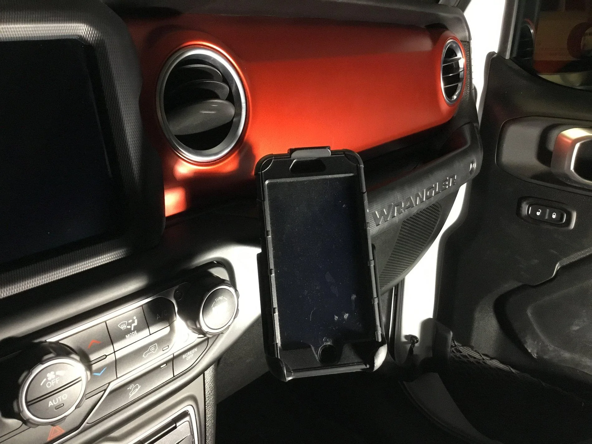

Forum member's JL - Accident not long ago..
Thanks for this picture. Now I'm definitely not going to mount my cell phone to the grab bar. I think that a ram ball attached via bolt would be ok, but not the phone attached to the ram ball. Airbag deployment at 200mph + phone at 200mph = bad.

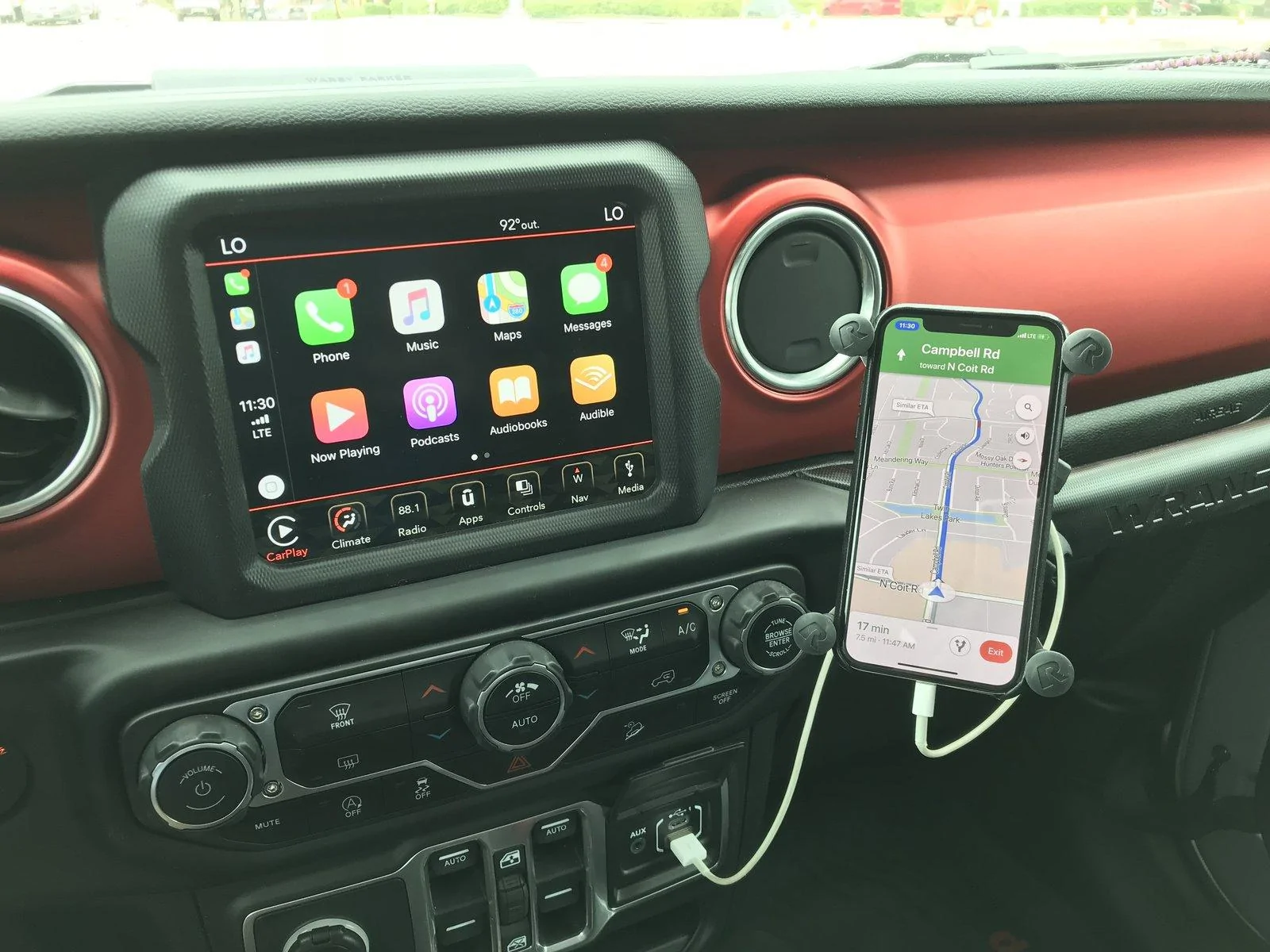

Sorry to resurrect an old thread, but I’m also curious about the deployment zone of the passenger front airbag. The two videos in this thread that show deployment are not Jeep Wrangler JL models. And the one still picture that is a JL, doesn’t show the top left part of the airbag - which is my concern.
I’m using the 67 Designs JL mount for my smartphone - almost identical positioning as shown in their stock photo from their website (see attached pic with phone just to the right of the infotainment screen). Am I asking for projectile trouble?!?! Anyone know where I can find detailed measurements or a picture showing airbag deployment zone? See pic below:

There have been pics posted elsewhere, but I don't have them. It comes out from the center of the cover, above the grab bar. The things mounted on the grab bar that hang below shoudl be fine. As for other things like the cell phone mount, I'd be careful, but the force of that bag will blow most of those kinds of things out of the way. If too rigid, I'd worry that something might cut the airbag, though. I think it is best just to leave a clear path. There are plenty of mounting options all around.
From what I've see, though, I would guess the mounts and things the OP shows would be fine and do leave a clear path.
