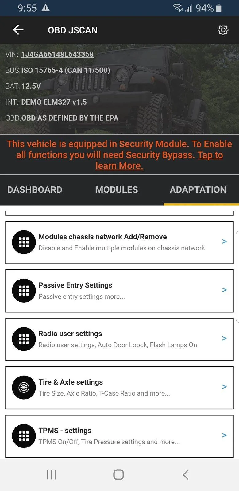

OBD Jscan app has more features then Tazer mini - I have attached screen shot of just a few (also does live data, airbag, brakes and engine codes read /delete). You do not marry it to your car, nor need to keep it connected for any of its features.
1 car license cost $23 (app is free and can use some functions without need to purchase license)
You also need OBD bypass wires. $24

Yes, it's a great tool to have for only total of $75 . Pluss you can use it on other vehicles (if you have Chysler/dodge/jeep vehicles) or just use OBD bluetooth with free check engine diagnostics on any manufacturer.
I used it to rest my airbag module (instead of paying $140 at the dealer) , changed my tire pressure warning pressure to 20psi, and calibrated spedo for larger tires.
It also have function to turn off ESS, but my Jeep ESS does not operate due to weak secondary battery (drained battery too many times with kids playing)

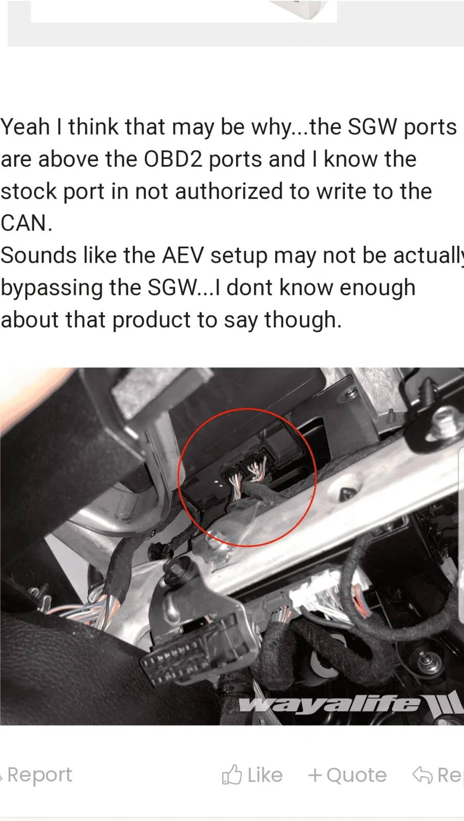

The 12+8 Adapter wires is bypass for Chrysler's Security Gateway Module (SGM) which limits an aftermarket scan tools to only reading DTCs and viewing data. Tazer also have bypass module that's neded for it all to work.
Wires plug into BCM above OBD2 port. Nice thing about it, when everything is plugged in, its completely out of the way and hidden.
