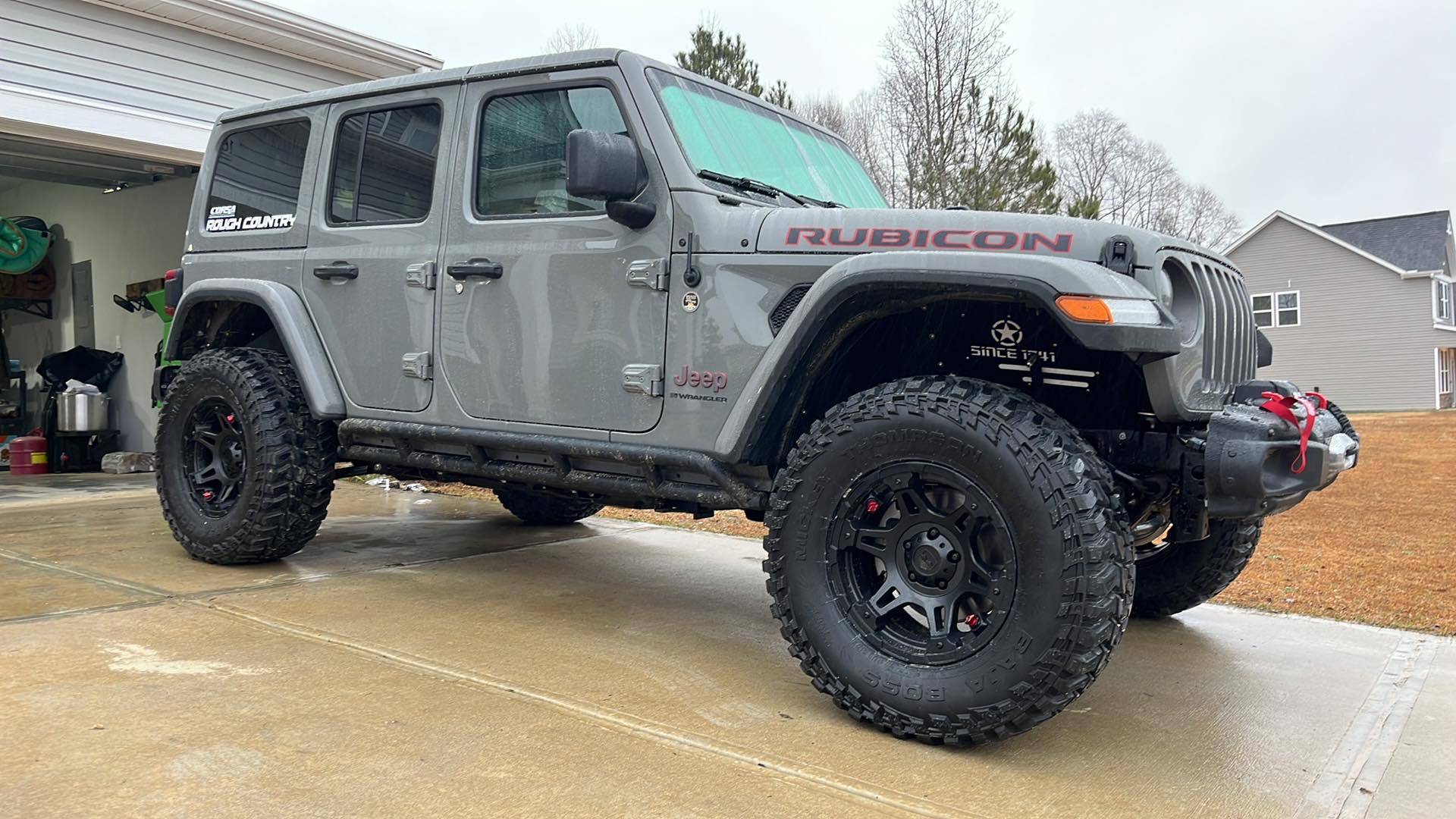

Pic for attention.
Jeep Wrangler JL P0171 and p2096 330779326_494620349314484_8938941659077092902_n
