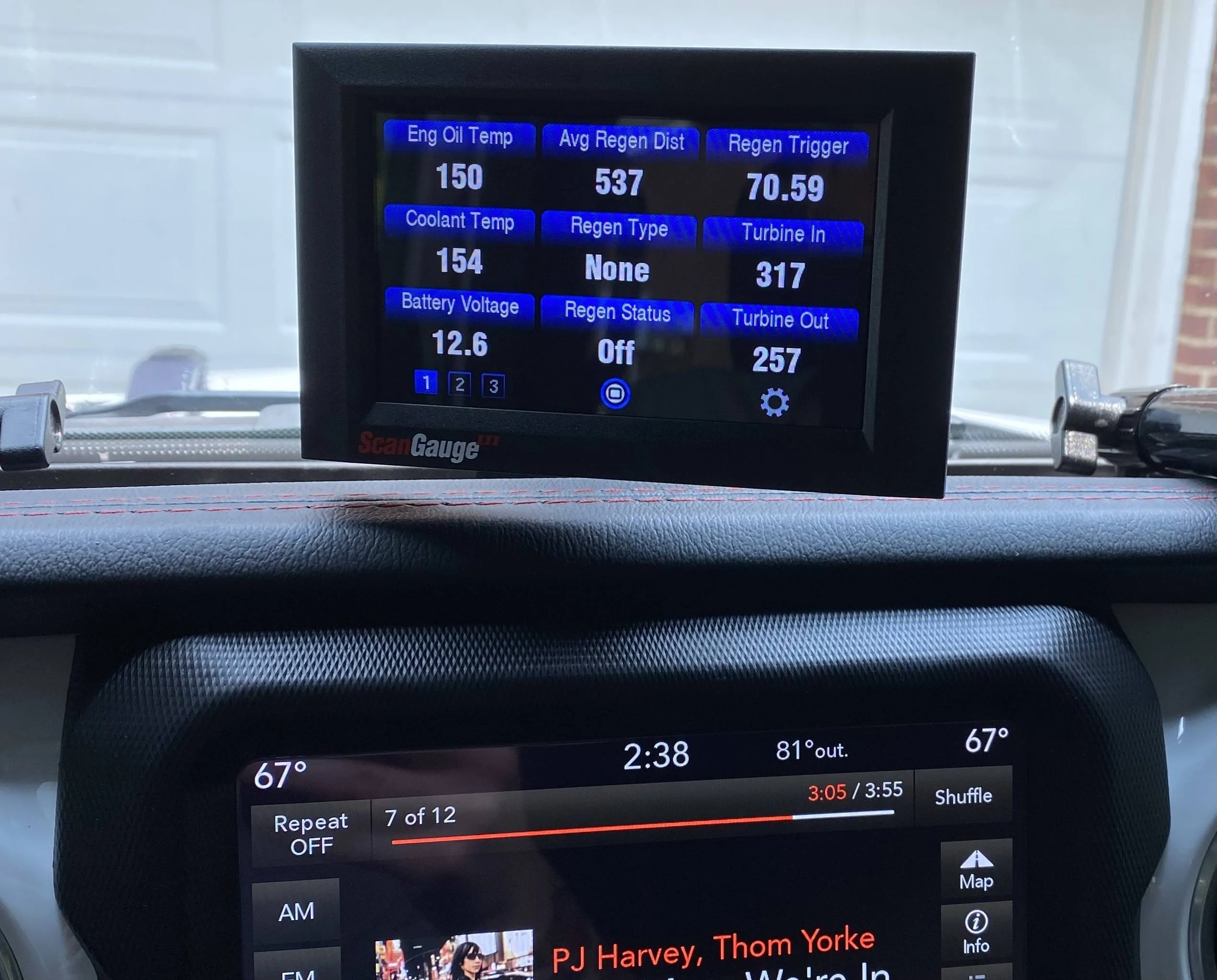

The Scan Gauge 3 does a great job of monitoring Turbo temps and Regens, among a whole host of other metrics. Most times while driving it will do a "Passive Regen", and then once my Regen Trigger hits 100% it will cause and "Active Regen" Here is mine:
Jeep Wrangler JL Owners Manual and DPF? IMG_3353
