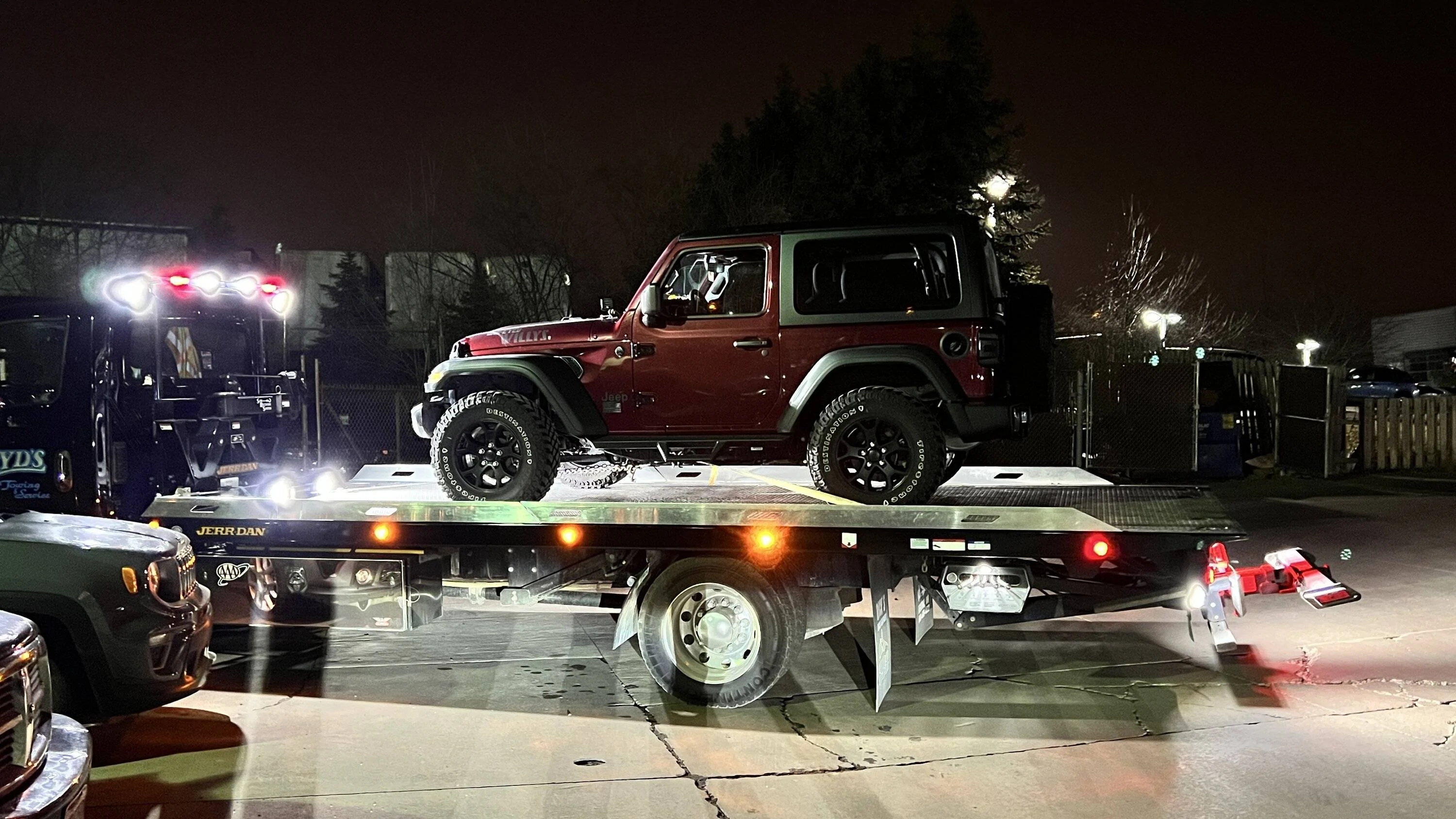

My daughter got some type of overheating warning on the dash of her JL last night, so she immediately shuts it off and call me. I show up and there's coolant all over the place, so we get it on a flatbed to our local dealer to see what happened. 2022 w/ 21k miles. Curious what happened. I'll update this post when we get an answer.

I believe the TSB was for the loose bolt? That was my first thought, but I thought that was for models prior to '22, if I remember correctly. We had the TSB done on the wife's '20 a while ago.

Yeah, maybe that is it. I see the TSB is dated 3/22/22, and she bought it new almost exactly a year ago.
Mine is a ‘22 and I got the TSB.
