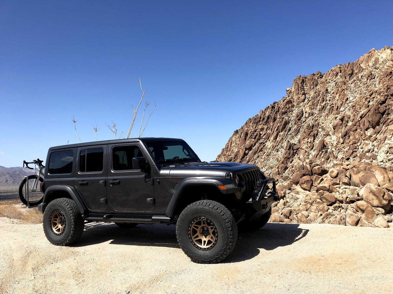

285
328
Tucson AZ
2018 JLU Rubicon
Love the debadged look on the Chrystal Granite.. Here is similar setup with mopar 2 inch and K02 35's
_xR_pgEyRyeXlQz5cYeNuKa3taGslmoh6c86Nys4SL63skLtfRVHczR5HejmPYtYrxNlK8cOgNxNHy4om=w1634-h1225-no.jpg

^^^ Nathan, your Rubicon looks cool! Love the wheels, good contrast there :like:
