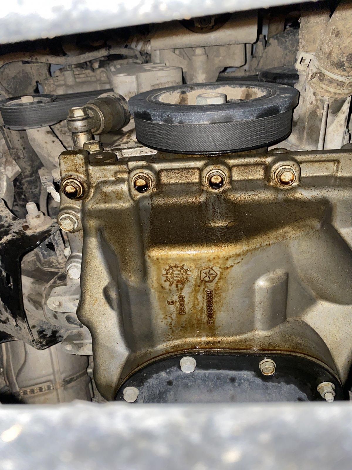

Super frustrated with my Jeep JL, first had a engine block change at 22k miles... today I have a oil leak, this engine has no more than 25k miles since installed.... does this would be coverage by warranty?

100% yes. It will be covered if it was a FCA warranty replacement

Looks like the front main seal. Should be covered.

Im planning to take it tomorrow to my dealer and see what they say

To give an uptade, the dealer check the car, and advised the leak is coming from the rear and fron main seal.... currently they are working on it and it will be covered by warranty.
