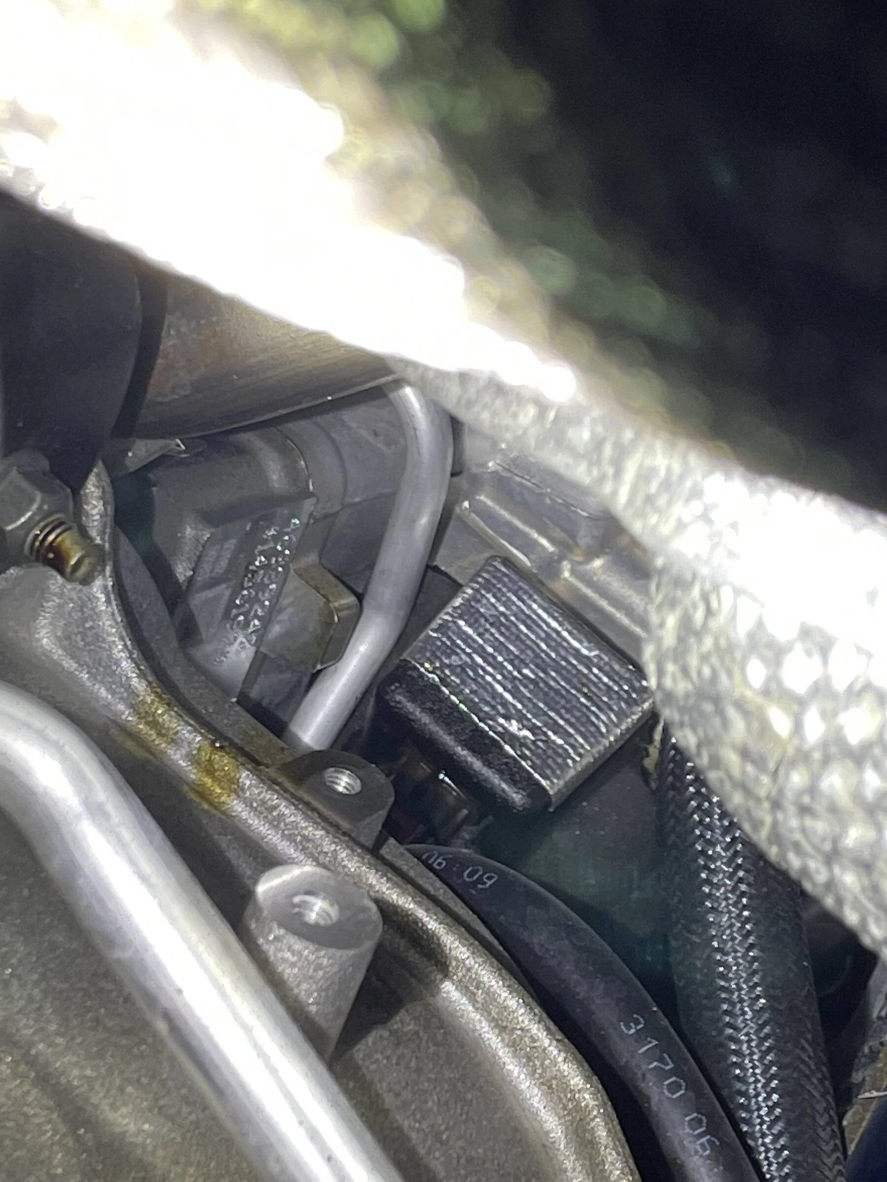

Unfortunately this leak is still a problem with the 3.6 oil coolers even with a few revisions to it. Last spring you couldn't find them anywhere with dealers selling 60+ a month they were backordered. Crazy thing is they seem to leak more when its extremely cold.If it's a 3.6, pop the hood and look at the oil filter housing. Right on top front center of the motor. I had a JK that looked like it was coming from the aft end of the motor somewhere and turns out it was the oil filter/cooler housing. Oil was pooling and then dripping down and back.

It is still a problem. We sell them things like hot cakes, you can do a "cheap" fix of getting the gasket kit from chrysler but it's hit or miss. Plastic will never last going through hot/cold cyclesIf it's a 3.6, pop the hood and look at the oil filter housing. Right on top front center of the motor. I had a JK that looked like it was coming from the aft end of the motor somewhere and turns out it was the oil filter/cooler housing. Oil was pooling and then dripping down and back.

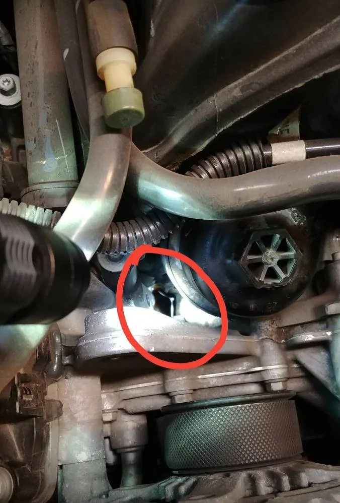

Dorman makes the only aluminum oil filter adapter out there, and of the 3 I have installed, one failed and leaked immediately. You cannot get the gaskets that mount the cooler to the oil filter adapter, for whatever stupid reason.I just replaced this myself, since I'm out of warranty, on my 2018. I didn't have oil pooling there, but it was slowly caking on my valve covers (which I originally thought was the problem) and some was resting in the valley when I got it apart.
If you can get your hands on an aftermarket oil filter housing made of anything other than plastic, I'd go that route, although under warranty the dealership probably won't do that. These things are built notoriously cheap from the factory. Time wasn't on my side, so I had to replace mine with another Mopar unit, but my dealership actually had a boatload in stock because they sell tons of them.
