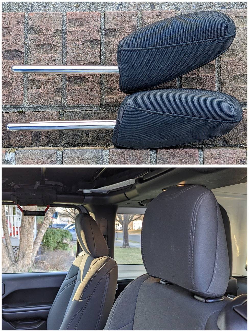

My issue with the seats is the fixed headrest (I know, "head restraint") angle. It's far too extreme for me and makes my neck ache on long road trips. They were probably designed by corporate lawyers and not by anyone experienced with comfort/ergonomics. I wish the angle was adjustable from the factory. For those that care, the angle is adjustable... with a steel pipe.

Thar sounds like 8th gen Accord gripes with head rests. Their fix was to grab a 7th gen seat head rest and swap out. Some just remove the thing. They are not head rests as we all are use to. They must be at a height where the back of the crown will touch the head rest. It is a soft cushion to stop whiplash not rest your head.

Perfect- Please advise on how you did it without damaging them.

Wrap the cushion in a towel and place the headrest on the ground under the Jeep's frame. Put a small board on top of the cushion and use the floor jack (between the board and frame) to hold the cushion firmly in place. Slip a pipe over the posts to get the leverage necessary to bend the posts to the desired angle.
My cushions were "dimpled" but the dimpling was temporary.
