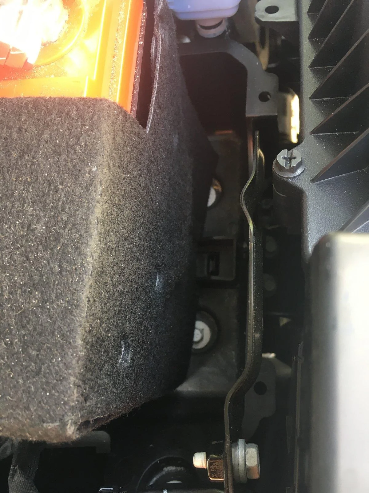

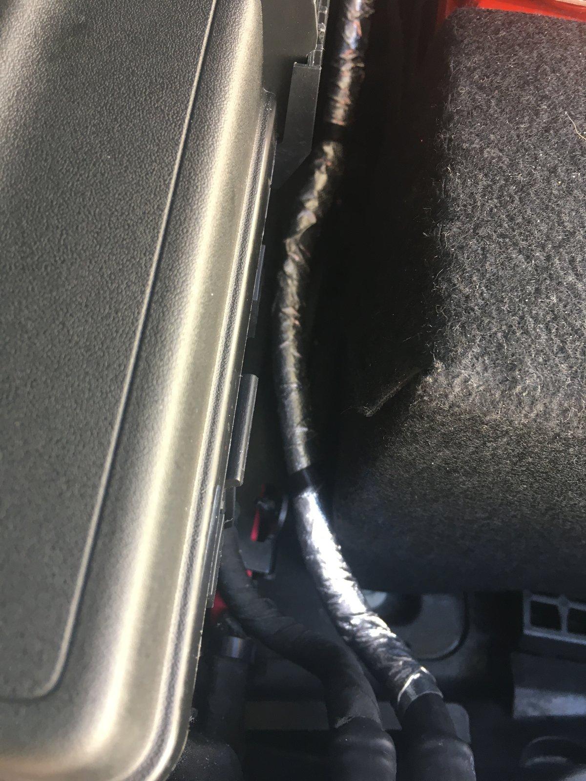

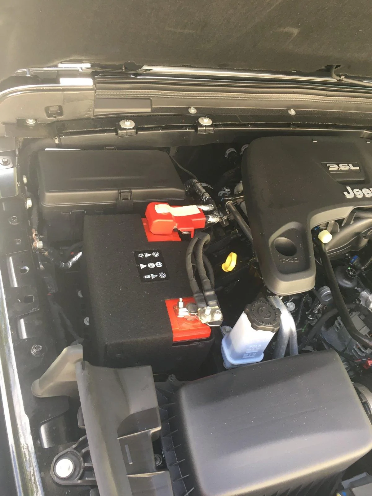

Well, it works, mostly. My Odyssey I had bought for my JK is taller but not as long as the stock JL battery. To fit it I had to make a couple minor adjustments.
(1) I had to pull the power cable out of its wire clamps. As it’s a pretty stuff cable I am not worried about it being lose or anything. They could be adjusted or replaced to make them fit.
(2) One the forward side of the tray there a replaceable little plastic cap which to keep the battery from shifting forward. If someone were to make a replacement the right size the battery would fit perfectly. Without doing so the battery can potential shift forward or backwards. (See attached.) There is about a half inch of play on either side.
