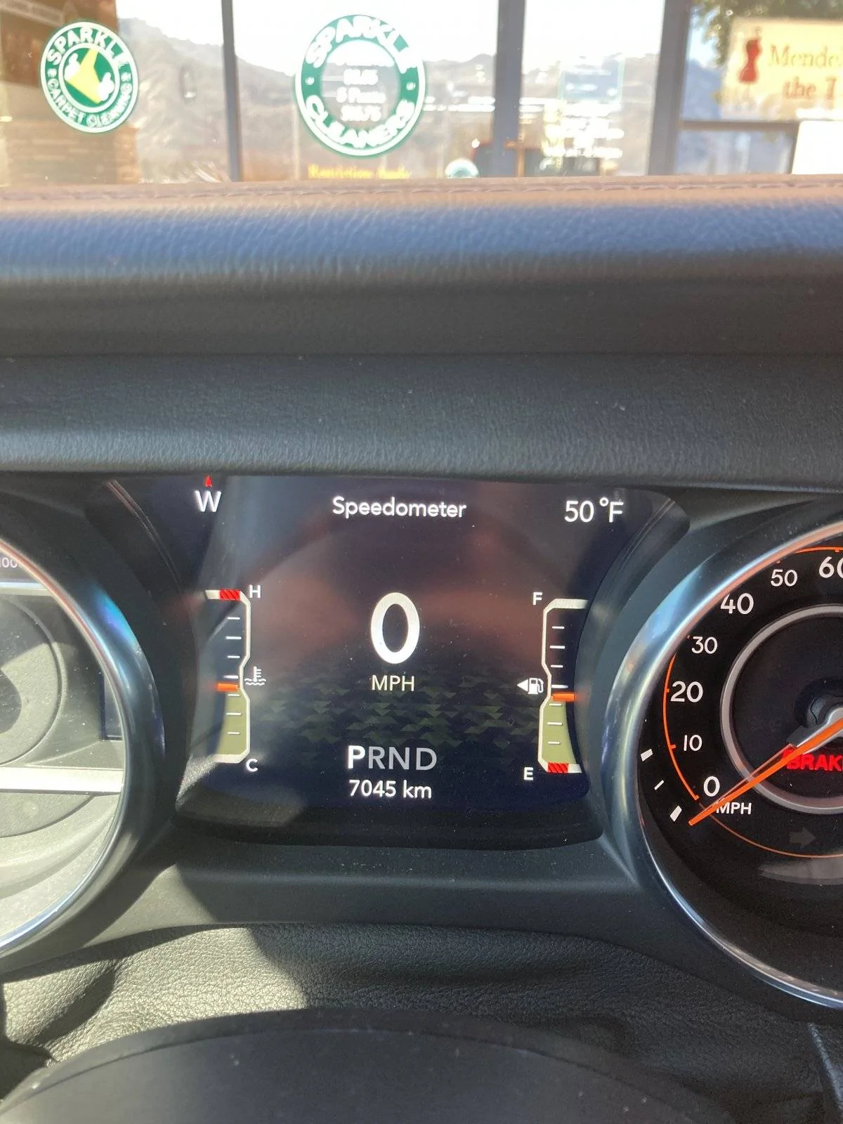

Somehow, my odometer switched from miles to KM. Not sure if I caused this or some electrical glitch. Can’t find anything in the owner’s manual or online help to switch it back. Help!

Hold your ok button for like 2 seconds.

He's taking about the odometer not the speedometer. I have the 8.4" head unit and it's in the settings app. It's under Display or Units for distance. Not sure where it is for other head units
