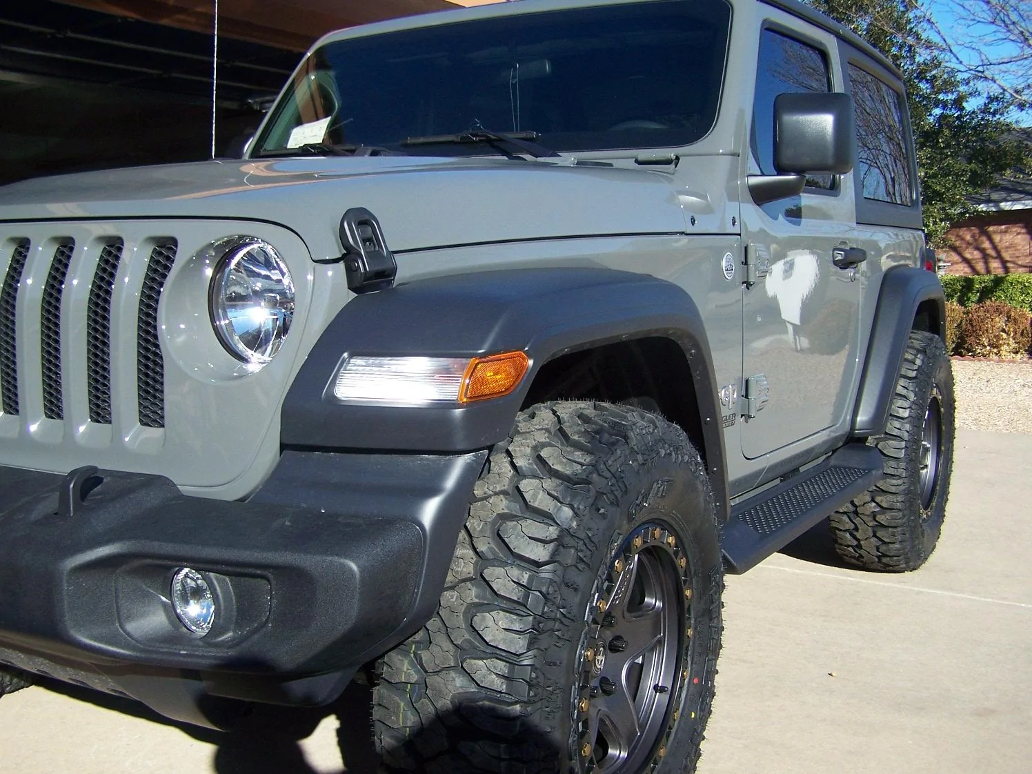

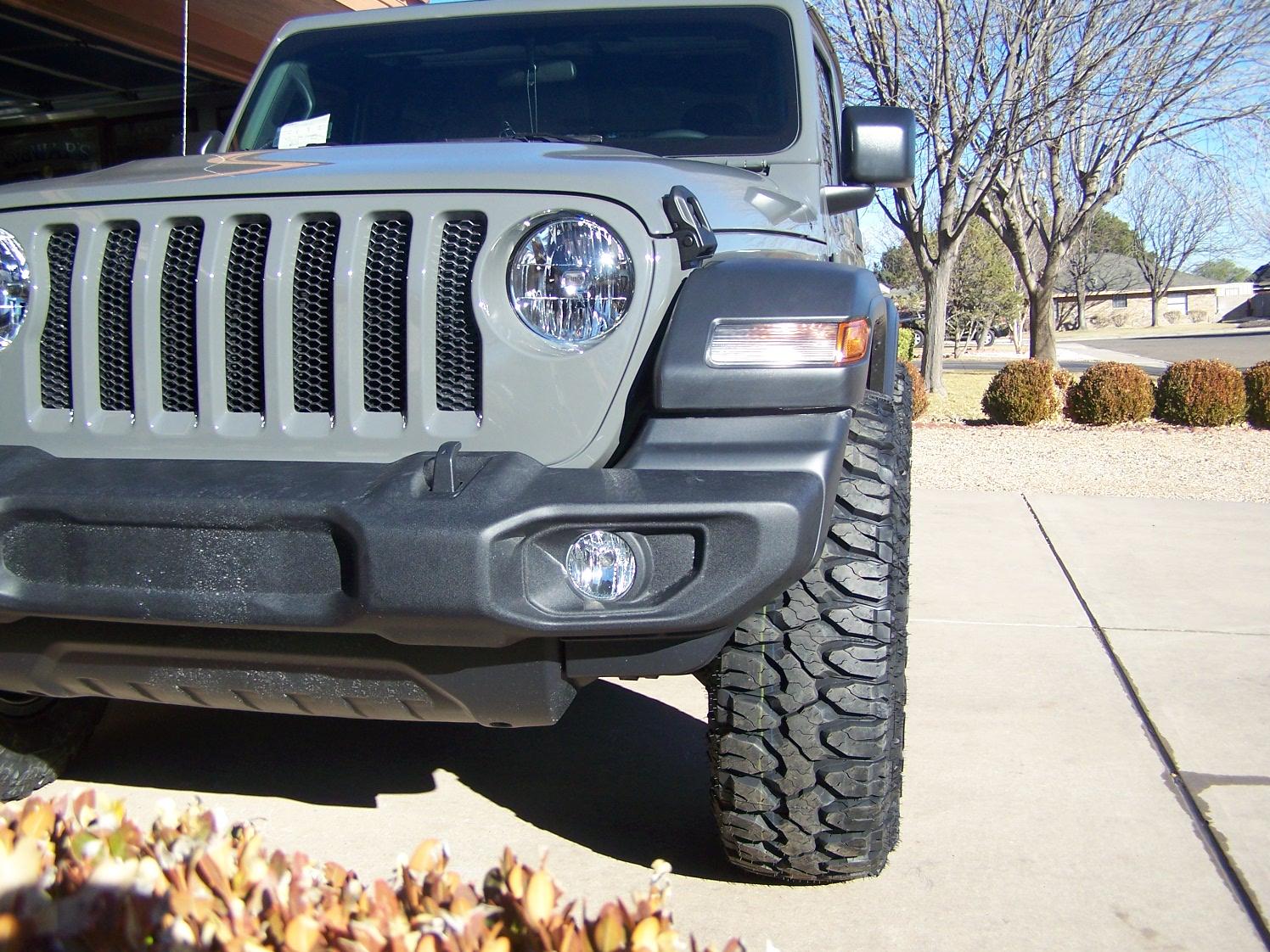

My wheels have a similar offset, mine are a +10 so about 3mm further in from the Tacktics. I run 295/70/17s w/ no lift. Like Lightsout posted, w/ a lifted Jeep with full coil articulation you may run into rubbing the higher you go, should be ok w/ a basic 2" lift though depending on tire height/width. Here's how my wheels/tires fit in the fenders
