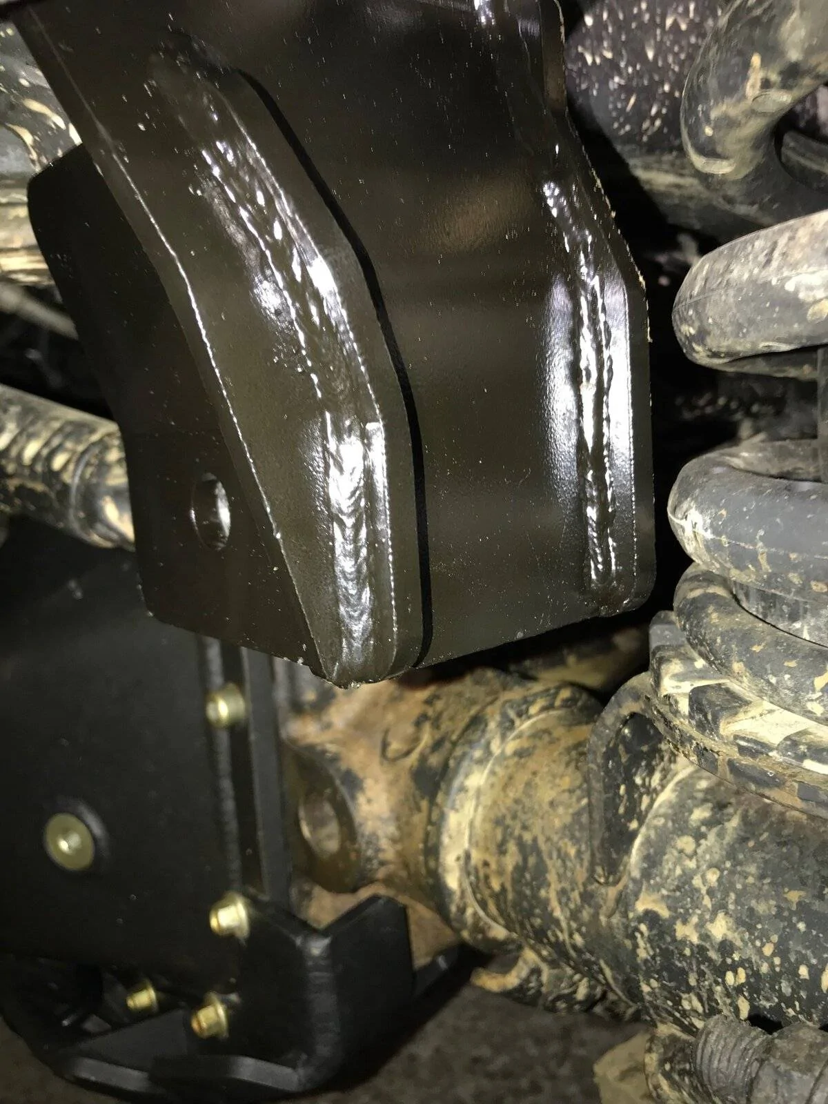

Hey Jeepers,
Just wanted to make a new thread to try and give fair warning to anyone looking to modify their Jeep and are unsure on how well things match up. If you have any parts or mods that have to be cut, drilled, etc in order to fit with something else, let us know! There may be other threads like this, but I didn't see any off the bat, and I ran into an issue of my own, so I'll start us off.
A Rock Krawler X-Factor lift will not be compatible with many rear differential skid plates, due to the fact that they add a relocation bracket for the track bar(I think, it may be a different bar, but bracket all the same). The new bracket is mounted around the rear axle, and is usually pretty close to the rear differential, which may cause some fit issues for most rear diff skid plates. I tried to install a MetalCloak rear diff skid, and it overlapped with the relocation bracket, which was a huge bummer because the MC skids are beefy and gorgeous.
Anyways, post any issues you've run into and help your fellow Jeepers out, before they spend the money and wait for delivery, just to send it all back!

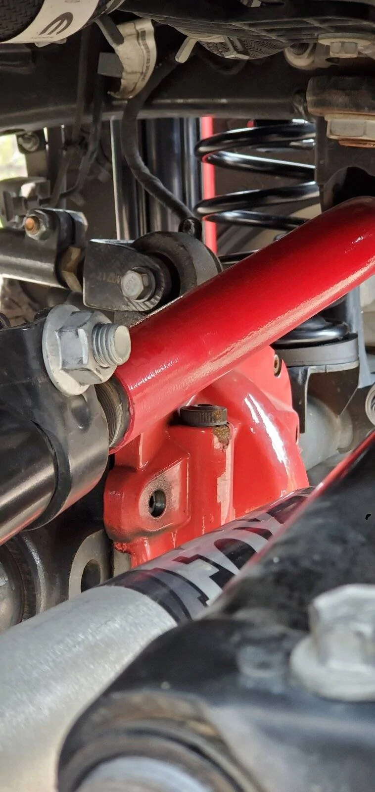

Good idea for a thread.
Stock ‘20 JLUR.
Steer smarts tracbar makes contact with the metal cloak front diff cover on stock height Jeep’s. Both parts are super beefy snd likely not to have any issues once I get my Accutune lift on. Still waiting on back ordered parts before I can install it.
Additionally, the falcon adjustable SS also makes contact with the MC diff cover on full turns to the left.

A Synergy rear track bar axle side relocation bracket doesn't rely on an extension and uclamp around the axle tube. It will work with the Metalcloak rear diff skid.
The SteerSmarts front track bar also contacts the ARB front diff cover. As mentioned earlier, stock height will be a regular issue, but I beat the powder coatingboff of both parts with my 1st 2" lift. I'm now on a 3.5" Gamechanger and it doesn't reach it in the same situations, but given enough reason to compress the front end, it will hit.

Forgot to mention: For those with a rear track bar relocation bracket that clamps around the axle tube, the rear diff skid from Next Venture Motorsports is your ticket. As nice as Metalcloak parts are, the front and rear diff skids from NVM are 2nd to none in my opinion.
