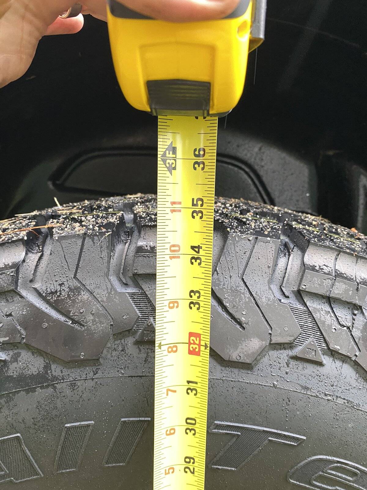

Mine came in at exactly 35, maybe 35.25. 17x9 30psi.
man do they ride smoooth!! Gone is the dump truck ride. Man the difference between E and C is night and day. Whoever says otherwise is maybe just running a harsh riding lift?!. Wow did that make a world of difference. So much more enjoyable
Yup this is going to be my tire. Does anyone know if K02s on rubicon’s sit at mounted? 31.5?
