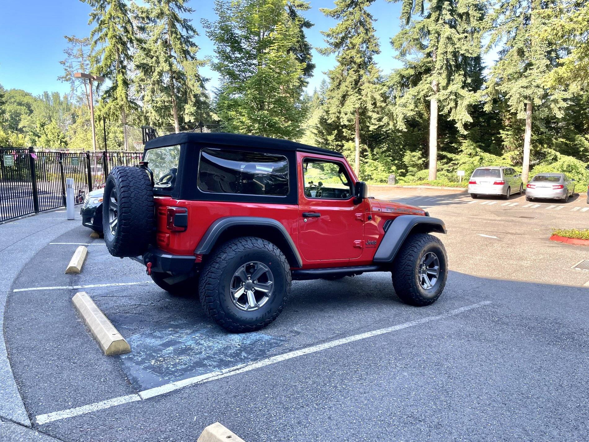

Loving the size, really glad I skipped The 35" step and straight to these. Another pic cuz why not.

Thanks for the report @RubiRed! Jeep looks great!
They have a little more tall and skinny look which I love.
I think your wheels have a +10mm offset. My wheels are 0 offset, so about .4 inches further out which might work out great, but looks like it is going to be close with the outer lip of fender.

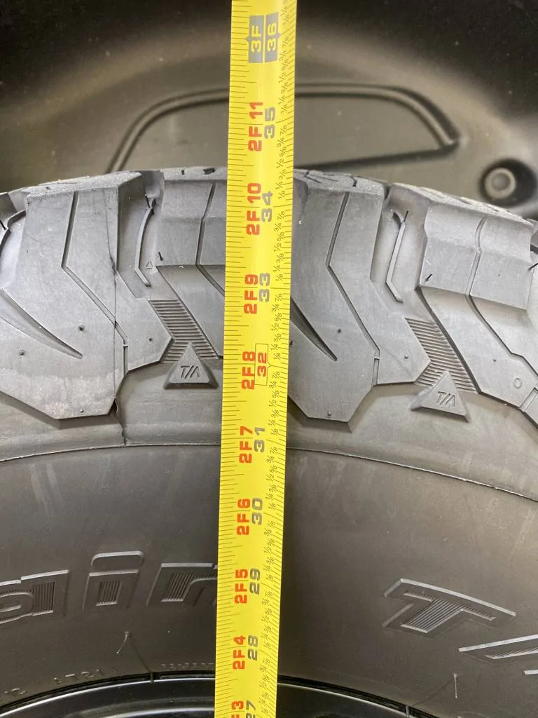

He is measuring them wrong if it’s the new 37” KO2.
I have posted careful measurements on another thread, with pictures, of ground to shoulder and ground to strait edge. Both under the Jeep and unloaded (spare).
The 37x12.5R17D KO2s at 30 PSI, under my 5,200lbs JLUR does not reach 35" no matter which way you measure it.

That is absolutely not how tires are measured please reread the previous posts you are misleading people! You have to put a straight edge across the top of the tire like a ruler and you measure to that you DO NOT measure just to the edge of the tread like you have done!!!
