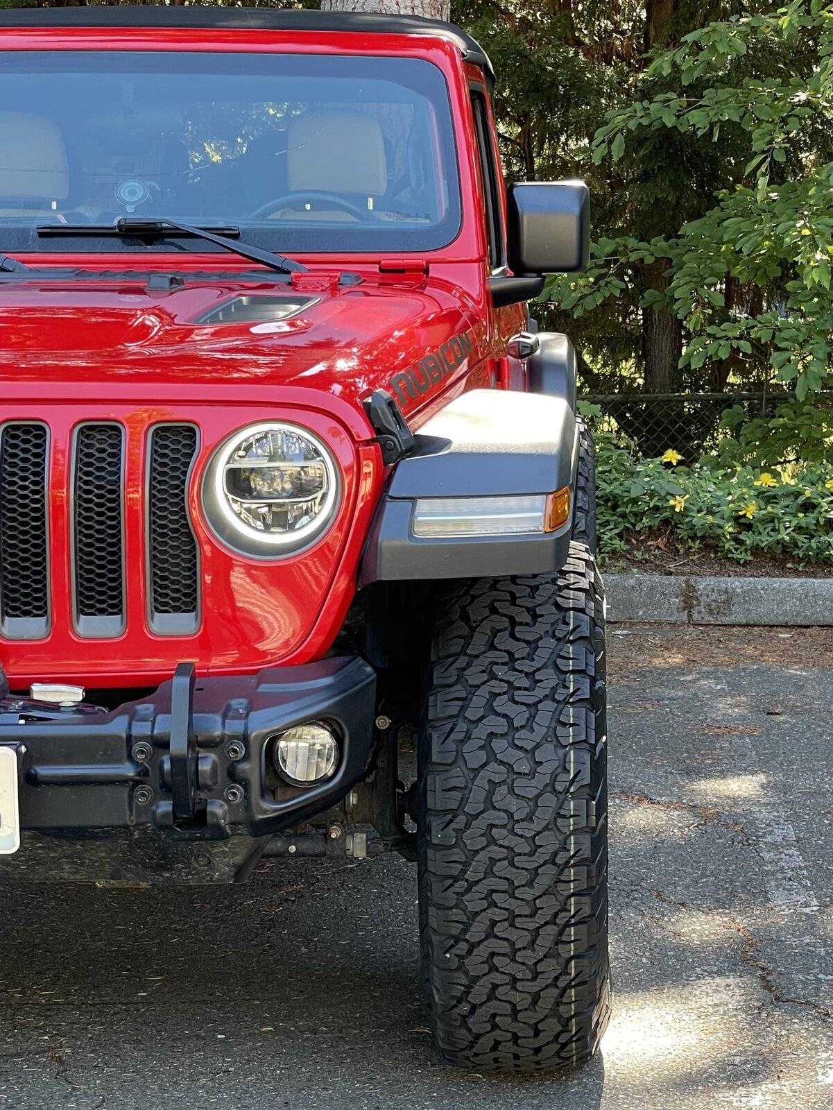

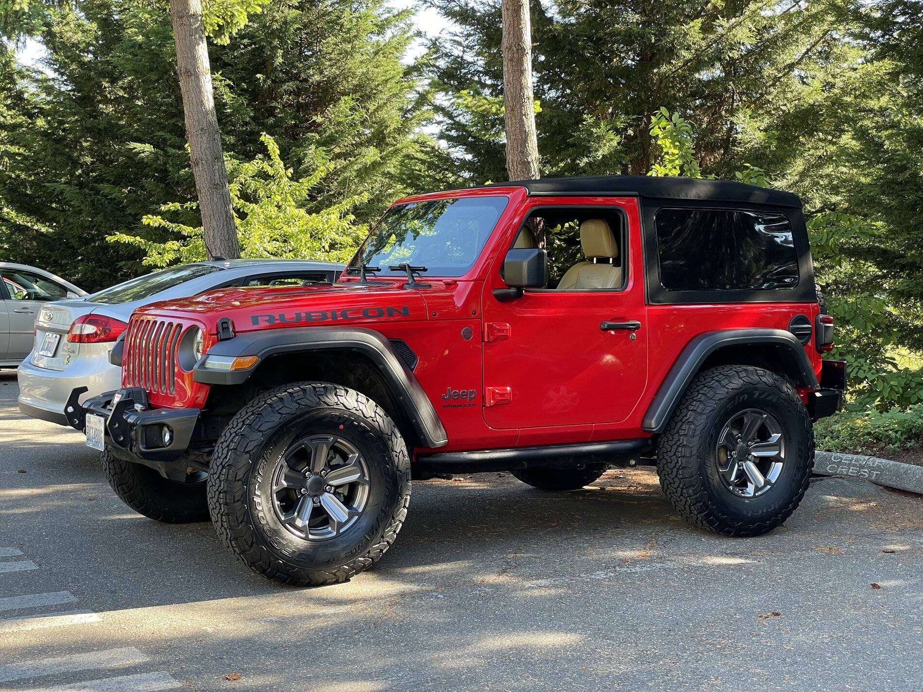

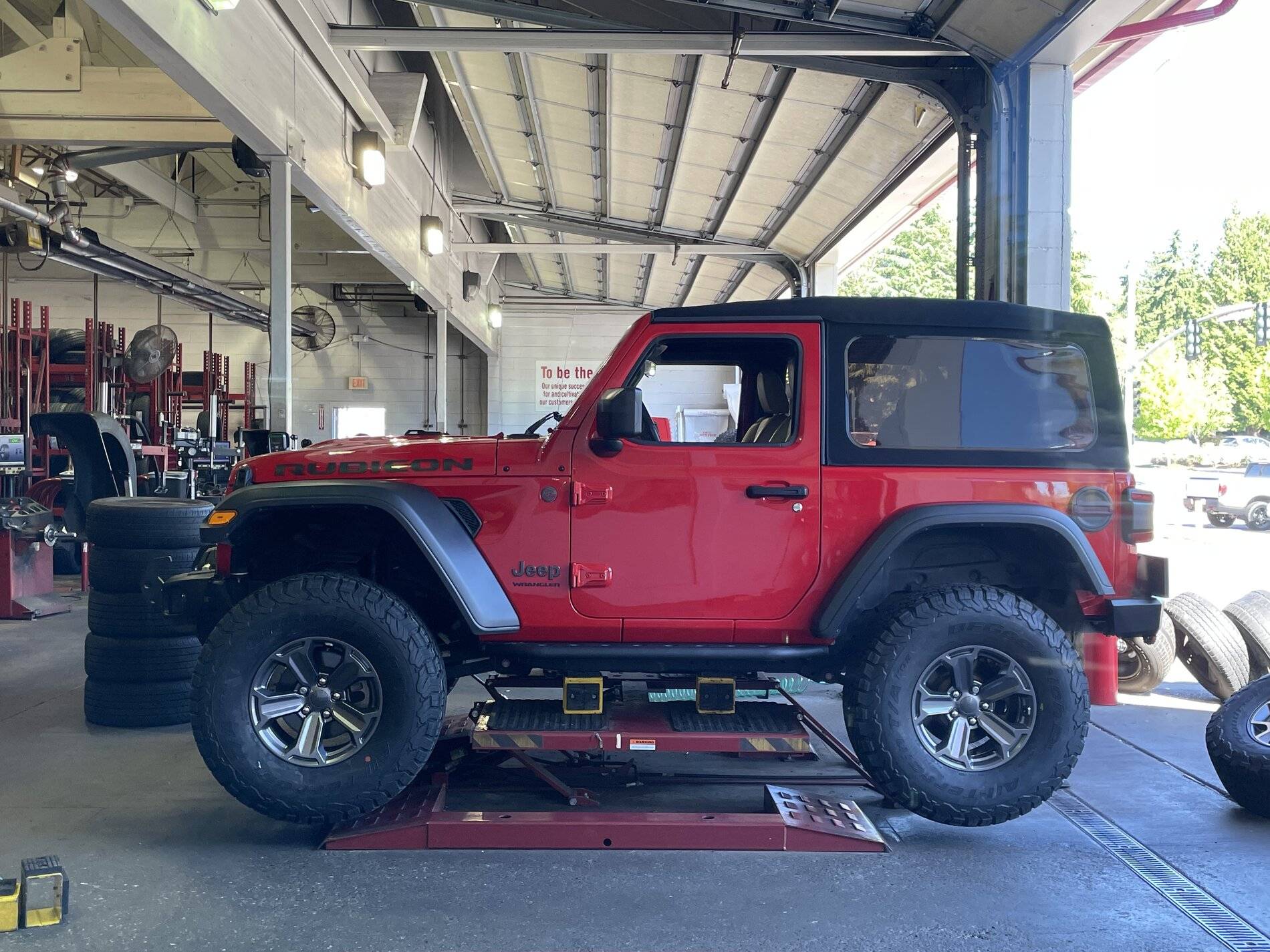

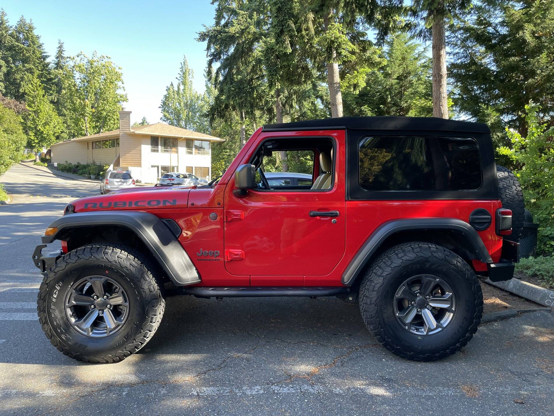

Here are the 37" KO2 Load C mounted! On Quadratec Recon wheels. They're pretty much the same offset/backspace specs as the Mopar accessory wheels.

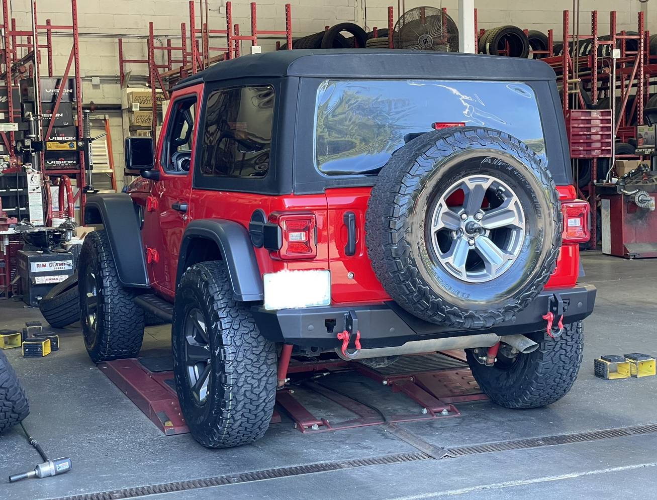

On the Discount Tire lift so I guess this is what a 3" lift might look like?

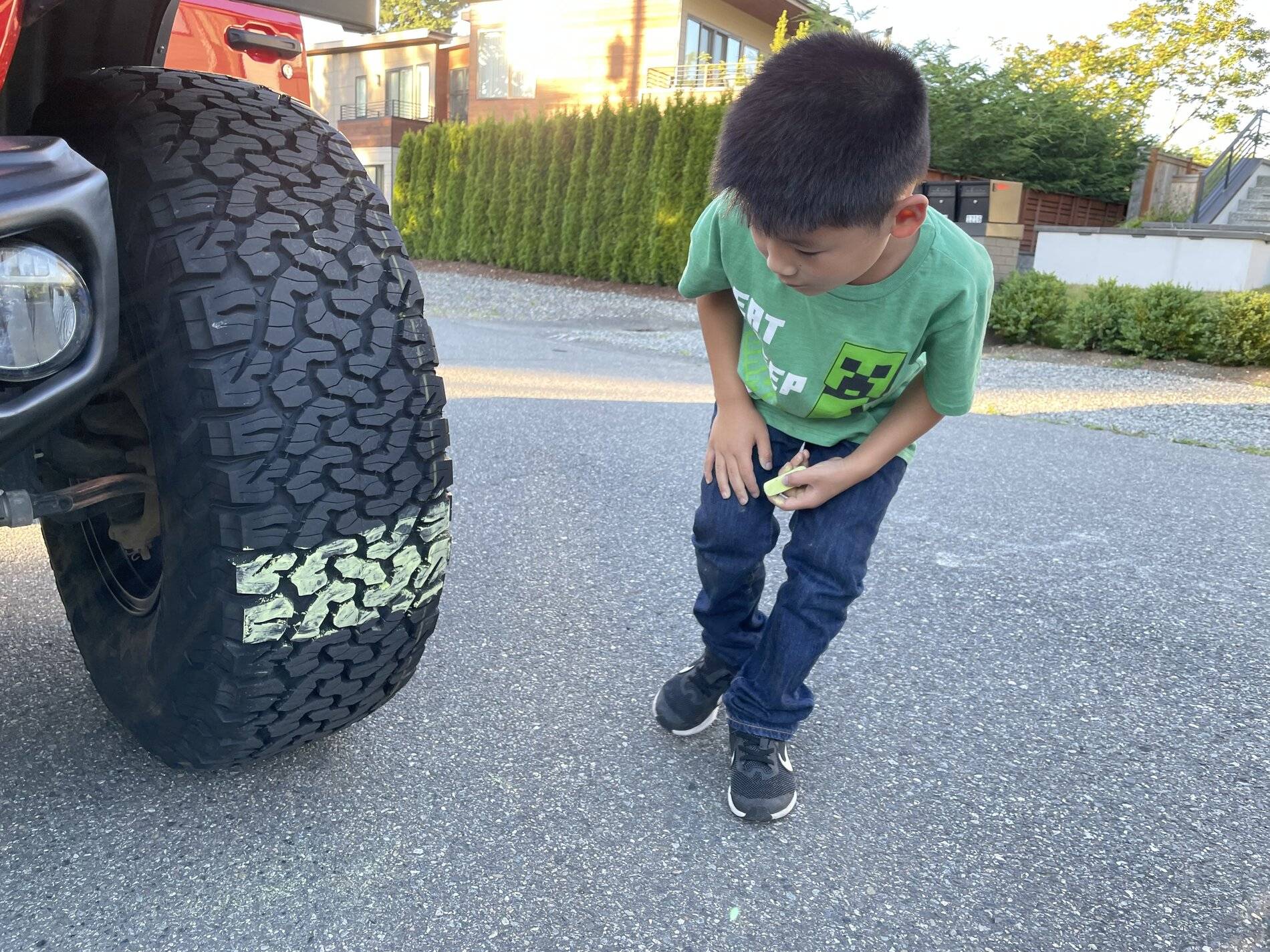

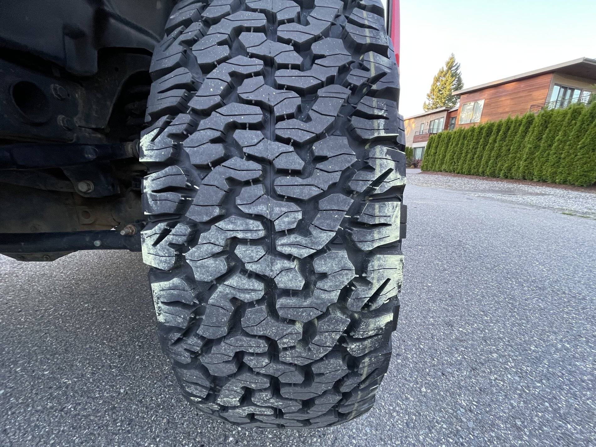

My trusty helper doing the chalk test. I got down to 24 psi and the edges are almost even. I don't think I'm going to drop any lower for now. Maybe my 2 door is just lighter. I think most 37" owners report between 25 - 30 psi. At 24 psi I'm seeing a height of 35-3/8". So basically these are legit 36" tires. If they just marketed as such I think everyone would be happy. :giggle: That's the sweet spot for me.

RubiRed, that is GORGEOUS! Are you running any sort of lift or is that bone stock aside from tires/wheels?

What were you running before and how is the road noise and handling? Any major differences?

Thanks Smoke 'Em! I was pretty much bone stock 2 door Rubicon with factory suspension and 285 KO2. Mainly added metal bumpers and winch, see everything in my signature. I've barely driven 10 miles on them so no deep insights. But let's be honest it's not going to be much different than the smaller KO2 I came from. With the taller sidewalls to absorb things it does feel more plush going over speedbumps. I haven't taken hard turns yet but I imagine the tradeoff is slightly more roll in corners.

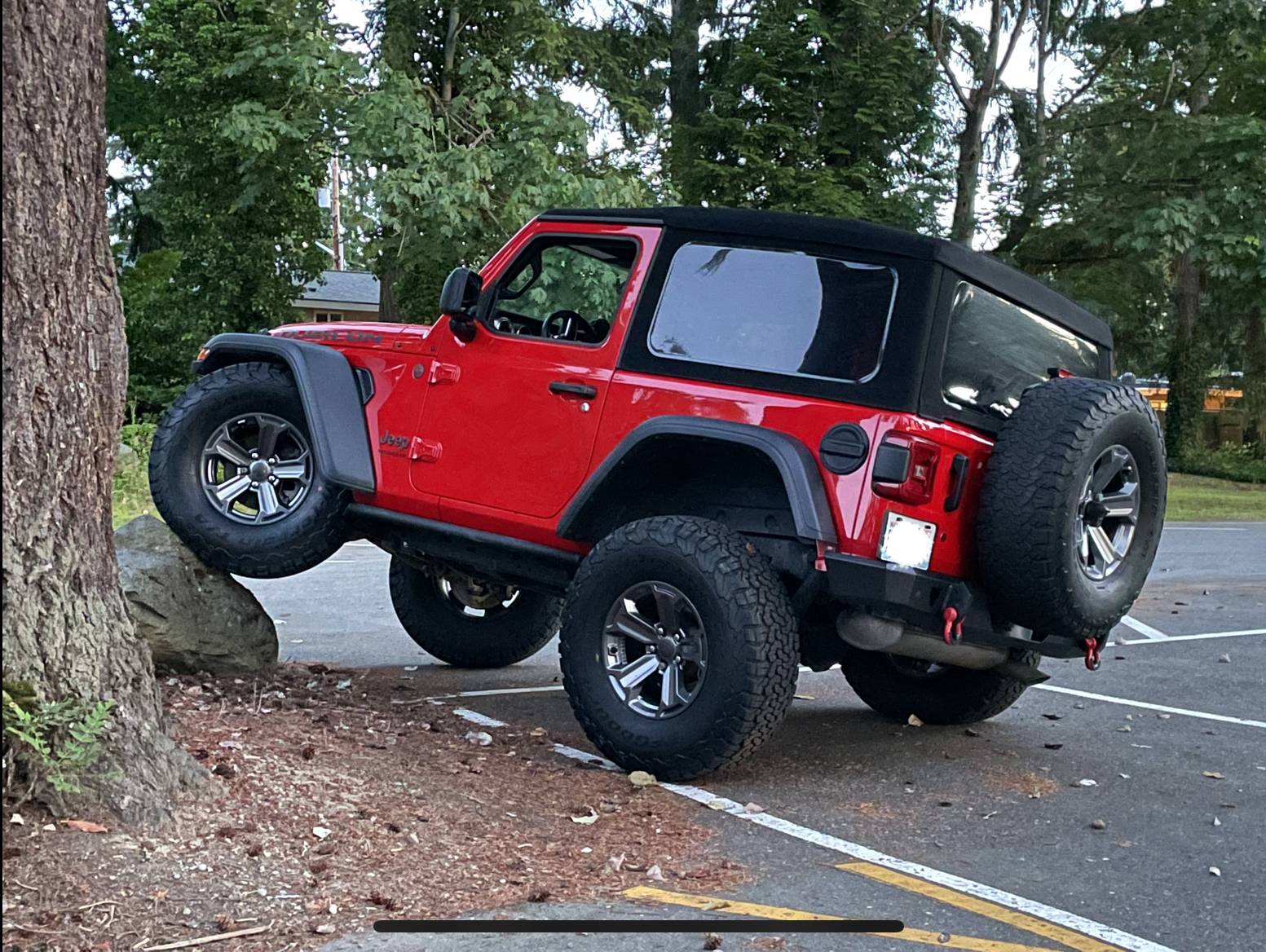

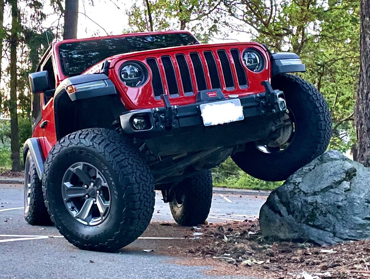

  • To satisfy my curiosity I took my stock Rubicon suspension out to get flexed. The front driver is pressed against the bump stop here. The front driver tire barely meets the inner fender. The rear passenger tire however does slightly press on a couple spots of the fender. My take: I'd be okay rock crawling with this light contact. But I would be worried doing high-speed dessert run as the sudden smashing when bottoming out could knock the fenders out. I'm still leaning to a small spacer lift but again it seems less urgent than I expected. It really surprised me it took on this much flex and almost got away with no rubbing. Note YMMV - I'm on 2 door Rubicon V6. Just about every trim level/engine/number of doors has different suspension setup or final ride height.

Looks good! Almost like a stock CJ7 on 33s.
