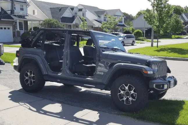

I would get some 17" wheels and 33" tires. I went out and found some new Rubi take-offs for my JLUS. Great for daily driving and I'll bet good for the beach too :)

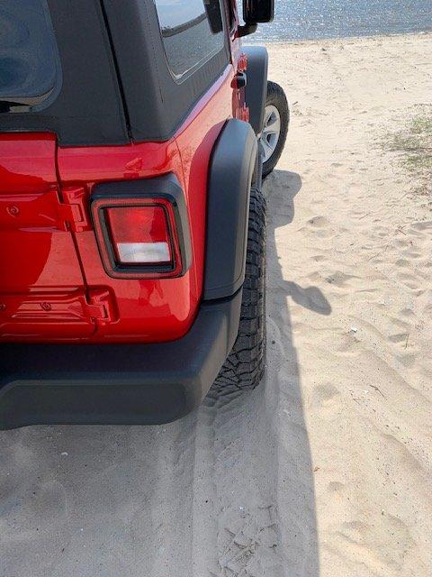

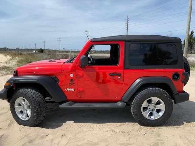

Mine is used mostly on the road and every now and then we drive on the beach. 285 70 17 (33") are a nice tire if you keep your jeep stock.. My wheels are 17 x 8.5 with +12 offset.
