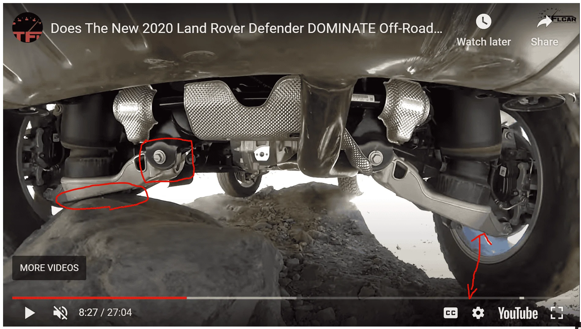

The new Defender got it done, but not without a lot of support. Rear lockers would have helped.
Lockers will give traction to move forward but the impact and the damage to the vehicle is always going to take place because of the independent suspension's lower wishbone which has low clearance.
Oval: Point of impact
Square: Point of failure even if skid plates fitted.
Arrow: Actual ground clearance.
Also note the other scuffs and dents.

The actual ground clearance thing is very interesting as most folks really praise the New Defender’s “stated” clearance.

Great illustration - nearly impossible to protect this set up. On our Jeeps the lower shock mounts can be vulnerable - but they are easy to protect...which I have.
It's the same BS about the approach angle... the New Defender's got less than half the height of the wheel exposed in the front and the bumper would hit anything taller well before approach angles mattered. In the JL the stock bumper starts well above the lug nut at the highest position.
Also in the JL you have the possibility to get one wheel over a rock or something with even greater clearance but in the Defender that low hanging plastic is always in front of the wheel to say "you have to be this tall... for me to get over".
Overall the new Defender is a shockingly poor design and is worse than a light offroader like the Toyota in that video.
