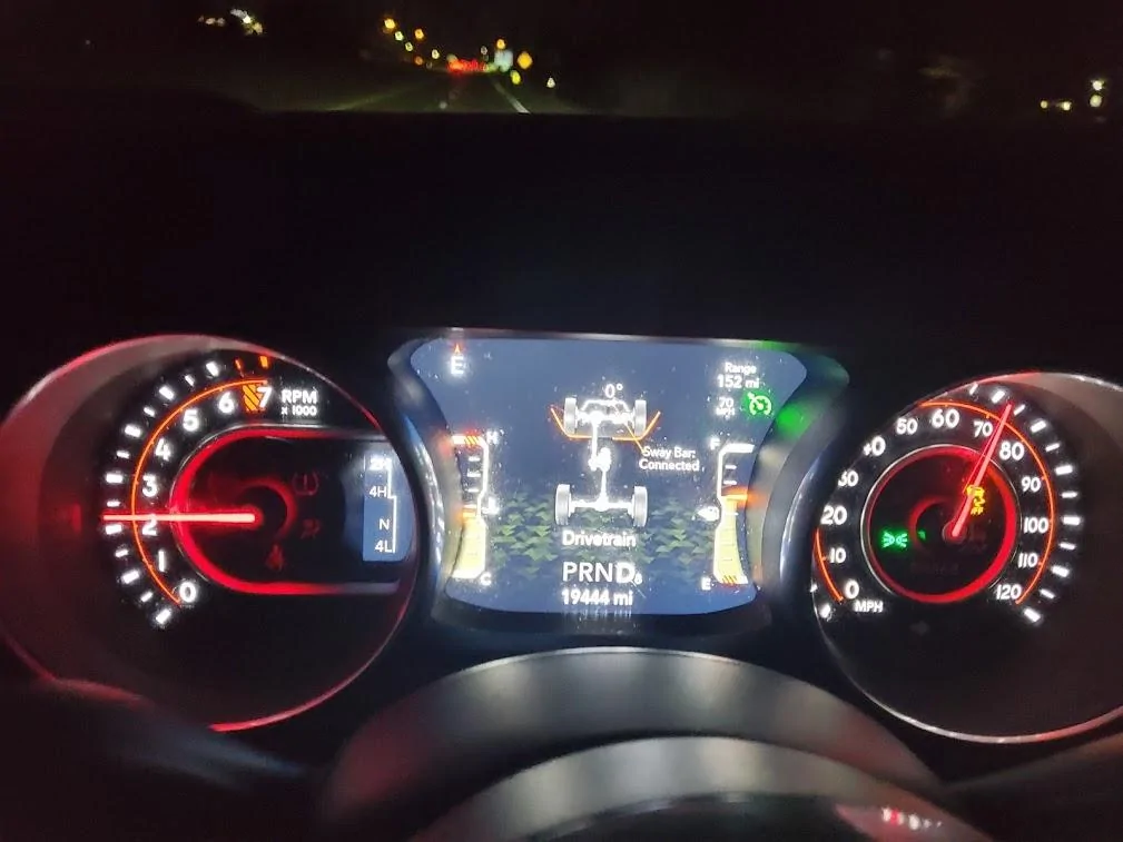

Do a search on the forum. There is a google sheet that allows you to enter the tire size and then shows you what RPM for speed. I went with 5.13 gears. This is a pic of my guages at 70 mph and the about 2100 rpms. Note I am on 37s.
