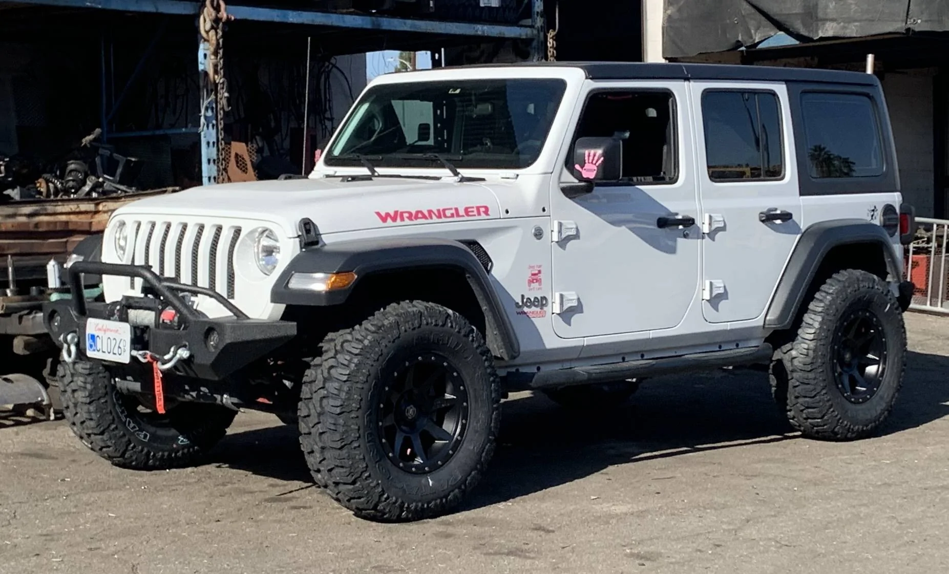

My wife has 2.5” spacers all the way around on 35s. Spacers, end links, and shock extensions. That’s it, everything else is stock. Been riding that way for 6 years now with no complaints. She’s got 3 badges along with several other trails under her belt. Might be an option for you as well.
