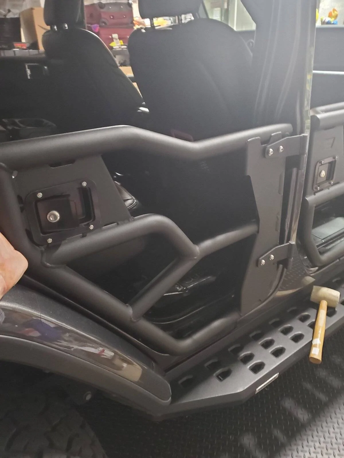

Post a video please? It may help others diagnose the issue for you. I am not the most technical but a lot of people here are so your video could help a lot more.Yall im gonna scream. Tell me what brain farts im having bc i cannot get the rear door lock to meet the latch. Its not even close!
If the hinges are adjustable shouldn't they be all the way down, moving the door upFyi the lock is way to low on the tube door and i have the door hinges all the way up!
this is most likely the issue, have the doors been installed before?Looks to me like you got a bad door. Best I can tell from the pics, there’s no way in hell you’re gonna have enough adjustment anywhere to move the latch that far.
Nope. Just got the 4 doors. The front two were fine. But i have the hinges completely loose and they will not get even close. I was hoping i did something wrong but im thinking the locks are the wrong ones.this is most likely the issue, have the doors been installed before?
at least you figured it out!Checked the box... correct doors... checked the lock boxes... labeled DS and PS. Yall.
Yall.
The locks were labeled backwards!
Took them out , swapped sides... put PS on the driver side yadayada and it works.
So. Know anyone installing warn jl tube doors.... tell them to swap sides if they have the same problem!
Here you go. Handles probably labeled wrong from driver to passengers.Yall im gonna scream. Tell me what brain farts im having bc i cannot get the rear door lock to meet the latch. Its not even close!
