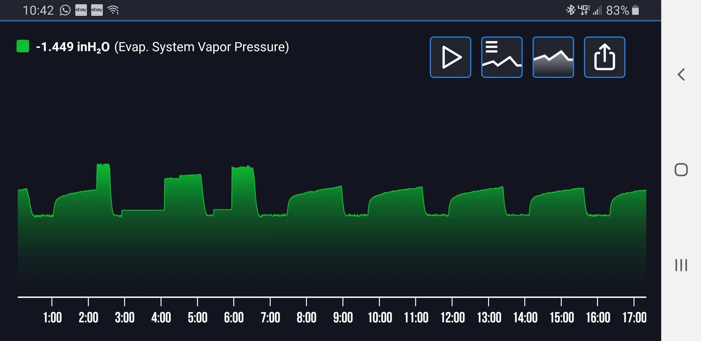

Trying to solve a P1CEA code on a 2020 JL with 4 cyl turbo.
Does anyone have insight into what this EVAP system pressure graph suggests? Looks to me likes its in a test loop pulling down to a -3.0" H2O vacuum and then checking to see if the vacuum is held ... and its not? I opened the gas cap at the 2 minute mark and you can see vacuum goes to 0. Does anyone have a evap system diagram with hose routing etc?
