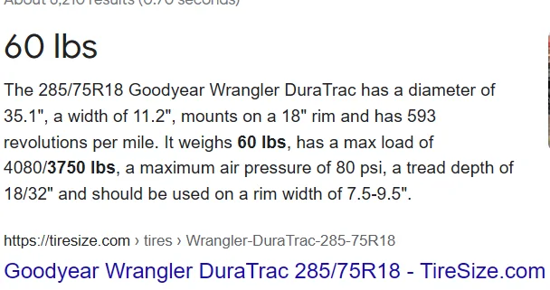

The winner here is 35x11.2R18 Duratracs, weighing in at only 60lbs. Which is what the stock rubicon tires weigh.

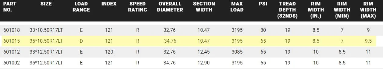

Kenda makes a 35/10.5/17 tire in both an RT and MT configuration. The RT is a pretty aggressive tread for an on/off road tire AT type tire.
I am also looking for narrower 35s and was sort of excited about these Kendas. However, I read at least two posts on a JK forum that these 35/10.5r17 Kendas measure true at 33.5" to 33.75". However, a Walmart review I stumbled upon said "true 35 inch". I am confused. Not sure if you, or anyone else knows the actual height of these.
Per the manufacturer, the 35x10.5r17 measures 34.76" diameter by 10.47 wide. It's typical for a "35" to be slightly under 35 inches, and these don't seem any different. Definitely not under 34" inches though, which these apparently aren't either.
Thanks for confirming.
Also, after my first post I stumbled on a Tacoma world chat thread on these Kendas that had an actual picture of the 35s against a measuring tape with level on top. Shows ~34.75" which is more what I would expect a 35" IRL to measure and is what you say the manufacturer cites.
