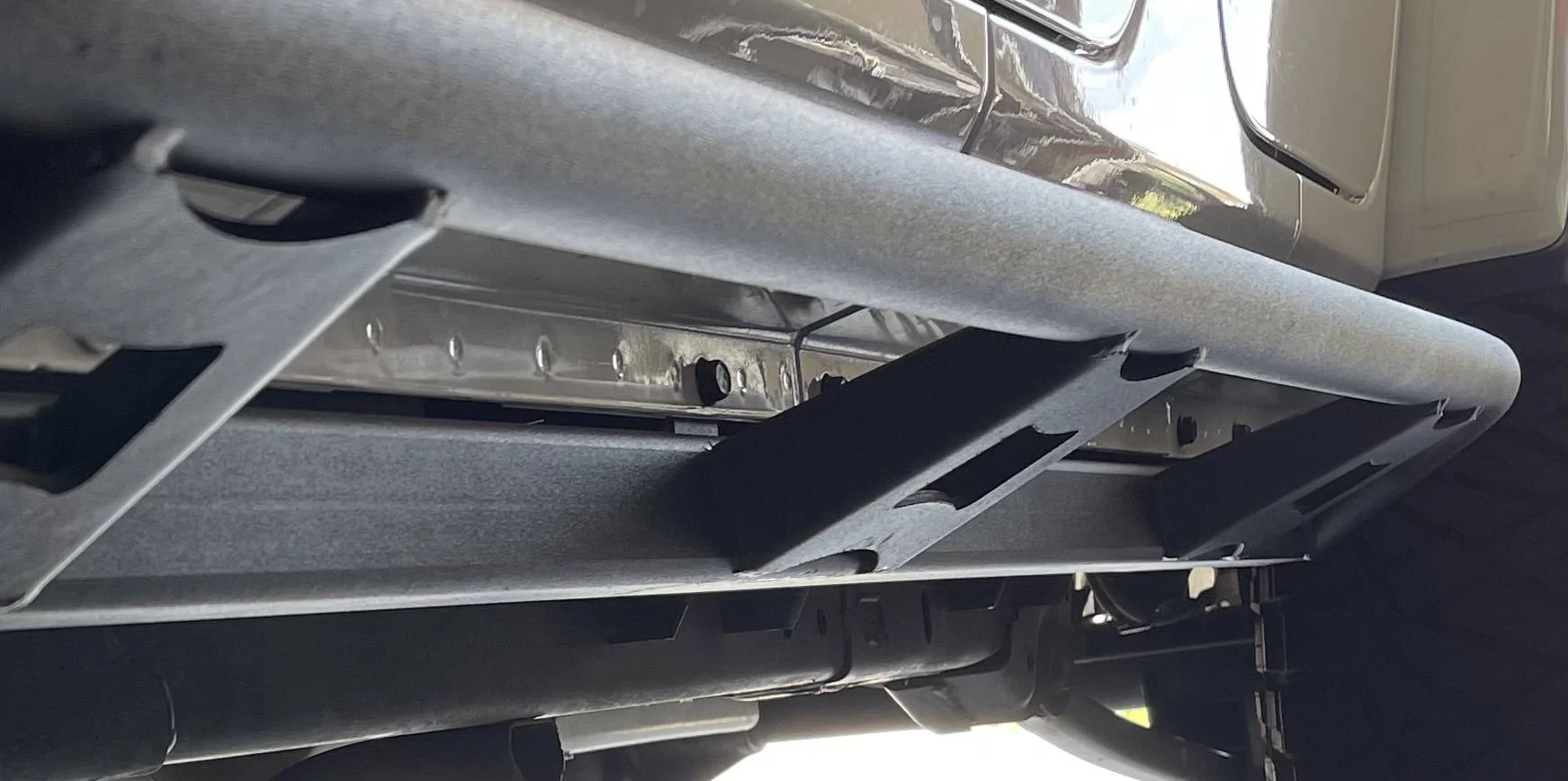

These are not frame mounted. They are body mounted. The mounts go behind the pinch weld, thus you see the bolts and seams of the exposed pinch weld. I ordered the hammerhead pinch weld protector for extra strength (installed pictures coming up soon). No clue as to how it holds up for sliding… pretty solid construction in my opinion… personally I prefer the body mount vs frame mount. I did not want to drill the frame or mess with the body bolts…

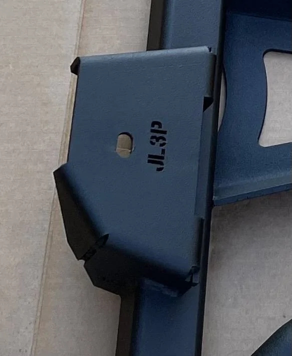

This trapezoid sits nice and solid behind the pinch weld. The 1/4” square tube sits lower than the pinch weld and protects it.

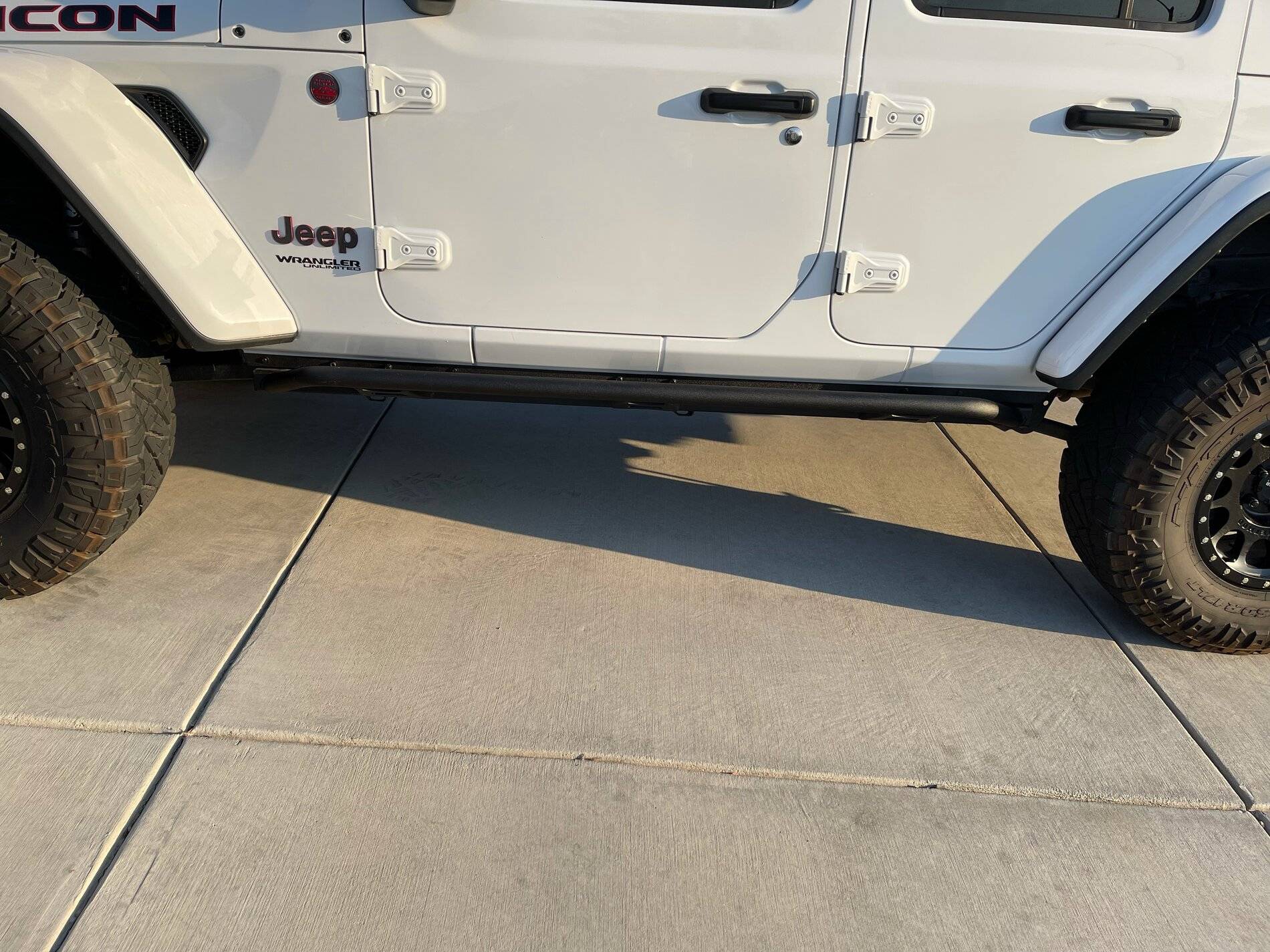

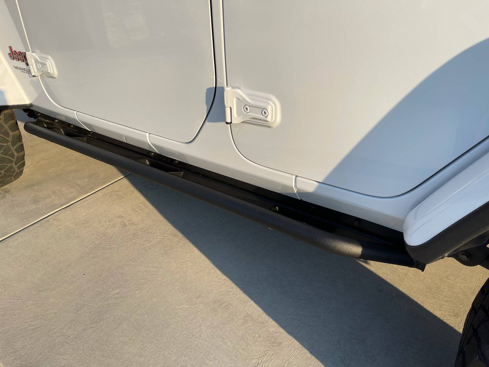

NFab Tail slider Side Steps install finished with Hammerhead pinch weld cover:
