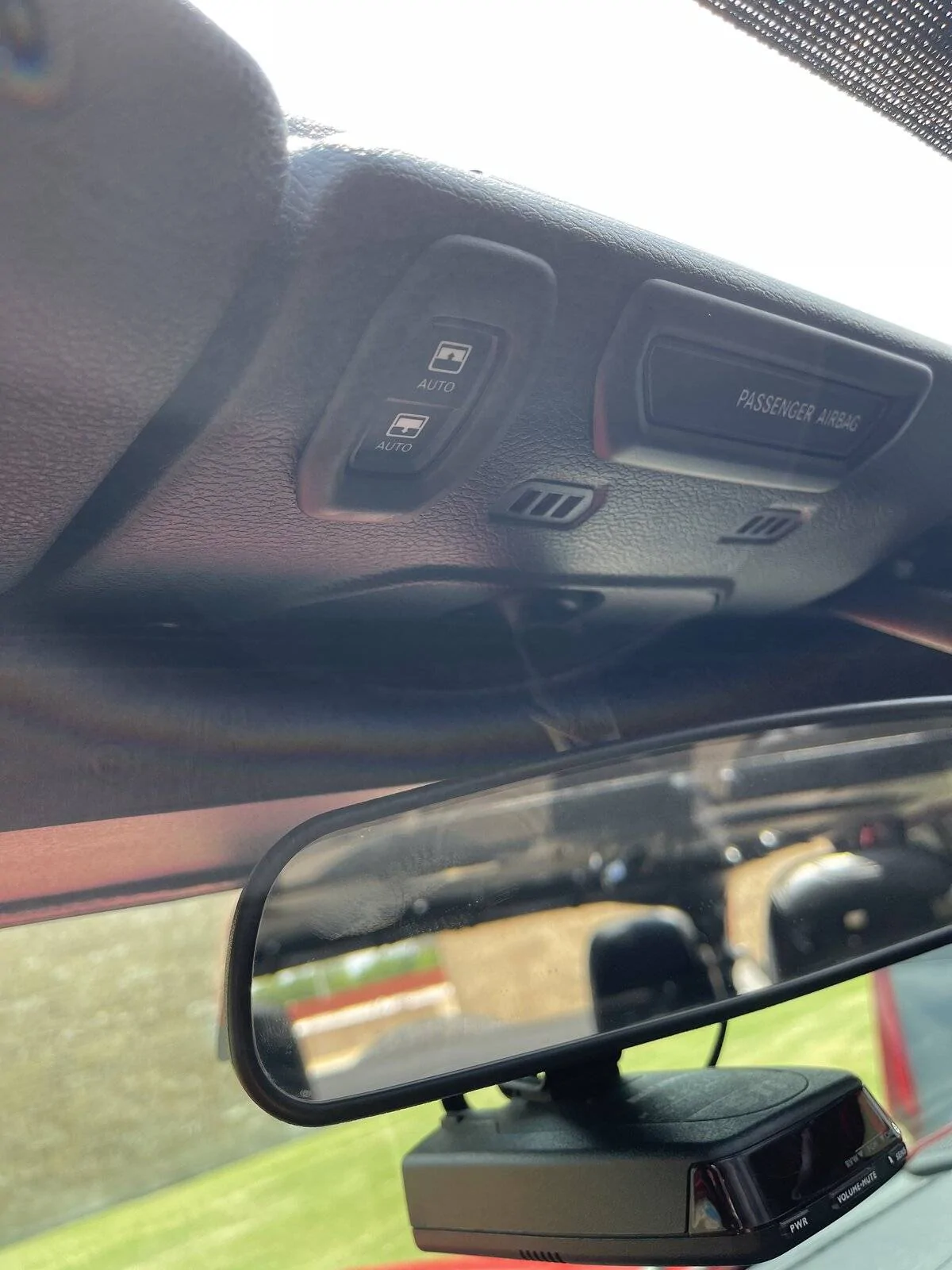

It took me about 4-5 hrs but that is also being very meticulous with the wiring. The directions get about a 7-8. I watch several videos and the install is very straight forward once you get into it.If you don't mind, How long of an install was it and were their directions to do so adequate?

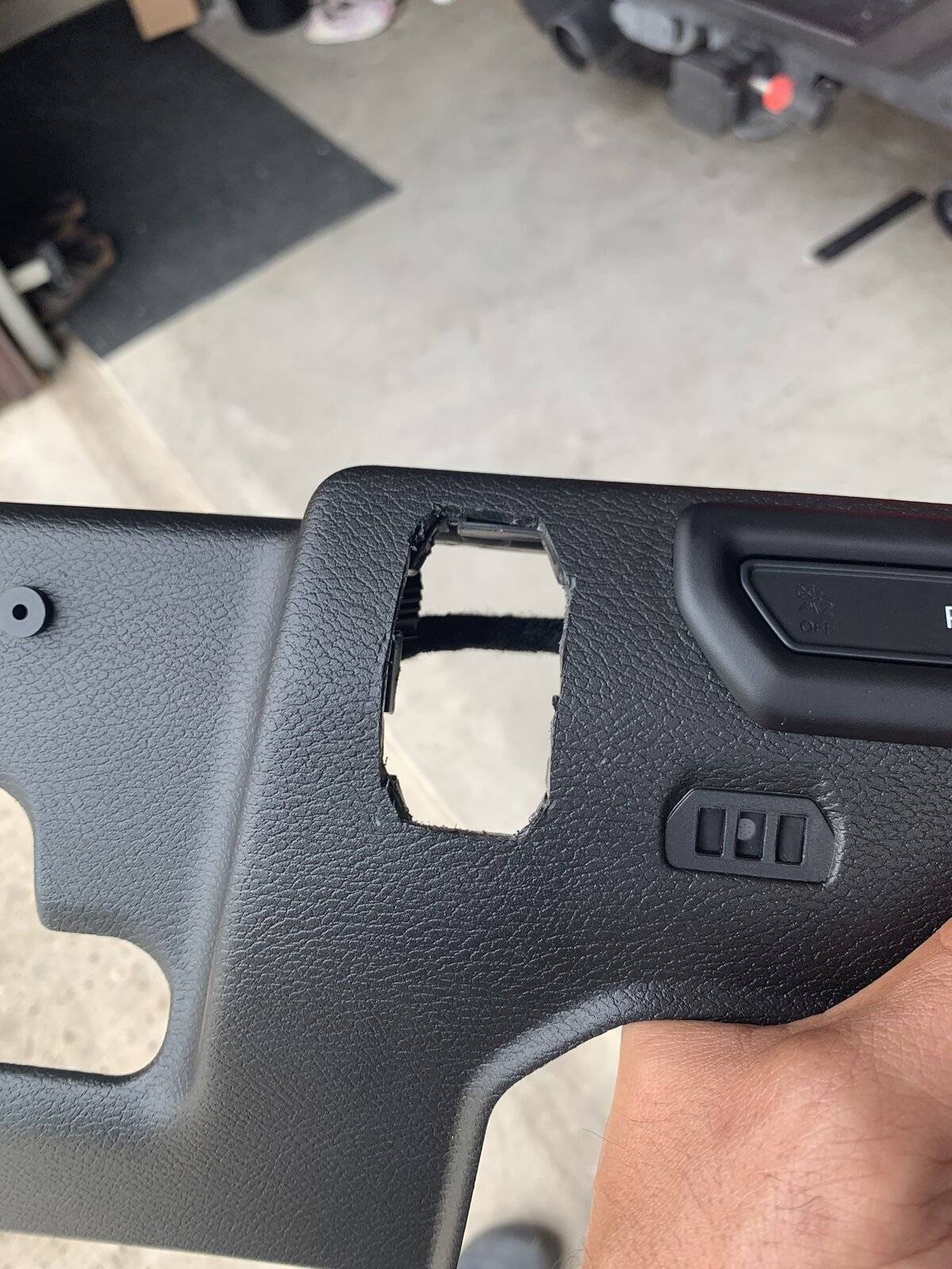

You have to cut the trim but at leat in my 2018, there is actually a template on the plastic as I assume the mold is used for all trim levels. You cant change to the one touch trim as it does not have cutouts for the clamps (I learned this the hard way and now own a trim piece that I cant use... LOL) I used an exacto knife and carefully cut thru the trim and just kept trying the switch until it fit. The fit is good but not 100% perfect but noone would notice outside of yourself... I'll upload a pic I took just gotta find it...In case anyone is interested, here's the exact link:

Fonzie, thanks! Were there any other trim bits you needed to make it look that clean or did the switch come with everything?
