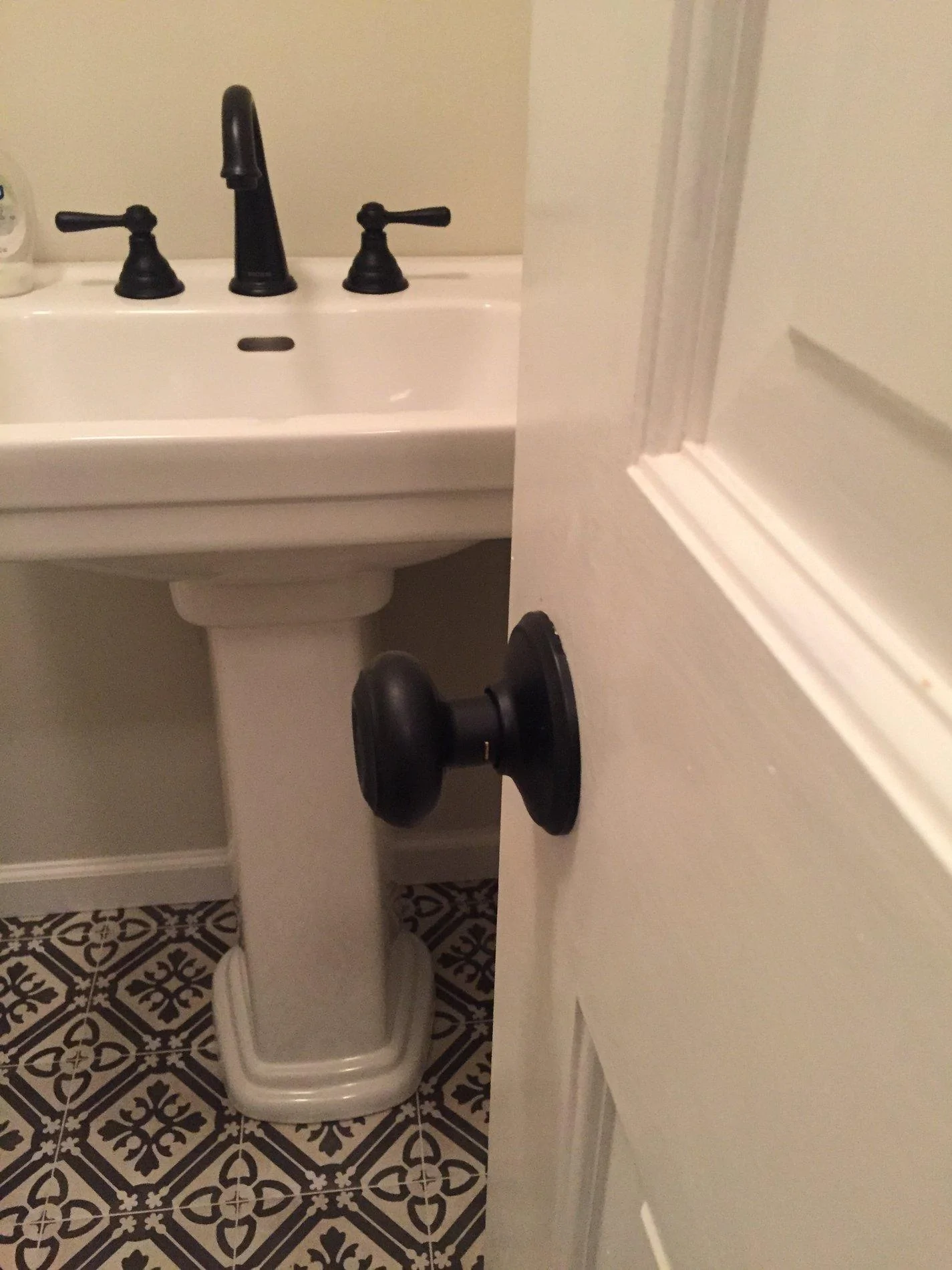

I discovered, tonight, that my new house (built in ‘83) has 1 5/8” doorknob holes. I never knew there was such a thing. What a PITA.

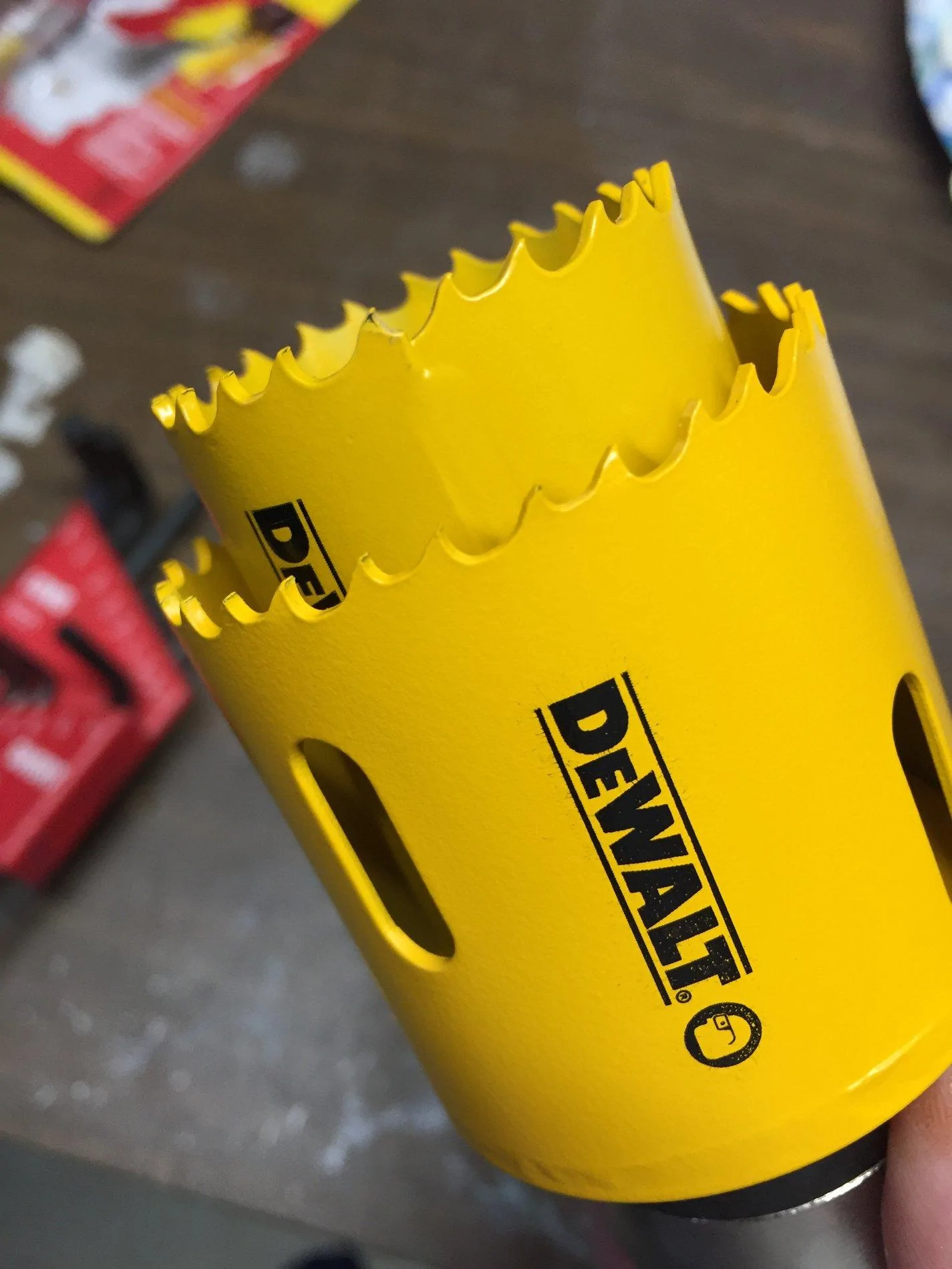

Anyway, I just ordered an “oops arbor” to (hopefully) make enlarging the holes to 2 1/8” dummy proof (I’m the dummy who will be taking a hole saw to my doors so we can have pretty matte black knobs).

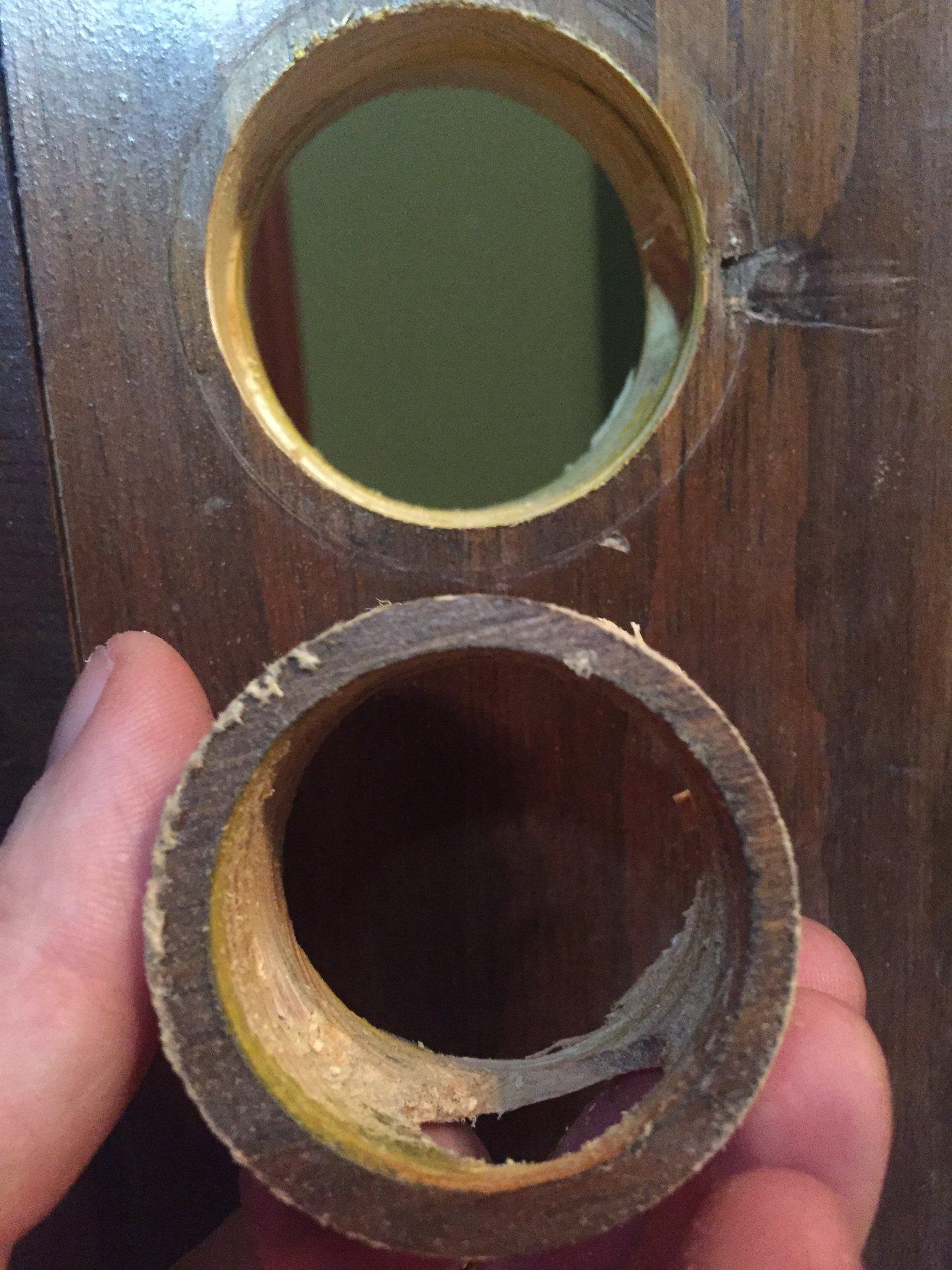

Alright, no one replied so nobody cares... nonetheless, here’s my update. Maybe Google will bring some home repair DIY guy here and he’ll decide he needs an oops arbor and a Wrangler. :rock:
In a nutshell, this tool is ingenious. It was DEAD SIMPLE to enlarge a 1 5/8” doorknob hole to 2 1/8”. (You can do any size holes you want, those are just what I needed.)
10/10 recommend this thing (along with a good quick release mandrel).
