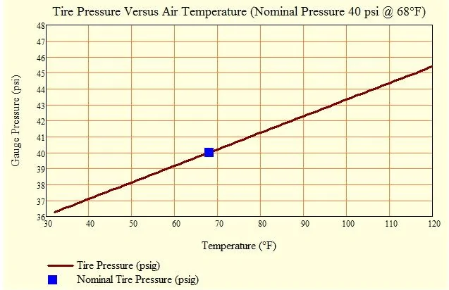

Tire pressure increases/decreases about 1 PSI per 10-degree F ambient. In addition the tires heat up as you drive. You can see a wide variance of tire pressure on any given day.
You'll find folks on here that say anywhere as low as 30 PSI works well. Dealers tend to over-fill (over 40 PSI in many cases). I run at 37 nominal and am happy with that.
I even notice that the tires that are in the sun will be 1-2 PSI higher than the tires on the other side.
