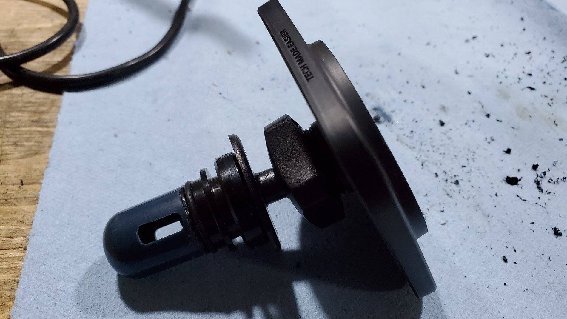

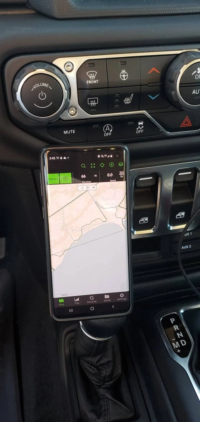

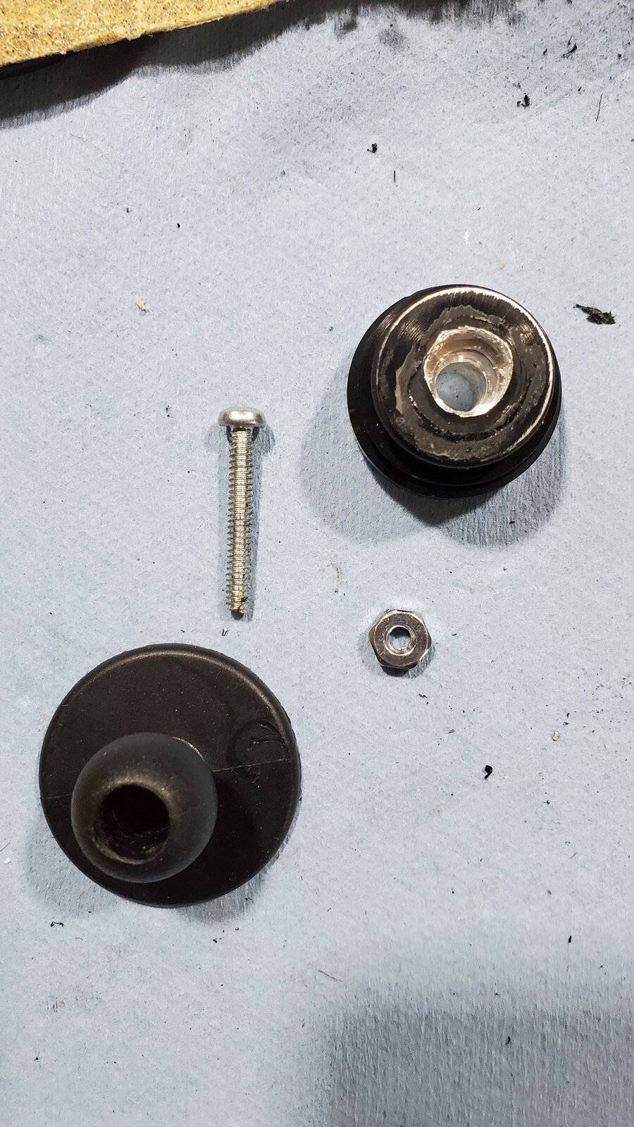

So after not seeing any mounts I liked I figured out my own.
I used
a 12v aluminum plug
Part of a a 12v usb charger I cannibalize
A ESR halolock magsafe mount
A halolock magnet for my phone case
So I drilled a hole threw the 12v plug and made a countersink to holed the nut
12v usb plug I cut off to extend the plug (I tired just the plug but the weight of the phone would pop it out so I extended it into the socket using part of the 12v usb charge shell)
Put it all together
And mounted
Works great.
