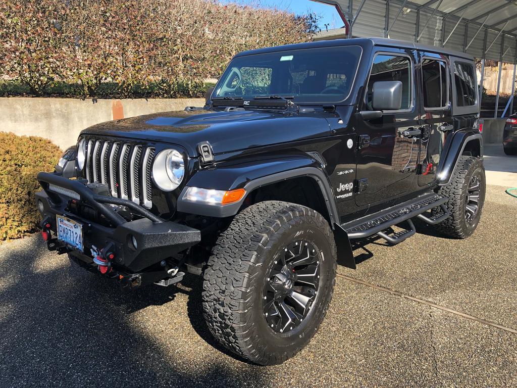

RoKBlokz Front XL's Installed
I have 35's X 12.5" KO2 Tires, my Fuel Assault wheels 18x9.5 have a 4.7" offset so they stick out beyond the fender 2"-3". Living near Seattle I can wash my Wrangler and after a light rain or even a puddle it looks like I was off road as the wide wheel and tires throws dirty water along the entire side.
Quality is just OK they are plastic that seems to scratch easy with my fingernail so we will see how they look after a while. The Hardware for the fronts could have been a little more robust. The problem is when you remove them for offroad the bottom of the fender liner will not be secure as you had to remove the factory pushpins and the Rokblokz bolts that go through the push pin holes stay with the flap when removed. This may or may not be problematic.
One final note on a black Wrangler they just blend in, they do not look out of place at all, however they may stand out more on other colored Wranglers, however they do also make the Flaps in different colors.
Other than price I am very pleased with them and look forward to fewer washes.

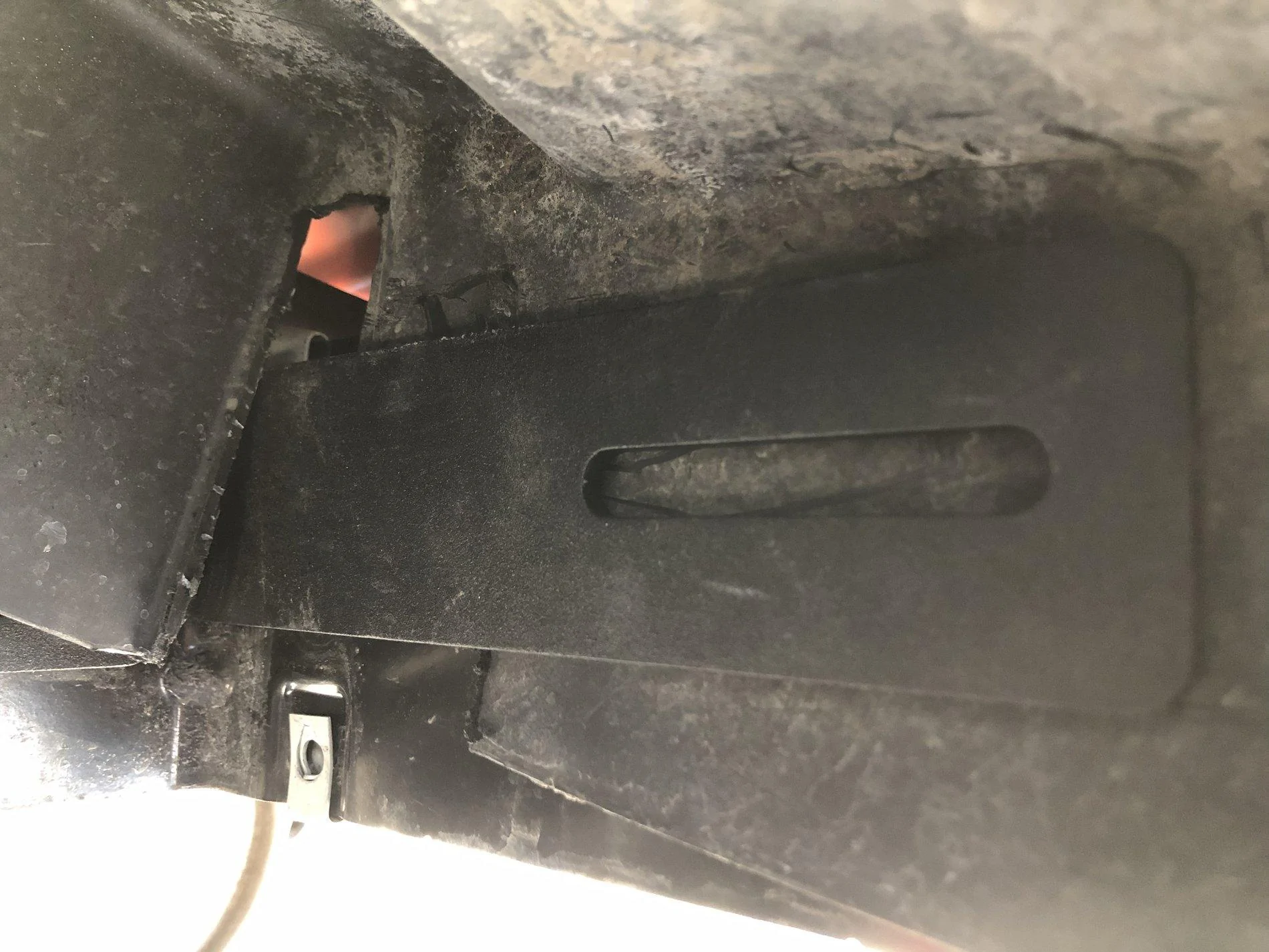

It's that metal on the back that I am curious about. The web page says they are easy to remove for off-roading but they show no pictures of it.
The rears have a metal plate you install to the inside of the fender then the flaps attach to that flatbar. The fronts use exiting holes (3 of them) that the flap screws two/through, easy install takes just a couple minutes,
you can see the three connections here. Look at your fender well and the two lowest push pins and one on the lower inside are the three connections

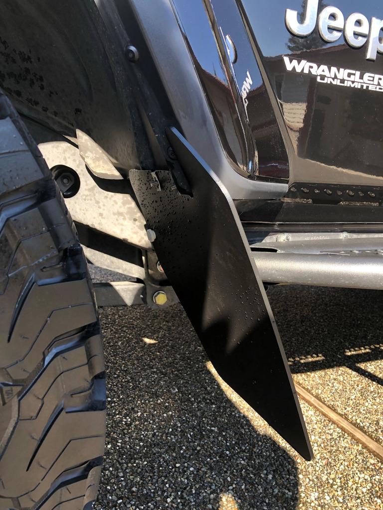

@Luis Angel Reyes I am stumped. Can you help? I can’t figure out how to get from here to actually getting the flaps installed. I cut the liner as I saw you did, but I can’t get the flaps to slide over the bracket as part of the liner is still in the way. I am missing something and I am not very smart.
Geos7812,
I was able to install my driver side mud flap when cutting the lower fender liner the same way you did but it was a tight push to get it on that bracket. I lined up the bottom corner of the opening in the mud flap with the bottom corner of the metal bracket and got it started, then I pushed the flap up so that the rest of the slot went over the bracket. Then I pushed it in.
Were you able to slide the bracket in to the flap before you mounted the bracket? The instructions say to leave a couple of the screws less tight than the others so it doesn't bind. I was able to tighten mine down and was still able to get it over the bracket though.
Also, even though I was able to get the flap installed with cutting the fender liner as you did, it was not perpendicular to the ground. I ended up removing the fender liner and cutting a slot about 3/4 of the way from the outside edge towards the inside edge to allow more room for the flap to be inserted.
For the passenger side, I was unable to place the flap on the bracket at all until I cut the slot from the outside edge towards the inside edge. It took me quite a while and several attempts to get this to work. Mine are installed and I don't want to pull them back off right now to take pictures because it took me a while to install them.
Having said all of that, I feel pretty good about these mud flaps now because of several reasons:
1. They look pretty good to me. The angled portion at the top outside edge matches the JL body lines well in my eyes.
2. I was able to reinstall the lower fender liners so that mud/salt is no longer being flung up inside the wheel well and rear bumper. Without that liner, one edge of the lower body panel is directly in line for rocks to strike it behind the rear wheel.
3. I chose black on black. Although I can see the RB logo if I look for it, it isn't even legible from a few feet away and the color goes well with the black unpainted fenders. I have Punk'n paint and I really didn't like the way the orange colored flaps looked on the sample photos on the RokBlokz website.
4. The flaps prevent much of the splash I was getting up the side of my doors. I also feel like the rear window doesn't get as much road spray while driving on wet roads. My 2 door really did send a lot of spray to the rear window without the mud flaps and I "feel" like that issue is improved.
I have the standard sized flaps on a 2019 Rubicon with factory tires and no lift. The flaps are probably less than 1 inch wider than the tires. The fronts are not adjustable and I have the rears adjusted to match the fronts, with about 1 inch of the slanted area at the top inside the fender flare.
