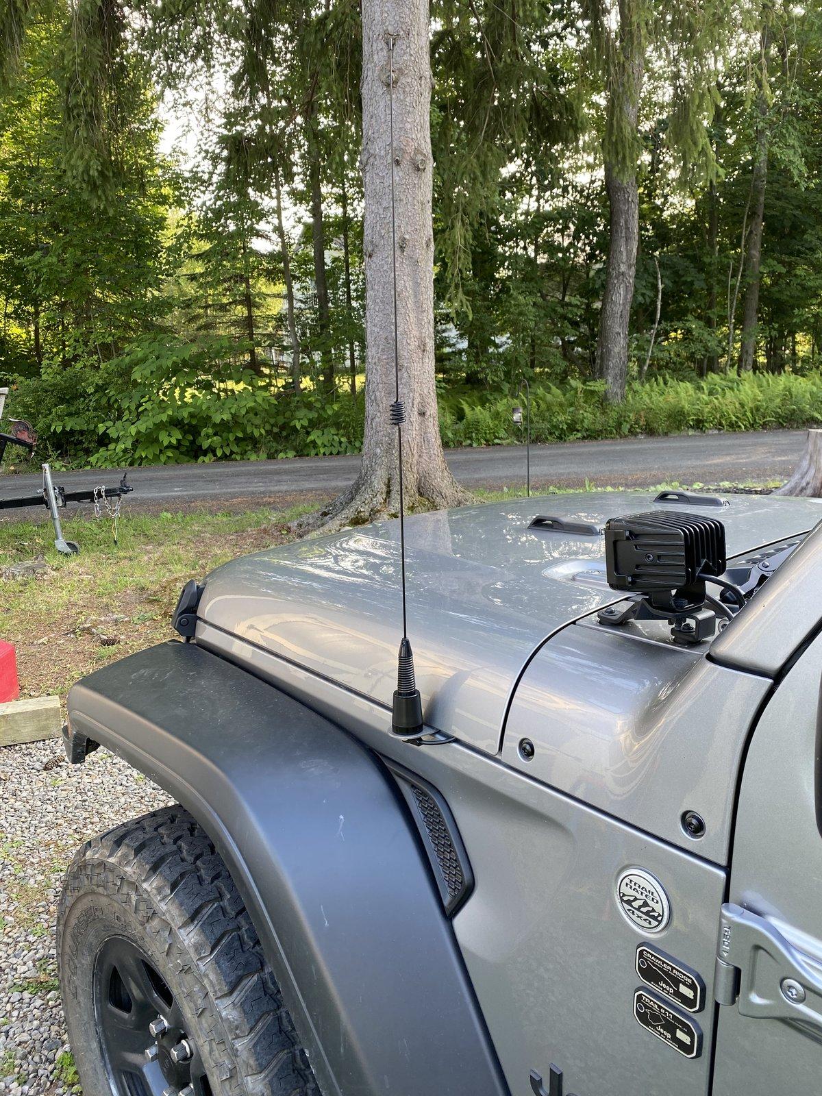

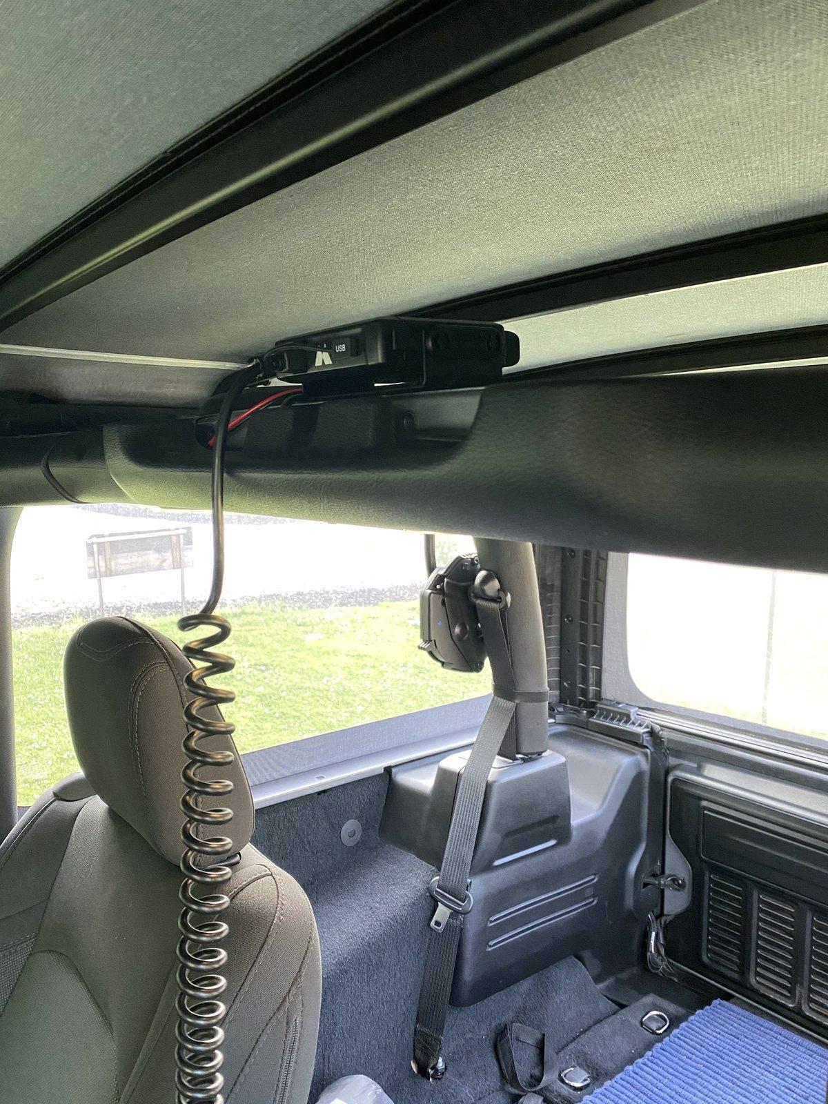

I didn’t think about taking pictures until after I was all done and put everything away! I’m running a midland mtx275, 6db antenna , and a Topsy products NMO antenna mount. For right now I just have the box mounted to the top of the roll bar with Velcro until I get my molle platform solutions rack in place. I ran the coax under all the panels on the side by the door and then removed the panels going up the roll bar and put it behind them. Made for a very clean install. No wires are visible at all.
