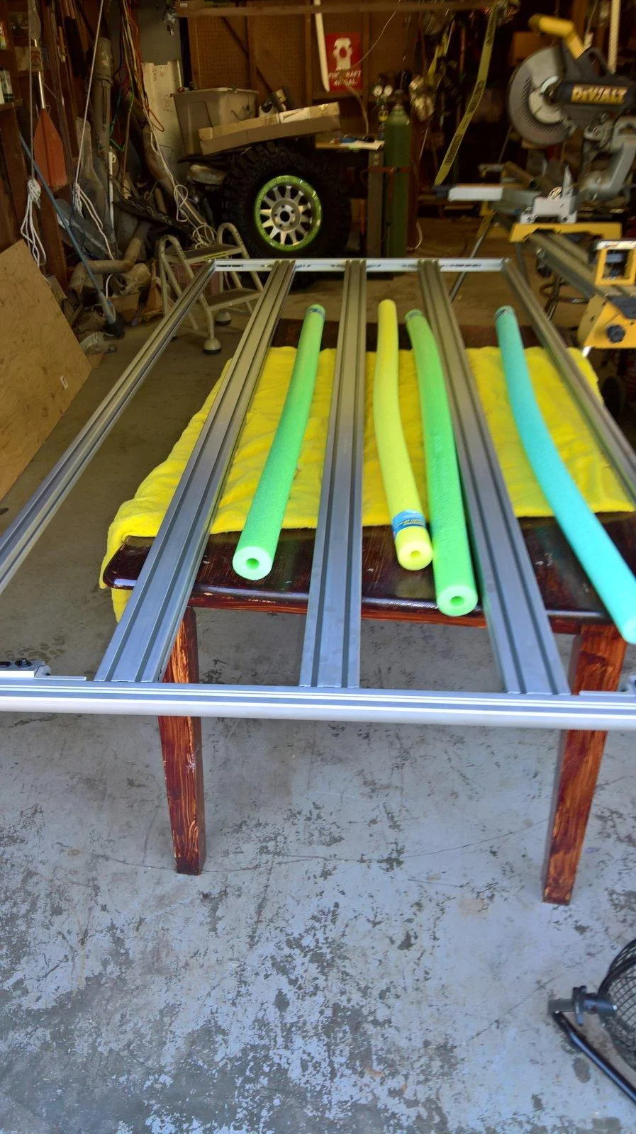

Yeah, I had the same issue... light weight stuff and a soft top... There is no way to place any load on the soft top, it will just get ruined..
Your only choice (that I know of) is to pay the big bucks or build your own, to your own specs..
No matter what there is no easy answer for us soft top guys.. I researched it for months and I was not happy with anything on the market.. most of the racks were way to fancy - costly for the basics I wanted.
I just finished mine and it was a couple weekends of effort. But I am happy, I can place, bags, camp gear, Kayaks and I can change the configuration at any time.. no welding (8020.net T-slot)..

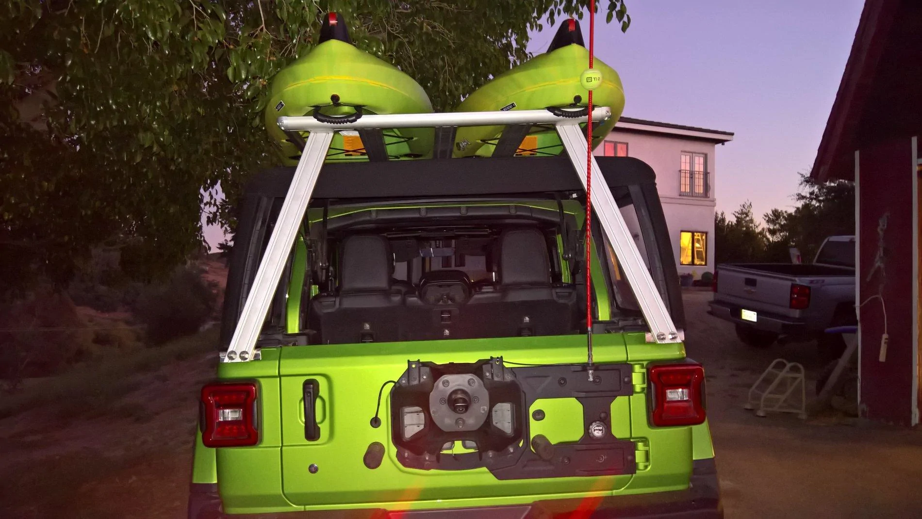

Wow that's awesome. Can you share a few pictures of how it's mounted?

Impressive! What do you do when you want to take the top down? Does it easily fold back? That's really my biggest issue with the racks.
I'm headed out to Cape Cod with the family and want the flexibility to be able to use the soft top as it's meant to be used! Down, Up, SunRider, etc. I actually have a hard top as well, and take it off in the summer time so can have full open air. The kids really love it.

Thanks and sorry for the slow reply, we just came back from Jeep Jamboree on the Rubicon trail.. to answer your question, yes it has a pivot point at the rear. currently I have not added quick connects, just 4 bolts In the front and the whole rack pivots back. I am debating to add telescoping poles to make it a platform - awning off the back after the pivot when camping.. vs using an easy up.. one less thing to pack I guess.. I am wrestling with that idea..
After putting 1200 miles ~ 70mpg on the I5 and 20 miles ~1mpg on the rubicon trail, it held up great, no issues, no loose bolts (blue locktite).. Functionally very happy.. I can say, I was the only rig with 2 11' Kayak's in Rubion springs out off 300 jeeps :) .. we had a great time using them there.. looking forward to doing it again.
One issue I am not happy with and I am not sure what can be done is wind noise.. The Kayaks make a lot of noise at speeds above 55mpg... if I cant figure it out, I may relocate the rack to my M416 utility trailer..
Hope that helps, more pictures coming..

Love your rack and the DIY ingenuity. Any details you can share on how you made and mounted it would be awesome and appreciated!
glad to help... https://www.jlwranglerforums.com/forum/threads/roof-rack-for-kayaks.33654/#post-781690
wind noise is an issue on all racks.. especially soft tops with kayaks ... but I love being able to through kayaks on in 5 mins and off you go... and I can confidently say the 8020 stuff held up to multiple trails including the Rubicon fully loaded (2 kayaks plus gear)… I have about 7k miles on it loaded at freeway speeds (70mph)..
