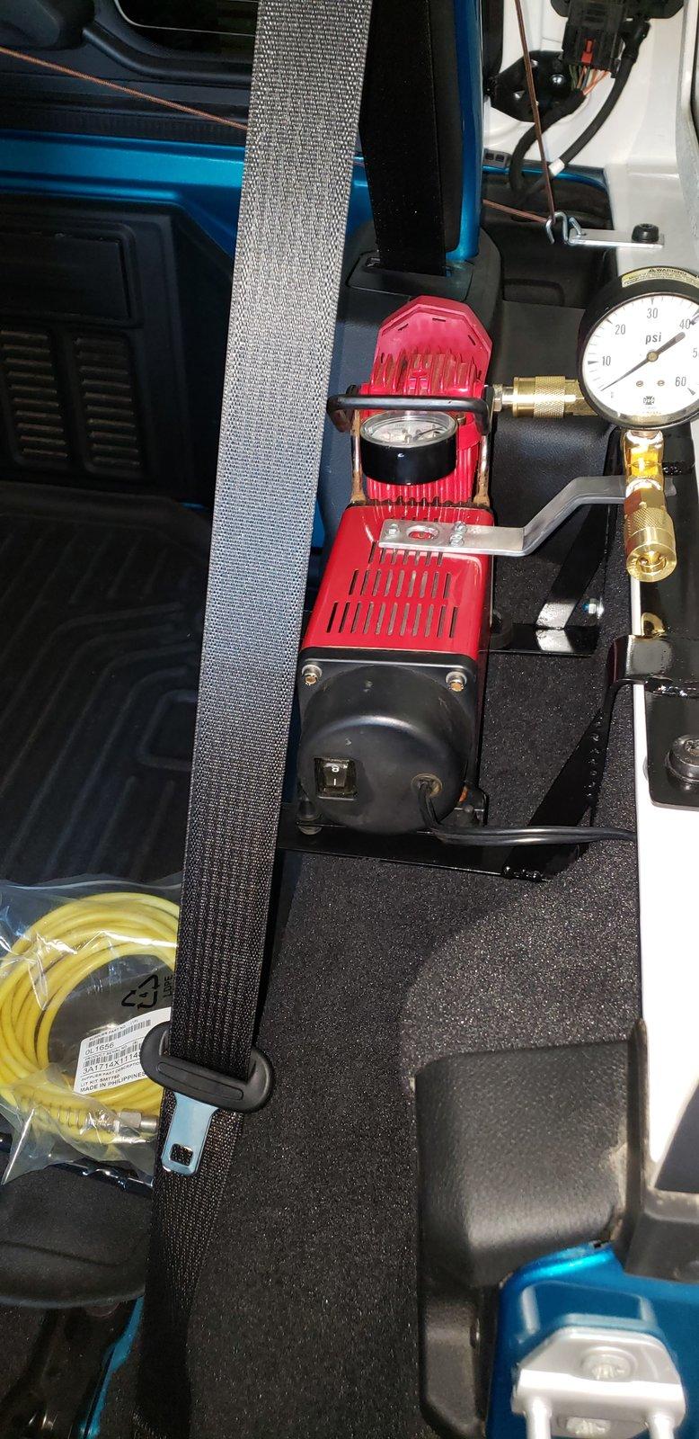

ARB, I believe, makes a bracket to mount their compressors in this location. I did not find any generic brackets so I made my own. Besides ARB wants over $100 for thier bracket.
The bracket is big enough for a larger compressor in the future. I ran an 8 gage wire from the battery, with 50 amp fuse at the battery. 30 amp fuse at the compressor. Should be plenty of juice.
