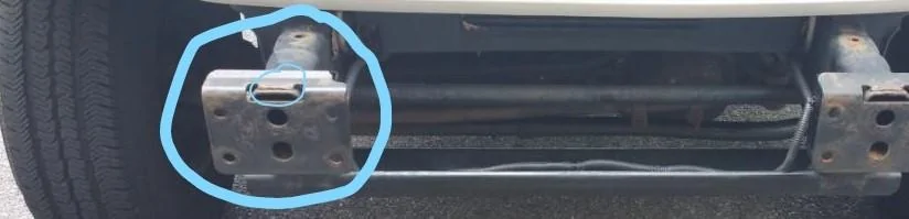

More pics as I go but here is my quandry: The bumper doesn't fit. I DON'T think this is a MB issue. The craftsmanship on this bumper is off the charts in a good way. In addition, I already powder coated it so I don't want there to be an issue with it :)

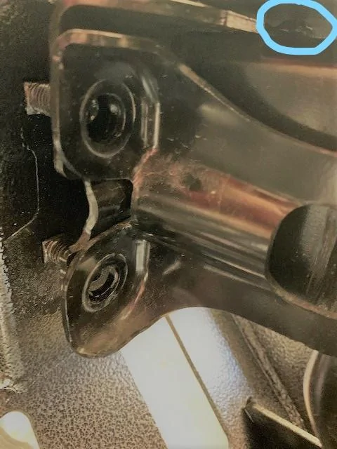

But here is the real data, the bumper rests just a smidge too high and the bolts won't fit. I noticed a gap and sure enough it appears the sloppy weld is the cause; the blop is high enough to keep the bumper from being flush. You can see daylight in the first pic.
The second pic is a better-welded bumper.
Do I:
1) Grind down the weld
2) Enlarge the holes (recommended only to 5/8")
3) Modify the bumper so it fits around the weld
4) Sell you the bumper (not gonna happen)

Need better pics of the weld to see if you can safely grind it down.

fair enough, I didn't notice the gap until later, when I checked out the pics. I'll tear it down again tonight and take better pics.
