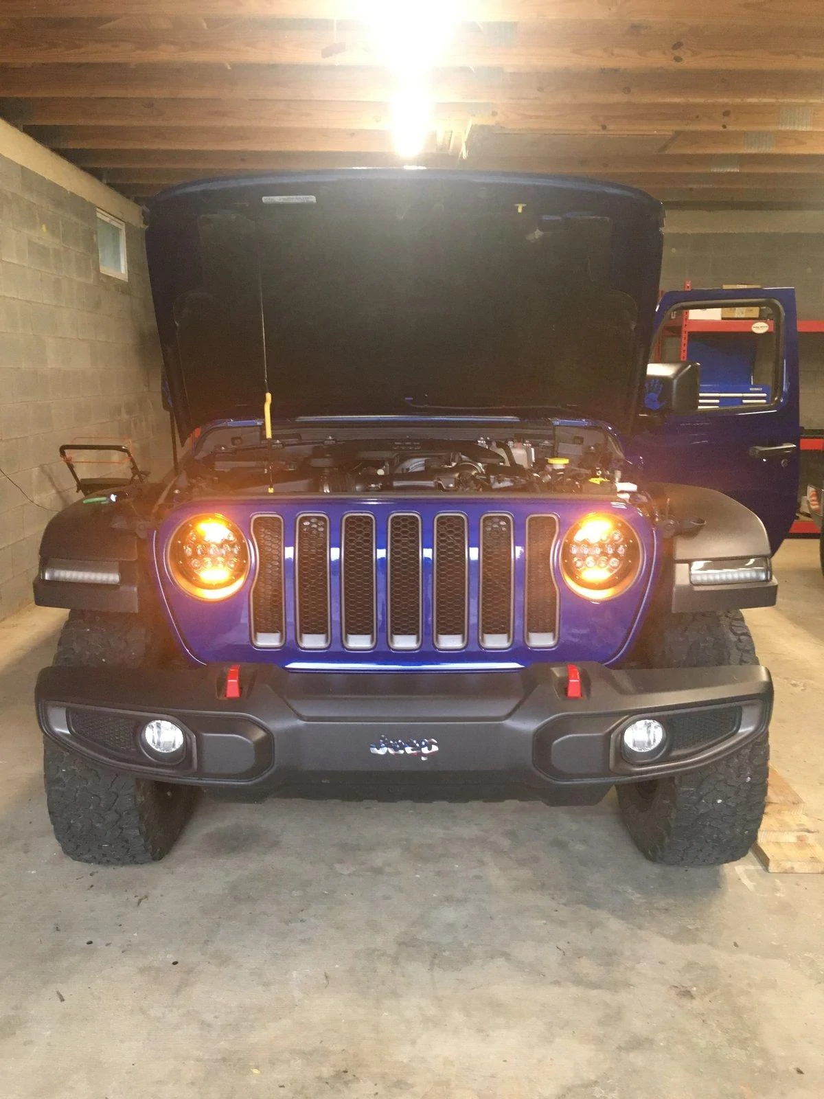

    I installed the Morimoto LED Directional and DRL into our
    Rubicon. The lights work as long as the engine is not running. Lights work properly when the switch is in the run position. If the engine is started the DRL works with the headlights on or off. The directional signs and emergency flashers work while the engine is running. However, if the directional and the DRL are both on while the engine is running the lights begin to flash an then turn off. Any suggestions would be helpful.
