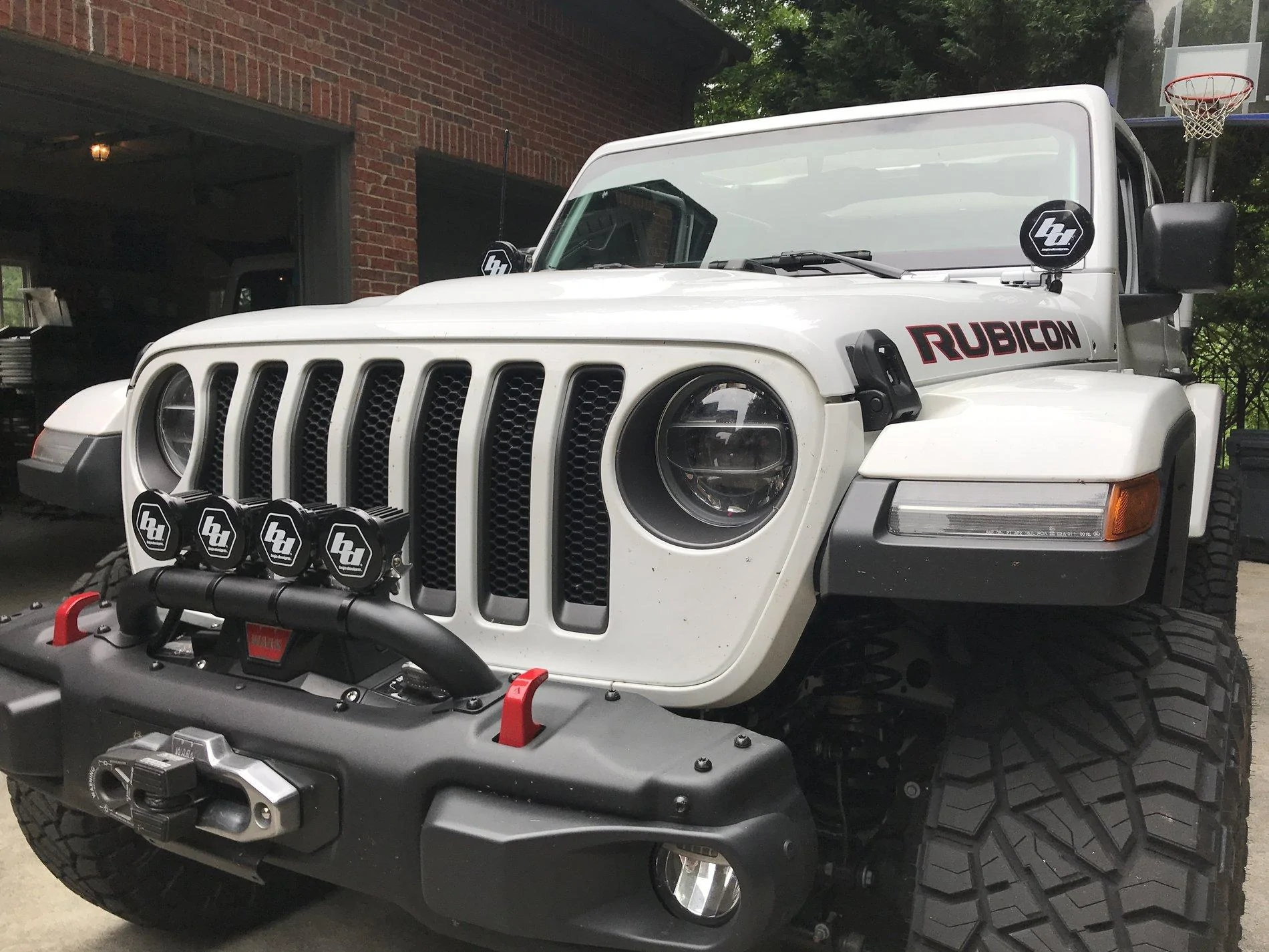

Has anyone found aftermarket light mounts for the Mopar Winch Guard?
Wanting to install 20" LED Light.
Thanks

Do you have the part numbers for the Winch plate and the winch guard?

Mopar Winch Guard# 77072349
Warn Winch Plate# 101255

What lights did you install?
On the winch guard are four Baja Designs Squadron-R LEDs. The inside two are Squadron-R Pros, with clear combo lenses. The outside two are Squadron-R Sports, with amber wide cornering lenses. The Sports are for road driving and, with the amber wide cornering lenses, can be left on when passing cars. The Pros would be way too bright for that purpose.
The cowl lights are XL-R Sports, with clear high speed spot lenses. I used the Baja Designs A-pillar mount. They shook a little, so I braced them with little 1" rubber bumpers purchased on Amazon. Since then, they have been rock solid.

I ordered the grill guard and it should be here Friday. Hopefully mine will fit as well as yours.
It should look similar. I used the Warn winch plate. Before ordering, I spoke to a guy at Warn about it. He told me that they designed their winch plate to rotate the Zeon slightly forward, to accommodate for the close distance between the back of the winch and the Jeep's grille. I don't know if that's different than what the other winch plate manufacturers did or not. I'd be surprised if you could notice the difference.
FYI... I just went with the Warn version because I figured they knew how to mount their winch, and it was around the same price as the others.

Is there a similar mount that works with the plastic bumpers on the Sport? I love the look but not necessarily interested in swapping bumpers to get it.
