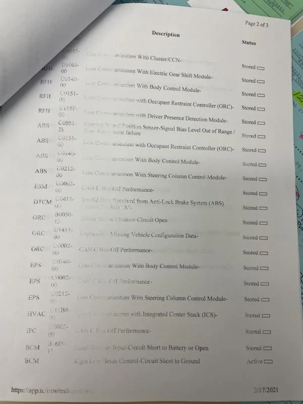

I took my Wrangler JL Sport in for service. I bought the Mopar LED kit and installed it, and wanted to take it in to get the system flashed to get them fully functional. Also had the electronic stability control message come up and I had some larger tires put on so I wanted them to adjust the speedometer. I wanted those three items resolved. Left the dealership with over a 1100.00 bill and only the headlights working the told me the speakers I had installed are causing the error codes(had the speakers installed by a reputable shop) and the electronic stability control message to come up. The stability control message came up prior to the install of the speakers. Am I crazy any advice on how to proceed? This is my first Jeep and it is by far my favorite vehicle I had ever owned. Any advice would be greatly appreciated. I have attached some pictures the dealership sent me.

I read the notes that tech left. Did you install an after market amplifier?

I encountered the same challenge when I took my 2020 JLU Rubicon with 7,000 miles in because I had the "Aux Switches not available battery charging" warning. The first thing I was told that I created an electrical problem because I replaced the small 3" upper dash speakers and the small 3" sound bar speakers. I used a wiring harness that plugged directly into the OEM harness and then to the speaker. No cutting of wires what so ever. They showed me where I had stored error codes for each speaker that was replaced and that created my problem. There is no way that created my problem and I told the service manager that my problem is a battery issue.
The reason I received an error code is because if a speaker is disconnected and then power is turned on, the "system" doesn't detect that a speaker is there, so it records a problem. I would turn on the vehicle each time I connected a speaker to ensure that it worked, so the "system" would not detect the missing speakers and record an error.
I bet the same thing has happened in your case.
I argued how insane they sounded and then I was asked when I was certified as Mopar Technician, I replied the same day you were certified to be an asshole. Needless to say it didn't work out well for me; at least not immediately.
In the end, when cooler heads prevailed, a different technician agreed with me and tested the battery. In my case, the battery was the problem.
