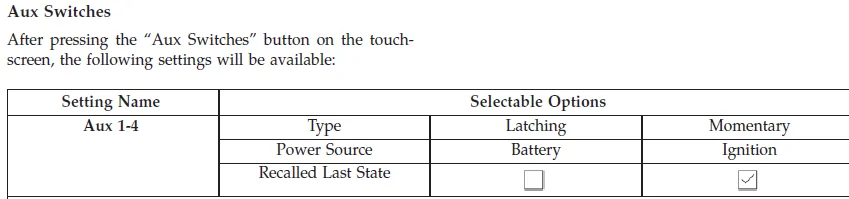

Have you tried to change the settings for that Aux switch from momentary to binding?

^ ^ ^ what he said ^ ^ ^
Check the Uconnect settings.... Customer Programmable Features; page 532 of the massive owner's manual.
