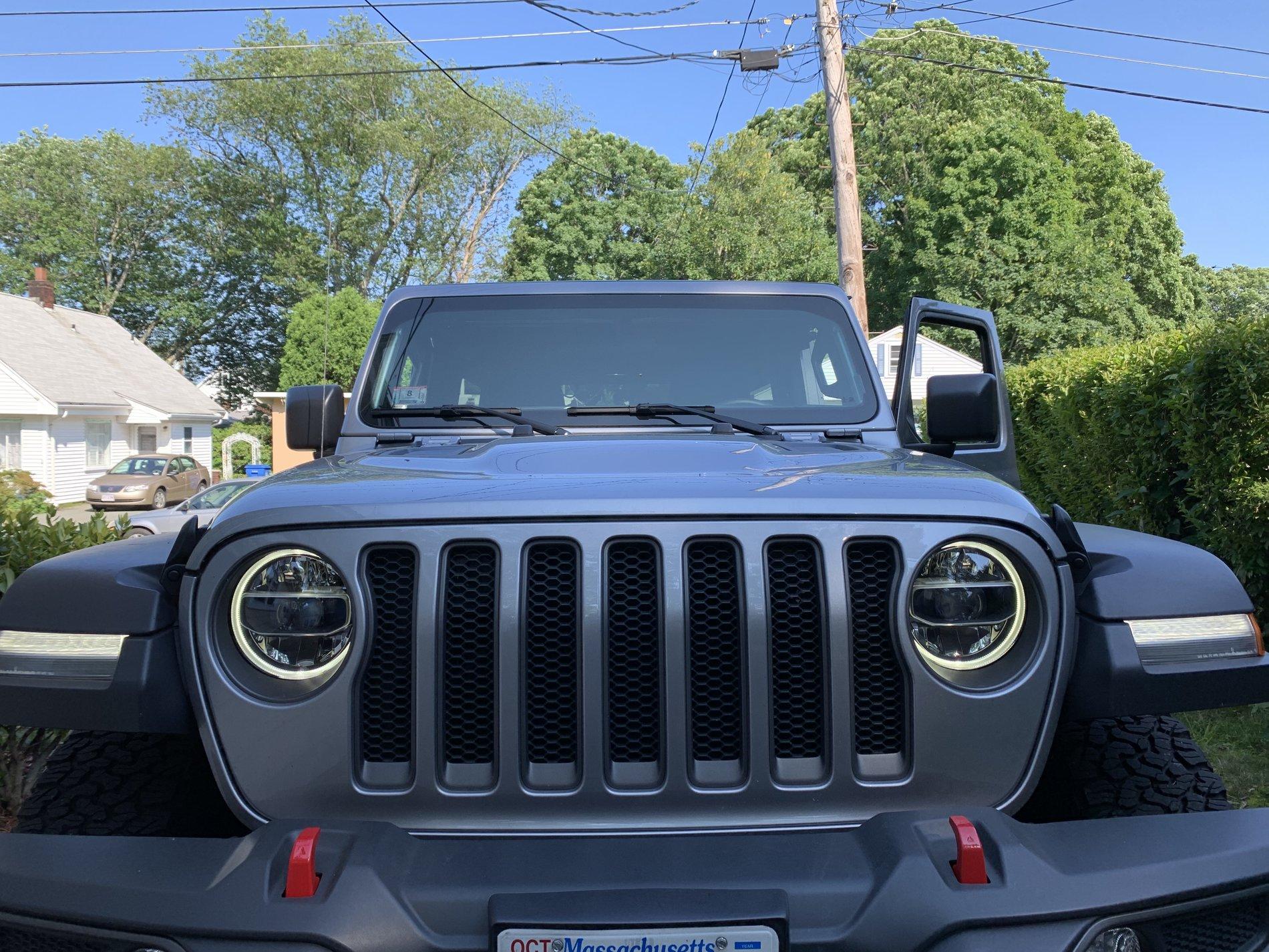

Ok I can confirm that tazer DO turn on the halo! I followed advice from @fonzie turning it on and off in the taser setup and after maybe 3 or 4 times the halo lit up completely and stayed on! Now i have no problems with low beam high beam and halo is lit always. Im rebooting now and following proper instructions and I will update if anything else comes up.

Did you just select halo on, and then off (repeat 3-4 times) on the tazer menu and not reboot between each selection? Or did you turn on/off once and then reboot and repeat each time until they powered on?
I just selected on and off without rebooting in between. It flicked on and then immediately off every time I was doing that and then the last time it stayed on. That's when I know it worked. I fully rebooted (reboot option with Tazer and 2 on and off cycles) and so far no error messages, everything worked fine.
