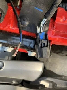

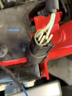

I'm currently installing the LED Headlight upgrades and I can't figure out how to remove this white plastic pin in the headlight connector plug. It needs to be removed so i can complete steps 24 and 25.
Edit: I figured it out, here is the solution i used.
How to remove pin from wiring connector?
