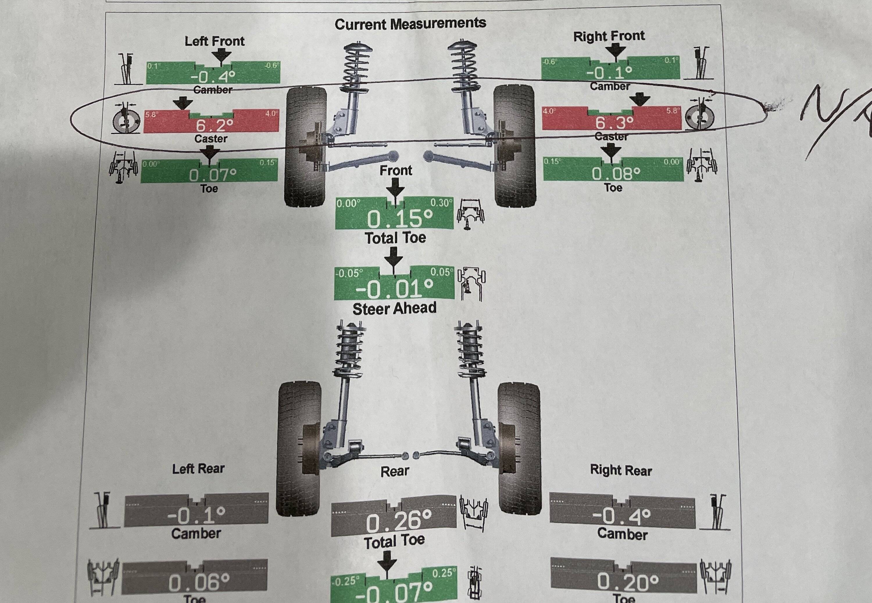

Got the LCAs in today and it definitely isn't as squirlly on the backroads. Do these readings look normal/ok? How big a deal is .4 difference from one side to the other? Should I take it back in?

Wouldn't worry about that at all, there's going to be variance. Glad you're happy w/ the drive, it's a great bang for the buck!

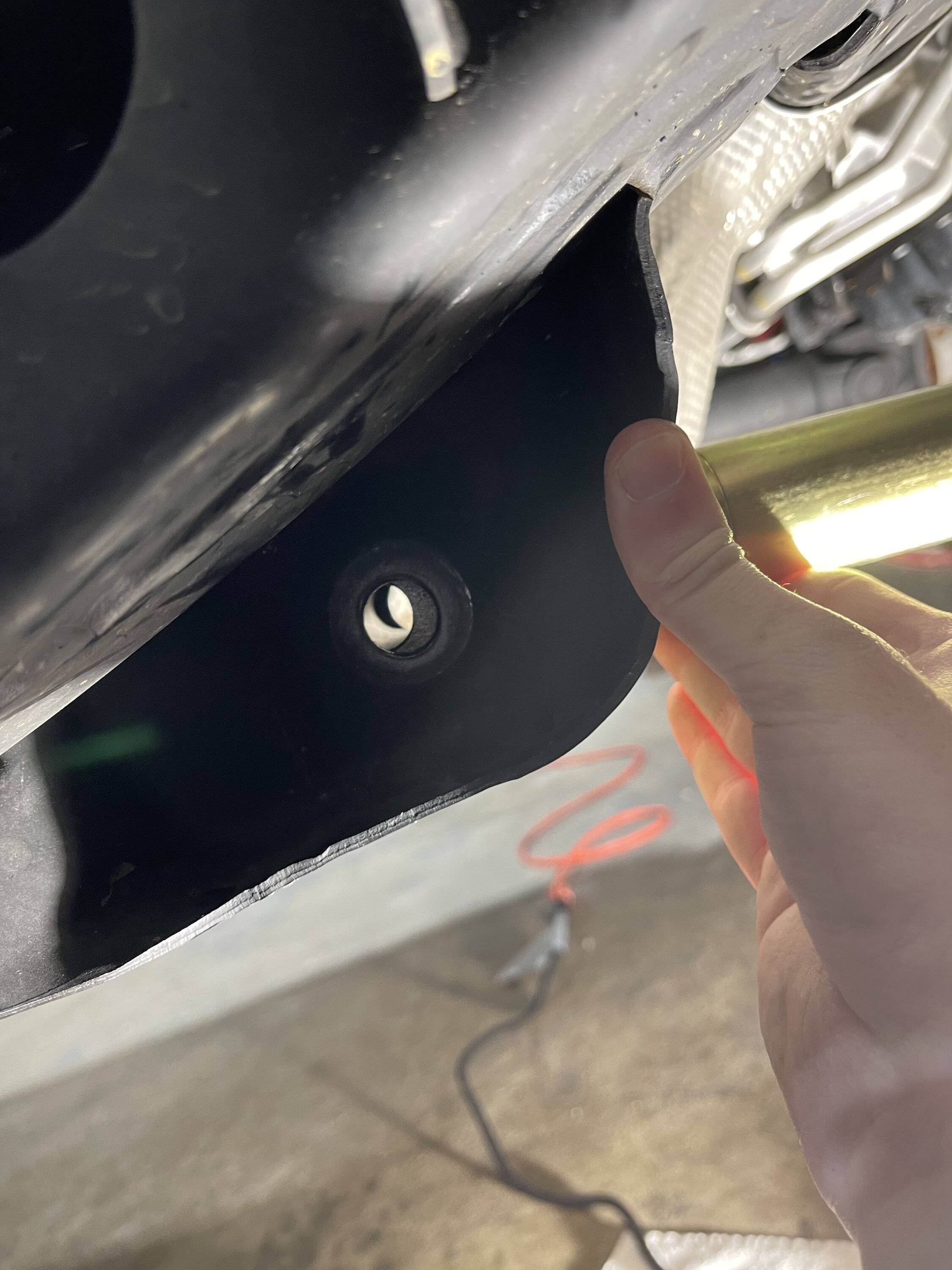

🤬 those are on there good. I could not for the life of me do this on the ground with no leverage. I’m going to get an impact wrench that I’ve been meaning to get anyway.
With an impact wrench, it looks like I can reach 2 of the 4 nuts. Using it on the bolt side of the other 2 going to be a problem? I know I’ll need more torque on a bolt compared to a nut.

I needed a 13/16 swivel head socket to get at my front passenger side bolt. Could not access the nut on that one because of the FAD. YMMV. My impact wrench supposedly delivers 1200 ft/lbs of breakaway torque. I didn't need it on the passenger side rear bolt, but I used it on the other 3.
I tried to loosen the bolt on the front passenger side with a 3ft cheater pipe on top of a 2ft breaker bar and could not get that one loose. Good luck with the swap, I am happy I did mine.
