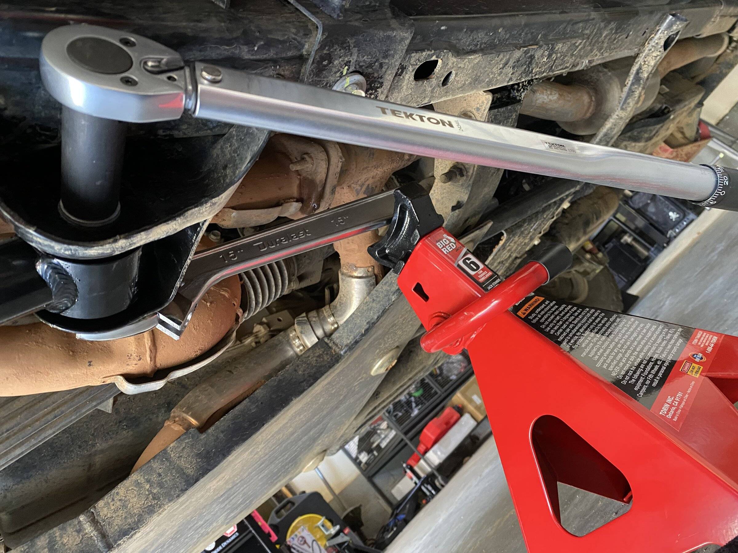

The only thing that’s difficult about this swap is the 190 lb/ft of torque you have to apply with the tires on terra firma. Not a ton of room to work the torque wrench so one little click at a time. Woof. Otherwise, it makes a great difference on the XR. Recommended.

There is a few ghetto ways to remove tight bolts like putting a floor jack under the wrench and jack up the wrench to loosen, and you can always use your foot on a torque wrench as long as you can feel or hear the click when it meets the torque setting :)
But you didn't hear it from me :)

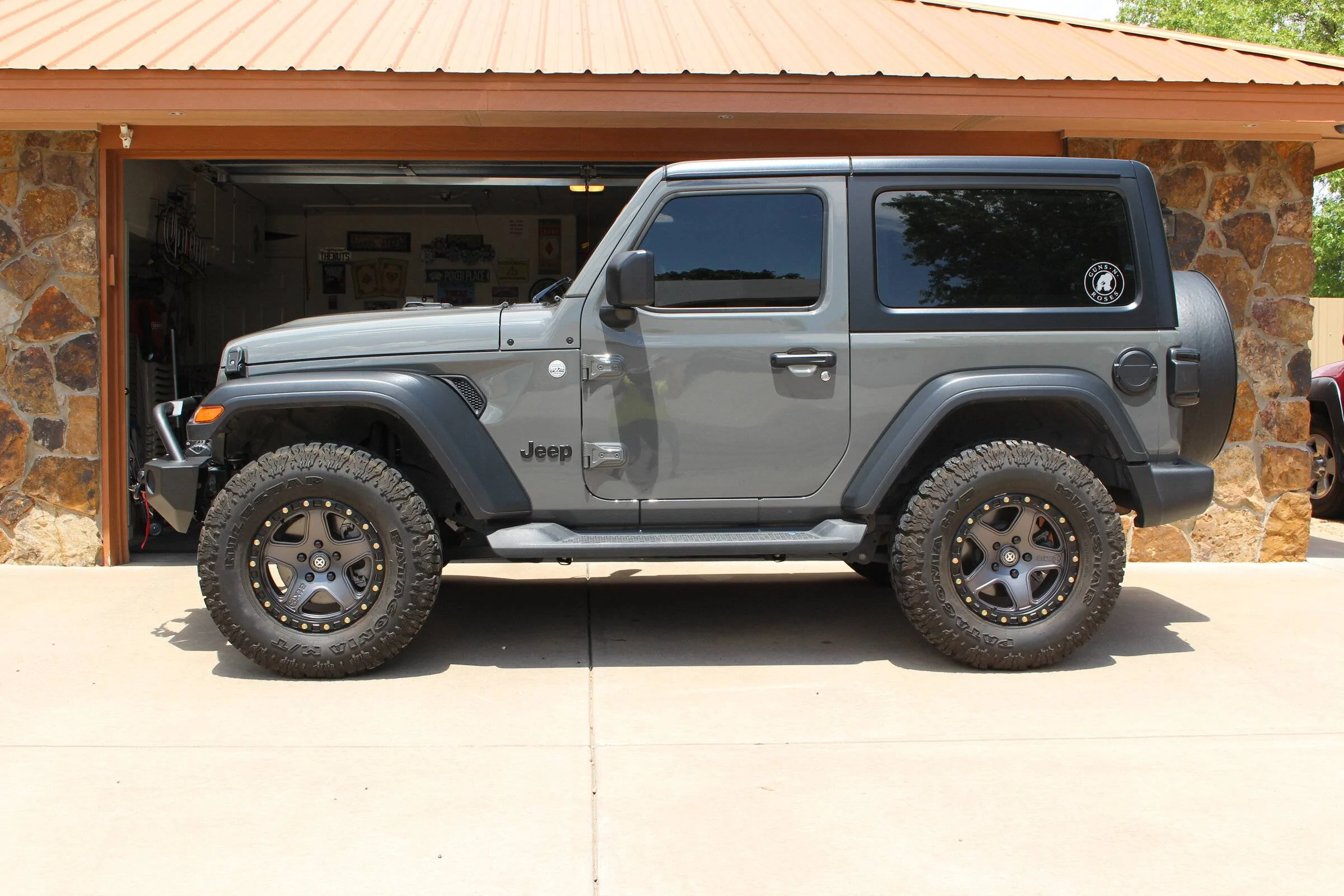

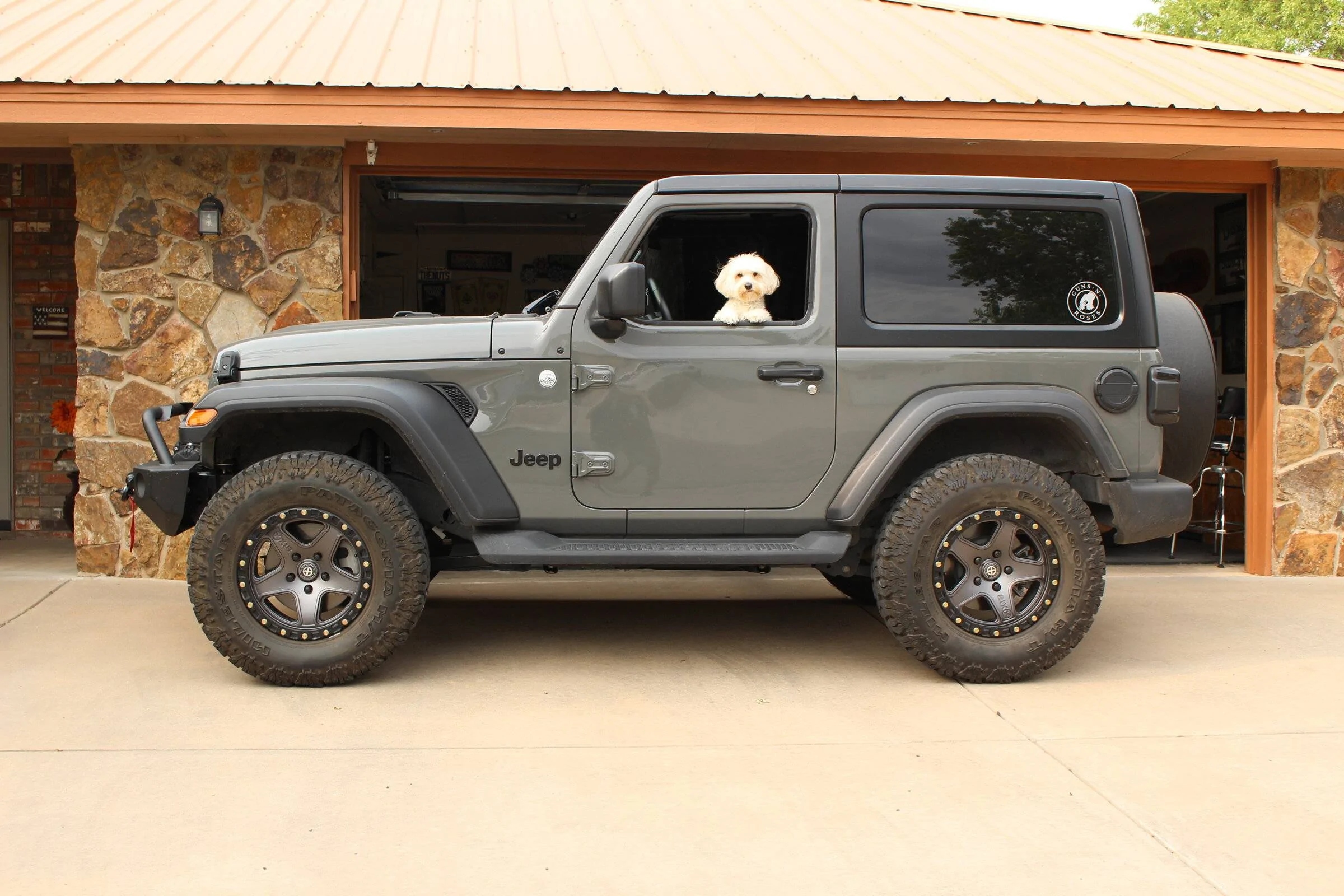

I put my steel front bumper, then my winch after installing my Rubicon springs (along w/ the longer LCAs), I dropped about a 1/2", I ended up putting in a Rugged Ridge 3/4" spacer up front and all is well in looks and the drive :) I can run down the hwy tracking straight at 80 mph w/ one finger on the wheel (as long as there's no wind, lol)
Here's a pic of the winch/bumper, then w/ the 3/4" spacer, not real noticeable but worked out great IMO.
Jeep Wrangler JL Mopar LCA swap IMG_0346
Jeep Wrangler JL Mopar LCA swap IMG_0386
