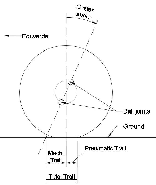

tire size does not change the relative position of the axle.
It won't change measured caster, but it should change effective caster, right? Since both ball joints are now farther from the driving surface, the effective "steer ahead" should be greater.
That’s not measurable, though true.
while I’m sure it can be calculated, an alignment shop will just stare at you and point at the machine.
What you're referring to is the 'mechanical trail'.
Increasing tire diameter should help, however an increased tire diameter usually also comes with other effects that make the increased mechanical trail negligible. I think a different pneumatic trail from different tire pressures or increased gyroscopic effect from the weight of the tire could have greater effects (and that's assuming you have the same tire make/model/load rating, and same wheel size/offset/weight). Also I believe wider and taller profile tires are more susceptible to tramlining anyway.
In short: Increasing tire diameter isn't a good way to make the steering better.
