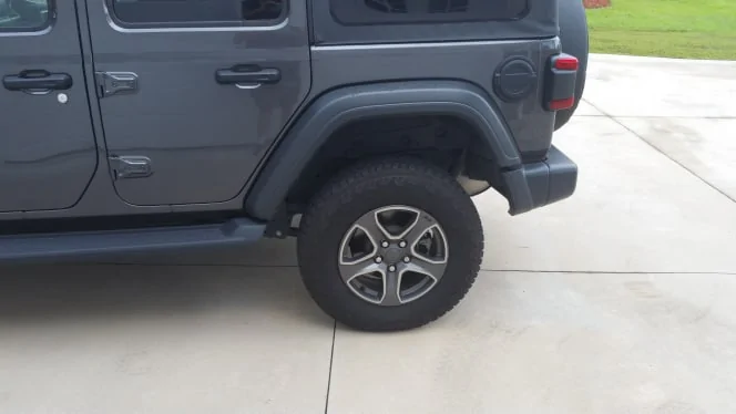

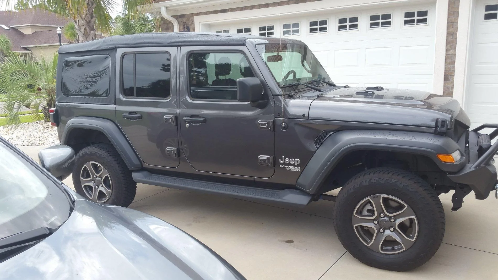

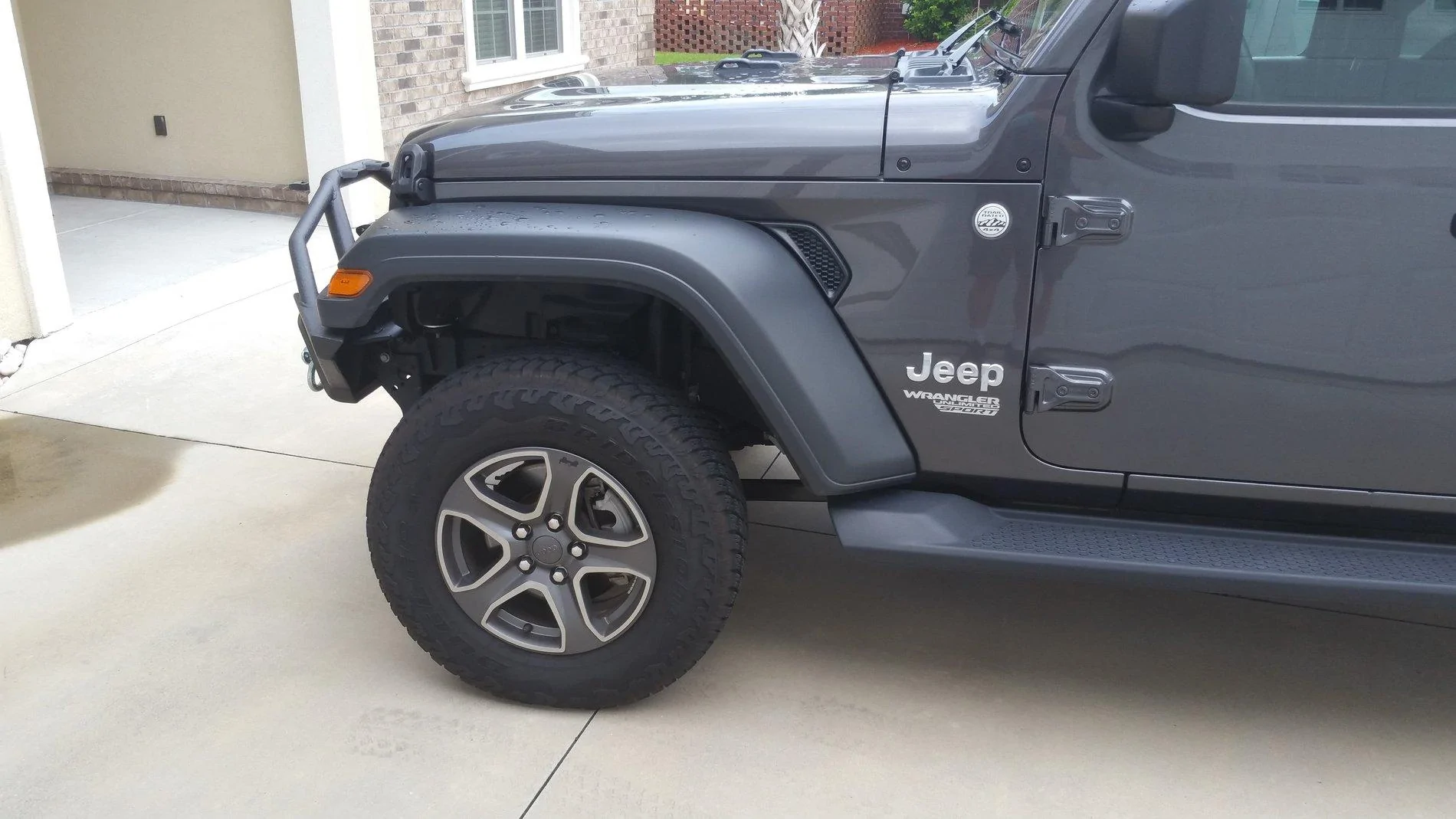

Just installed the Rubicon takeoffs springs and shocks on my 2018 JLU sport. The new rear springs numbers were 91 and 92 and the front springs were 61 and 62. Along with the springs and shocks I also installed the Mopar 2 inch lift lower control arms (82215398AB) and a Daystar 3/4 inch lift kit (DAYKJ09181BK) and cause of the problems with the track bar welds on the JL I also installed the Rusty’s front track bar mount brace (RC-TB7500-JL). Note: my jeep was not on the recall list but I installed the track bar mount due to I was under the jeep and with the spring removed it was easier to install. All the work took about 5 hours and when the work was completed I had the jeep realigned. With the new control arms the caster came in at 6. The Jeep tracks straight and steered very well. Here are the height numbers before and after the Rubicon parts install. Before Right front 37 1/8 Left front 37 1/8 Right rear 37 1/2 Left rear 37 5/8 After Right front 39 1/4 Left front 39 1/4 Right rear 39 1/4 Left rear 39 3/8 for about 2 inches of lift. If the Daystar 3/4 inch lift was not installed the lift would have been about 1 1/4 inches. The best thing my wife says the Jeep rides a lot better I think it is due to the shocks. This was a good way to go for a cheap lift using mostly Mopar parts. $200.00 for the Rubicon takeoffs, $50.00 Daystar 3/4 lift kit, $70.00 for lower control arms and $100 for the track bar mount for a total cost for parts of $425.00 plus $85.00 for alignment. If I did not added the track bar mount it would have cost $325.00 for a 2 inch lift. I have driven the Jeep about 2000 miles and very happy with the ride and handling. Next step is new tires and rims.
