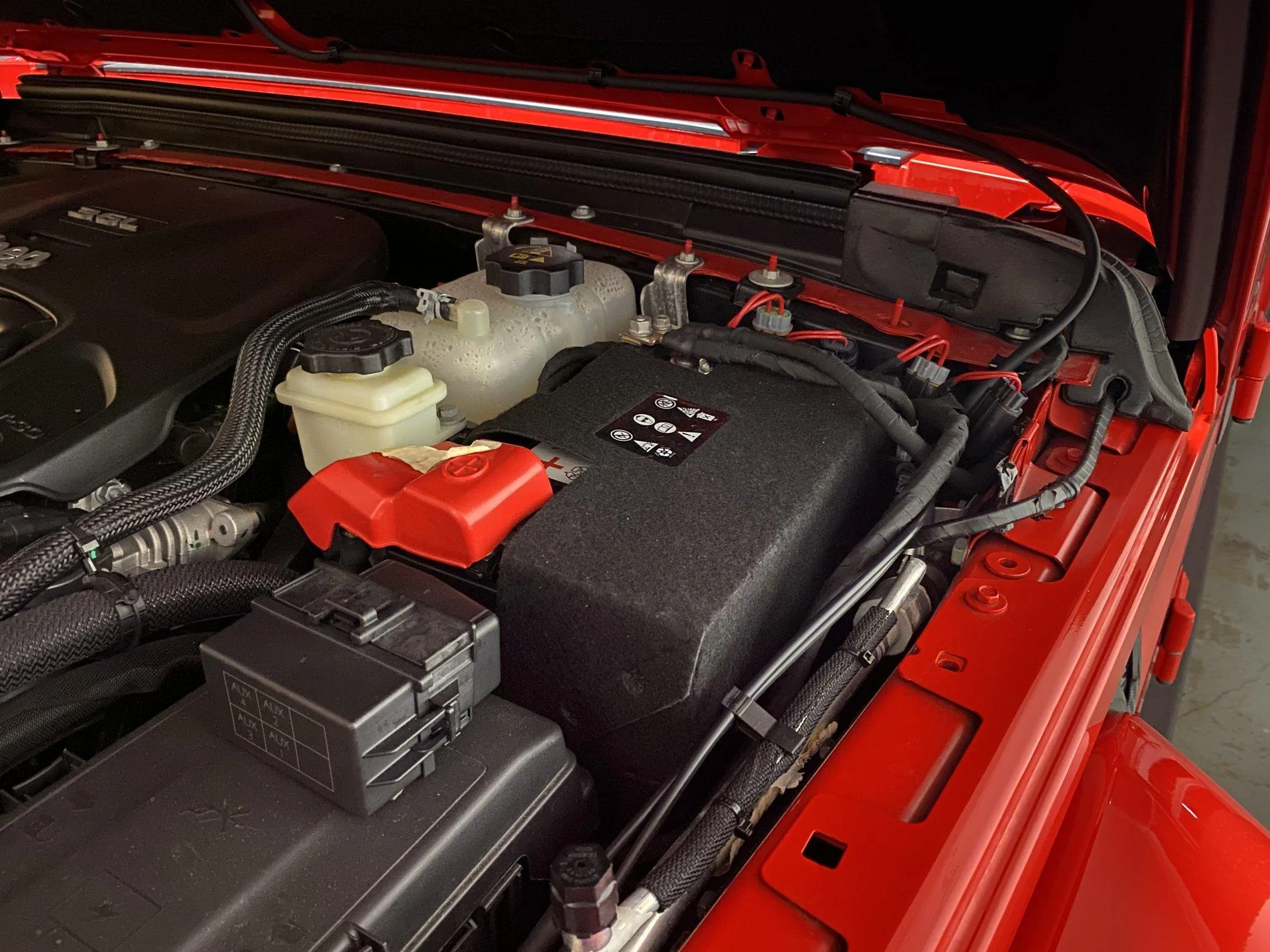

Apparently I forgot to order my jlur RHD with the auxiliary switches and have bought the mopar auxiliary switch bank. However I realise the position mounting for the PDC is for LHD models!
Any Bros out there who have installed the mopar auxiliary switch bank on their RHD JL and know where to mount the PDC?

Yeap I've seen the thread but need pictures on how to mount it inside the engine bay for RHD models. Haha but i'll be installing them soon and I see how I can route it :)

you can actually install it on the left side and wire the cables back 180 degree. it does look bit out of place, so I ended up relocation mine on top of fuse box, double sided tape. and tidied the wires behind the battery.
hope this helps.
